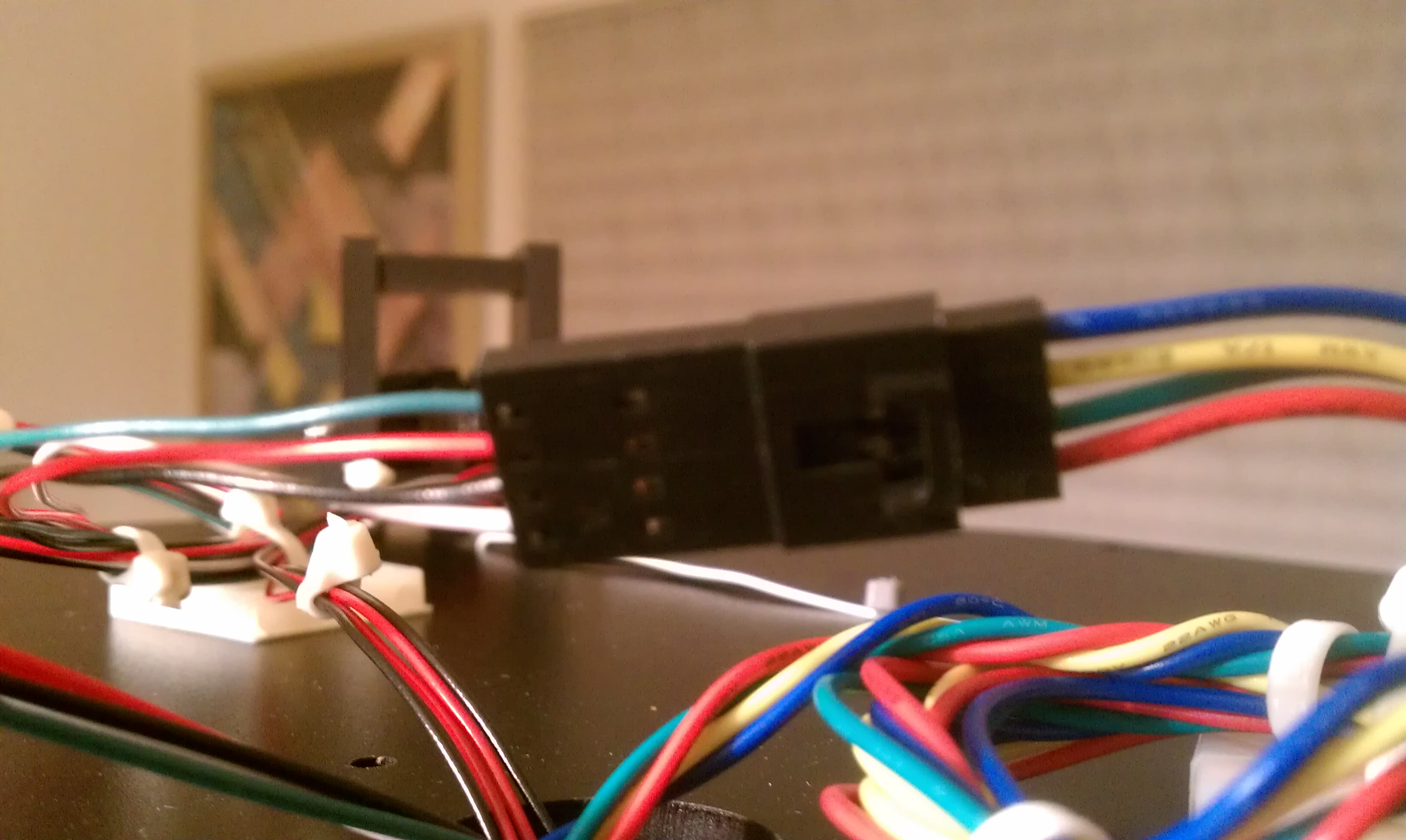

Hello People :D I have a slight problem and confused :?: ok here we go, on page 145 of the manual it gives u the color wiring chart... Then I went to Appendix A on page 263 and pin my own male connector on the EZstruder Extension cable coming from the "Y" tower... My Stepper motor is pin colors are 1. Blue 2.Yellow 3.Green 4.Red... Do I leave it alone or do I change my male connector to match this stepper color change??? Here is a pic.

I'll be updating the manual on this today - but until then:
Pin 1 - Red
Pin 2 - Green
Pin 3 - Yellow
Pin 4 - Blue
Sometimes SeeMeCNC uses a secondary motor source when their primary is late on deliveries. That's why the connector is different.
Pin 1 is identified by a little arrow on the connector shell.

Thanks Geneb!!!! I wasn't sure what to do, thats why i asked! I didn't mean to cause you more work LMAO!!!! Now I can continue my build! Thanks for your work and effort on the manual, So far has been a pleasure! :mrgreen:
