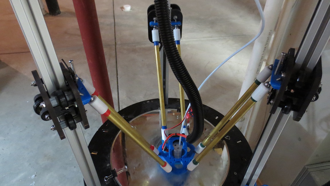

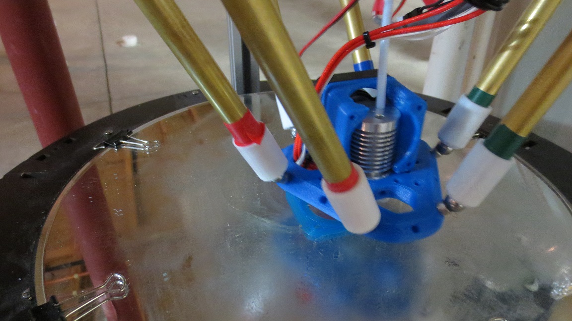

I actually never thought of the symmetry before. And I learned a new word today, trilateral! But from the beginning I wanted a compact design with more than enough capacity.
Here's what it looks like on the Rostock Max, along with magnetic ball arms with PTFE cups. In this one I'm only using one of the nozzles since it's a single material print; Get used to this look as you transition away from from cartesian styles. Your 3d printer can make it's own upgrades for a few dollars!
When you get your Orion, you'll probably get great prints from the start. SeeMeCNC designed excellent machines, and as far as print quality goes for basic parts, they're on par with the 10,000 + dollar Stratasys ones. Unfortunately you won't have a heated build chamber or support material extruder (unless you get another hotend), but the plastic parts will look very similar to the ones printed on the high end machines.

That looks really nice and compact, and the magnetic attachment seems very slick. Seems like it would make it easy to fuss with the hot end as well as provide a failsafe if things got out of control - it'll fall off instead of crunching the build plate?
Do you have just one Bowden tube running into it because you're just using one nozzle?
And, does that bracket need to be printed in nylon since it's holding the heat sink, or is PLA sufficient?

I print my stuff in trimmer line because it's cheap, strong, and doesn't get soft or melt until it's over 210 degrees C. When the fan is on, the entire heatsink stays cool to the touch. It would probably work with PLA, but without the fan it gets hot enough to soften PLA. ABS would work though. The fan mount is optional for nylon, the circular bracket is a drop in adapter to fit the hotend into the SeeMeCNC effector plate.
If you ever crash your machine from Gcode (running the moving parts out of build volume or into the surface) the magnetic arms pop off harmlessly. With the stock setup it is possible to break stuff, but unlikely because the NEMA 17 steppers only have a couple kilograms of force before they skip steps. The pictures are of only one heater block. I'll constantly testing new designs and nozzles so I switch them out a lot.
