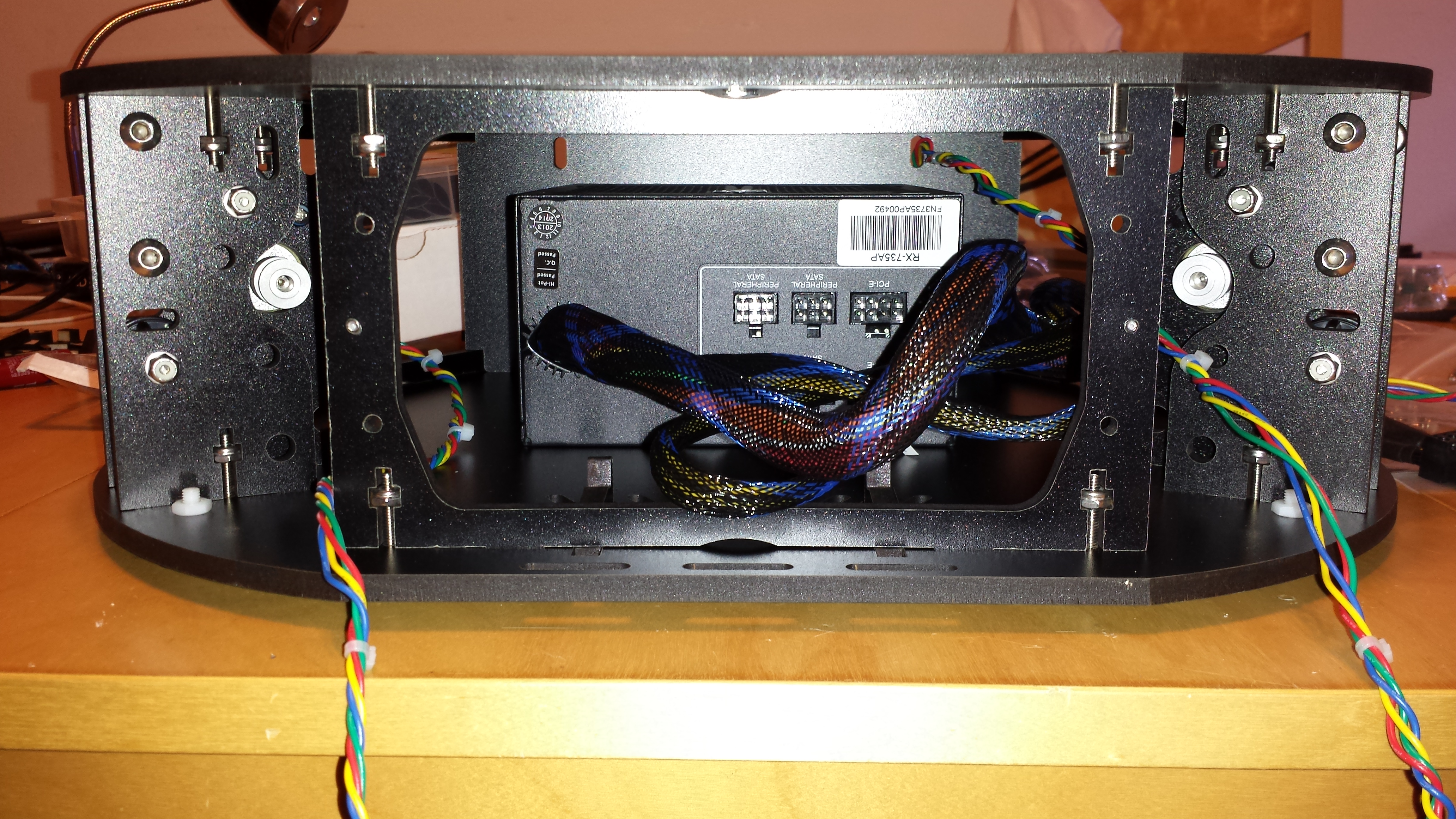

I worked hard to keep everything nice and neat inside (little did I know what the RAMBO had in store for my later) I used zipties and wax lacing cord ( SO WORTH IT! ) to try and keep it all tidy inside.
I thought I was doing so well at this point on keeping all nice and clean. Little did I know the mess of wires that would soon attack my nice clean spaces around the RAMBO.
It took some doing... But I managed to get all the wires through the middle and keep everything where it belongs. This was also my stopping point for night 1 with about 5ish hours put in so far I think.

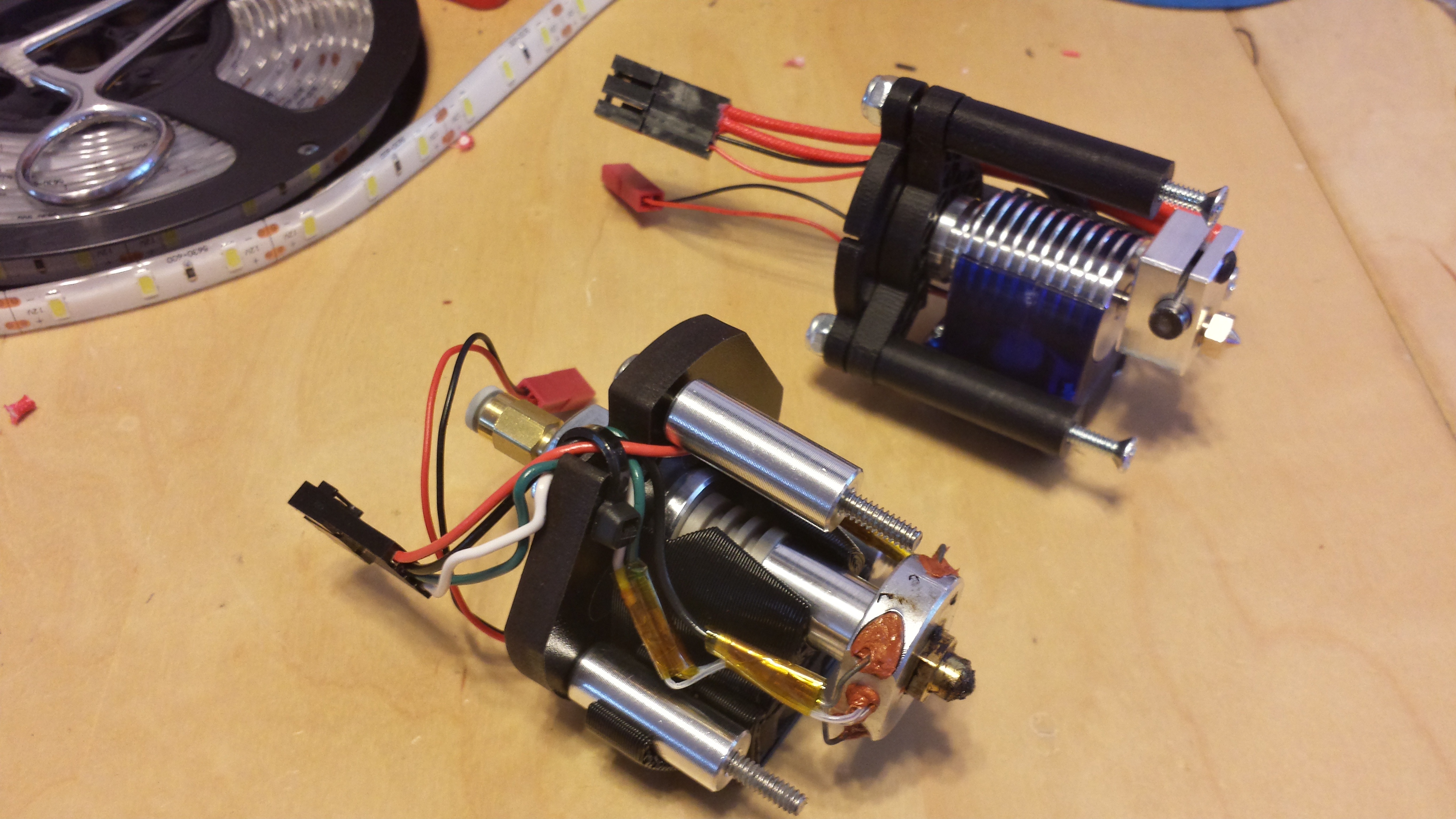

For the mount, Glenn from my local makerspace designed a mounting plate with integrated circuitry. http://makerhive.proboards.com/thread/1 ... otend-plug
They're not officially "on the market" yet, but they will be soon. He's working on a v2 that has thru-hole components and can be sold as a kit for the average solderer.
I don't have great pictures to feature it, but here are a couple to give you the general idea.

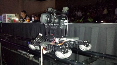

Right now I am waiting on a client to settle up on a large build I did for them of a remote camera dolly system and 20ft of black anodized aluminum trackway.
This was my last project and will pay for the CNC
Once that project is finished up I will be grabbing the CNC and putting it to work straight away!

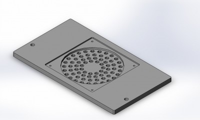

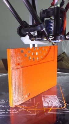

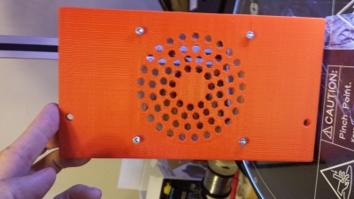

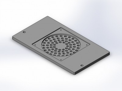

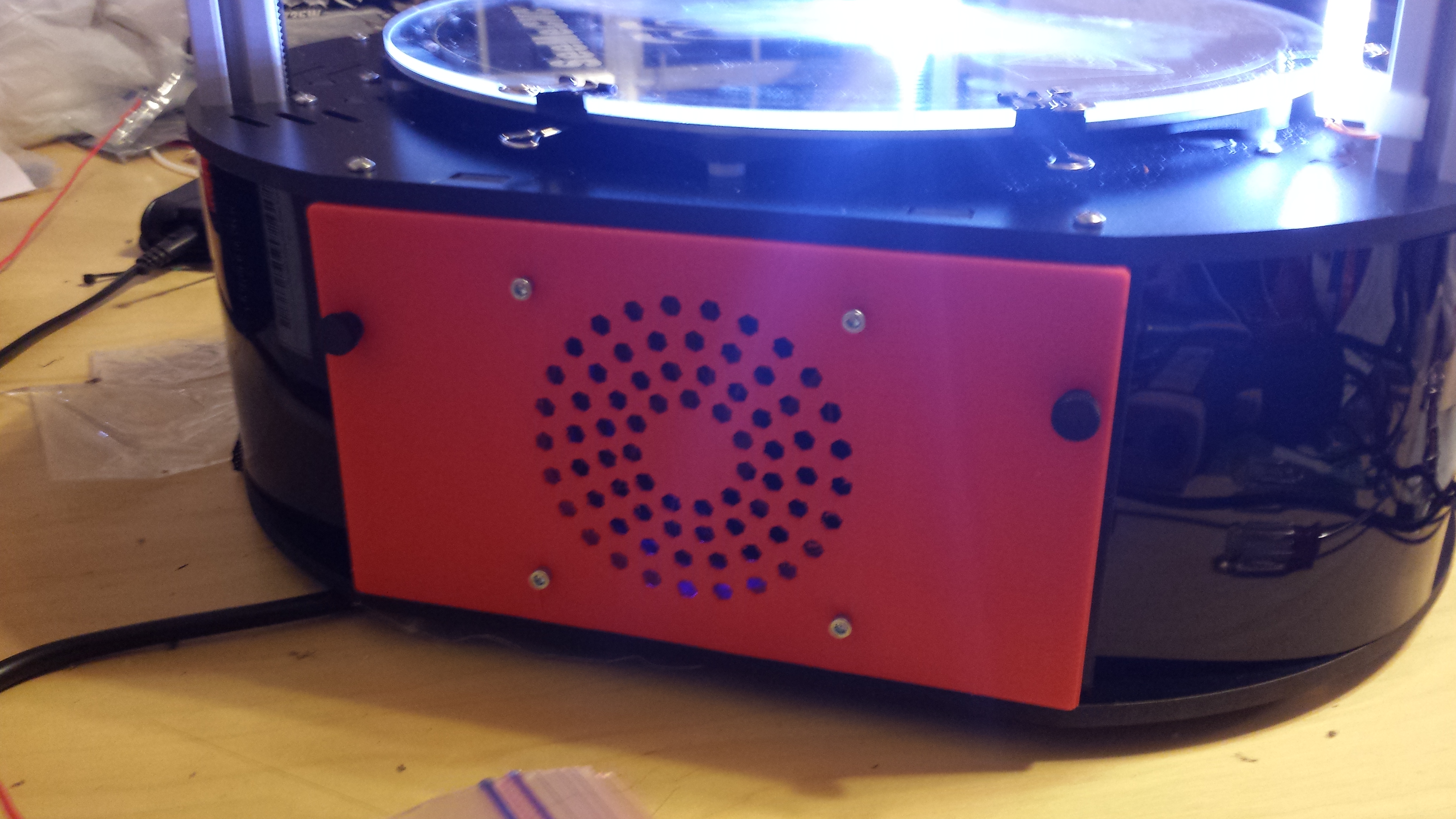

Tonight I am finishing working on a CAD design of the lower side panels to hold the new 90MM fans I picked up to cool the lower bay. Looking forward to printing those out tomorrow and mounting them along with the new RAMBO fan.

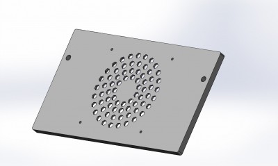

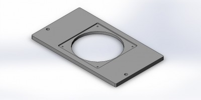

Knocked out the replacement side panel with fan mount in CAD tonight. Waiting for a 9 hour print to finish so I can give this a try and see if I can mount the new fans tomorrow night.

travelphotog wrote:
Would you be willing to share the STL for the side panels?
They would work great for additional cooling.

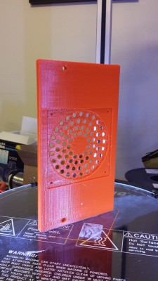

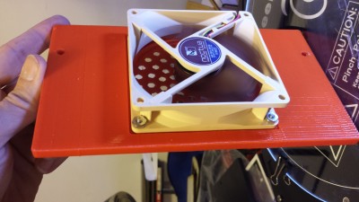

by travelphotog
I am test printing the panels today. Once I am sure they are good I will be very glad to release them without issue. I'm still a bit new at making STLs so I want to triple check my work before I give someone a file that could have an issue.
For the nylon I used the Purple Gluestick and it worked very well. I almost had an issue getting the solder holder base off the print glass. So I guess that is good.
As soon as I have the first panel printed I will throw the files up here. let me know if anyone wants another sized fan opening. Right now it is set for a 92mm fan wit 6-32 screw holes for the fan mount. Rest of the panel is stock Rostock size.
Re: Rostock Max V2 build with a few upgrades from the start.
Posted: Wed Aug 06, 2014 6:41 pm
by travelphotog
OK here are the files. I only have red PLA on hand and this is also my first ever print in PLA. But the panel looks great and everything lines up the way I wanted. This file is for adding 92mm fans in the Max V2 lower side panels. One file has the fan guard and one does not. I will post a few render images also so everyone know what it looks like. The fan mount screws are for a 6-32 screw.
This is my first print in PLA so be kind!  But here is the panel at about 47% or so.
Here are the files for the panel with a guard:
Front side
Front side
Back / Fan side
Back / Fan side
Max side Panel 92mm fan 1 CS GUARD R3F.STL
92mm fam panel with guard
(232.8 KiB) Downloaded 228 times
Here are the files for the one without a guard:
Fan side. Front side is plain.
Max side Panel 92mm fan 1 CS HOLE R3F.STL
Fan hole without a guard
(73.13 KiB) Downloaded 289 times
If anyone needs another size fan I could whip it up overnight or in a day or two.
Hope it helps someone out.

So my fan panel printed out great today. It was my first tall and thin print so I was excited to see it come out perfectly. I installed the fan at first pulling air into the base. I then noticed that my bed had a hard time getting to temp for nylon... I turned the fan around to pull air out of the base and the bed heated right up as before. Guessing the fan was blowing cold air up the hole in the middle of the base plate and cooling the bed too much. It is now pulling out nice warm air and keeping things nice and cool inside.
Nice print overall for a first ever PLA
Back side
Back side
Front side
Front side
All mounted. Thinking of doing other side in Nylon and trying a black die on it.
Tonight is the printout of the new LED holders... I did not like the ones I found so I redid them in Solidworks today and will print them out tonight while I work on the enclosure setup in CAD tonight. Also tomorrow the first LED idea for the print plate will arrive... My 5730 LEDs will arrive shortly so i will mbe knocking out the PCB ring for that this weekend I think. I think I have a thing for LEDs and lots of light where I work from being around my reef tank LEDs and being a photographer.. We tend to like light I guess.
Let me know if anyone needs a different size fan for panel, finds an issue or wants a tweak to the design. Always glad to help out where I can.

Those fan guard holes look much too small to allow free airflow. Unless you're running the fan at low voltage to slow it way down, you might want to make them larger, or switch to a lattice pattern. Otherwise you're likely to get more air noise and less airflow than you'd like.
Dan
Posted: Thu Aug 07, 2014 9:56 am
by Eaglezsoar
After looking at it mounted I have to agree with Dan, the holes are too small. The lattice would probably work best to have more open area rather than solid plastic.
The idea is to open it up as much as possible yet a small amount of lattice only to protect from youngsters from sticking their fingers in.
Posted: Thu Aug 07, 2014 10:56 am
by travelphotog
Yeah after seeing it in person I also can see that the holes might be a bit small. It is moving a good bit of air but I can see that larger holes or long slots would give more flow. Also working on an intake for the other side which is a little more low key. If it pans out I will post it for you guys to look at. I should have the new panel up by lunch time in Texas.

So when the hot end decided to flake out on me I decided to go ahead and re-calibrate the whole thing and this time try to do it right.
So this is my new BEST friend! I printed up the mount with the stock hotend in ABS and got to work.
All four spots were within a HAIR of of this so I called it good. When I first threw the dial on it was not fun seeing how far off the "paper method" had me. Which was my own fault I know.
