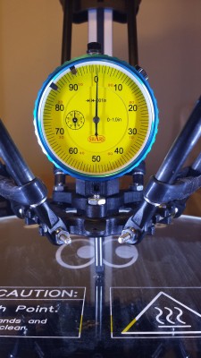

Hi Travelphotog!
I've been absent on the forums for a bit, as the summer is when I'm out traveling solid for work.
I just saw this post tonight and I was curious what specifically you are using your dial indicator for to calibrate the max?
Is it mostly for getting the bed level? Also, how are you mounting it to your max?
-Daniel

Just got the exact same dial in the mail. I had seen the part it's mounted on and printed it but I broke it while removing support. Can you show what the dial looks like on the machine while "in use"?

Here is how it looks in use

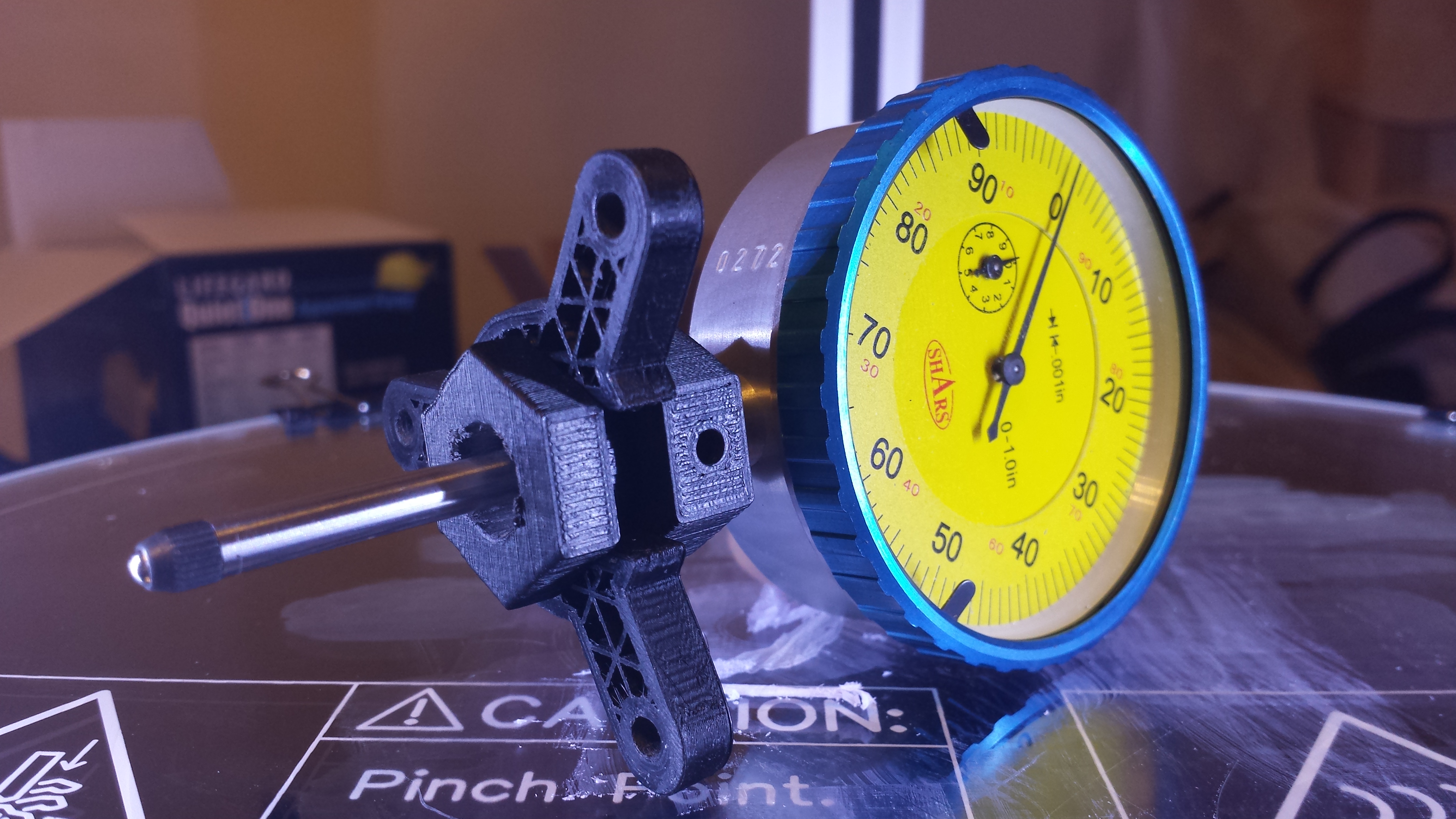

this is a shot of just the two mounts on the Dial. The Dial slides into the small mount which is held on by the Slot mount

dial indicator holder e3d mount R3 flats.STL
This holds the Dial in the slot mount. It is tight and might need a file but should not need the screw, though a hole is there if desired. I printed laying down on one fo the flat sides and it worked fine without supports.
(46.08 KiB) Downloaded 299 times
E3DV6_Mount_01.stl
I used this slot mount with some #6 screws. It is the same mount I use for my E3d V6.
