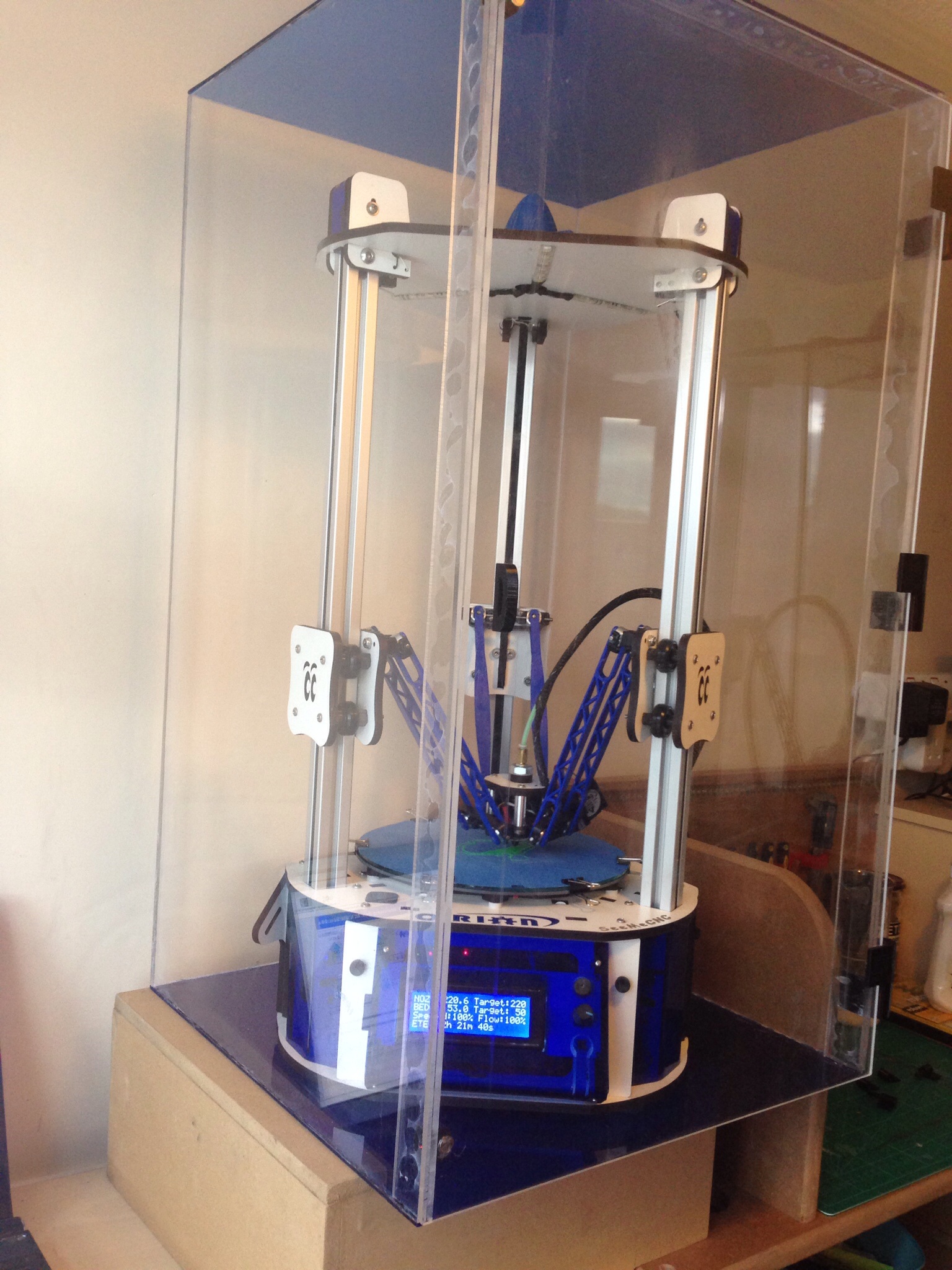

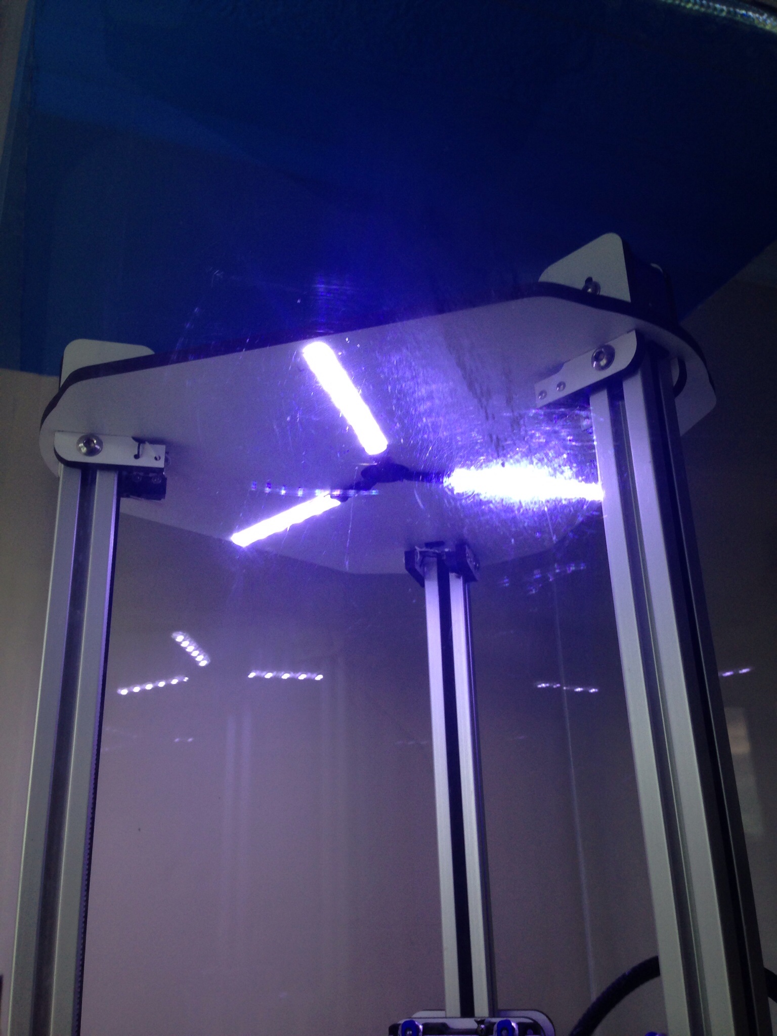

This is my printer! I've had It for around 4 months and have pretty much modelled the room around it! This is my first 3D printer so I didn't want to go down the kit route at the time but now I feel confident I could.
I have recently made an plexiglass box to go round the printer. I made this for a few reasons.
1. Fumes, I print ABS and Nylon 6 which both give off nasty fumes that I'd rather not be breathing in.
2. Noise, it's amazing how much noise insulation a 5mm thick piece of plastic gives.
3. Chamber heating, I've found I get better ABS and nylon prints because the air around the print is warm. On a decent day the chamber can reach around 37°Ish (100°F). The circuitry has cold air being pulled in from the bottom, chill out.
The box is held together with this stuff. It's unbelievably strong and only goes off once sprayed with activator. Not sure if you have an equivalent in the US.

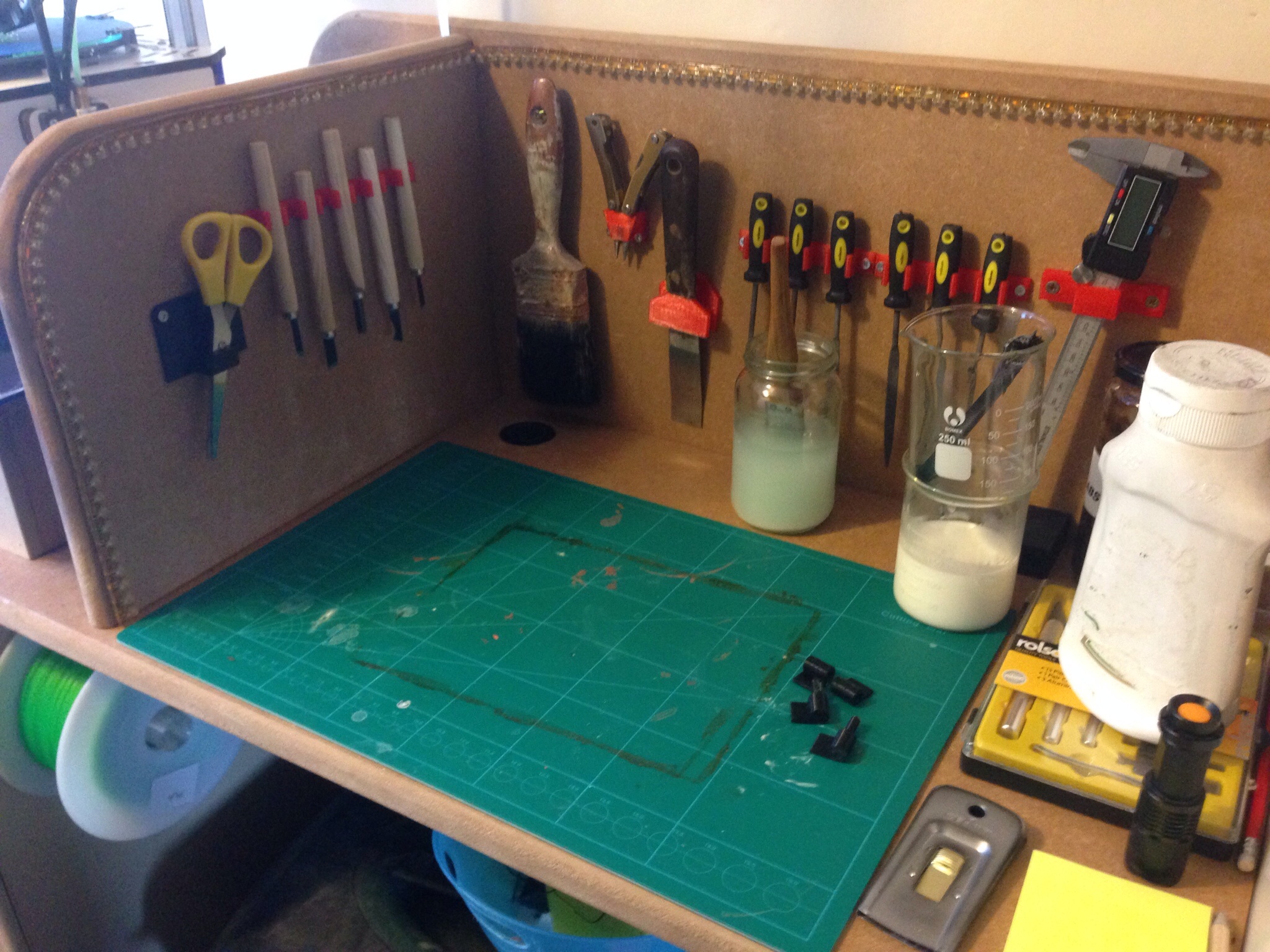

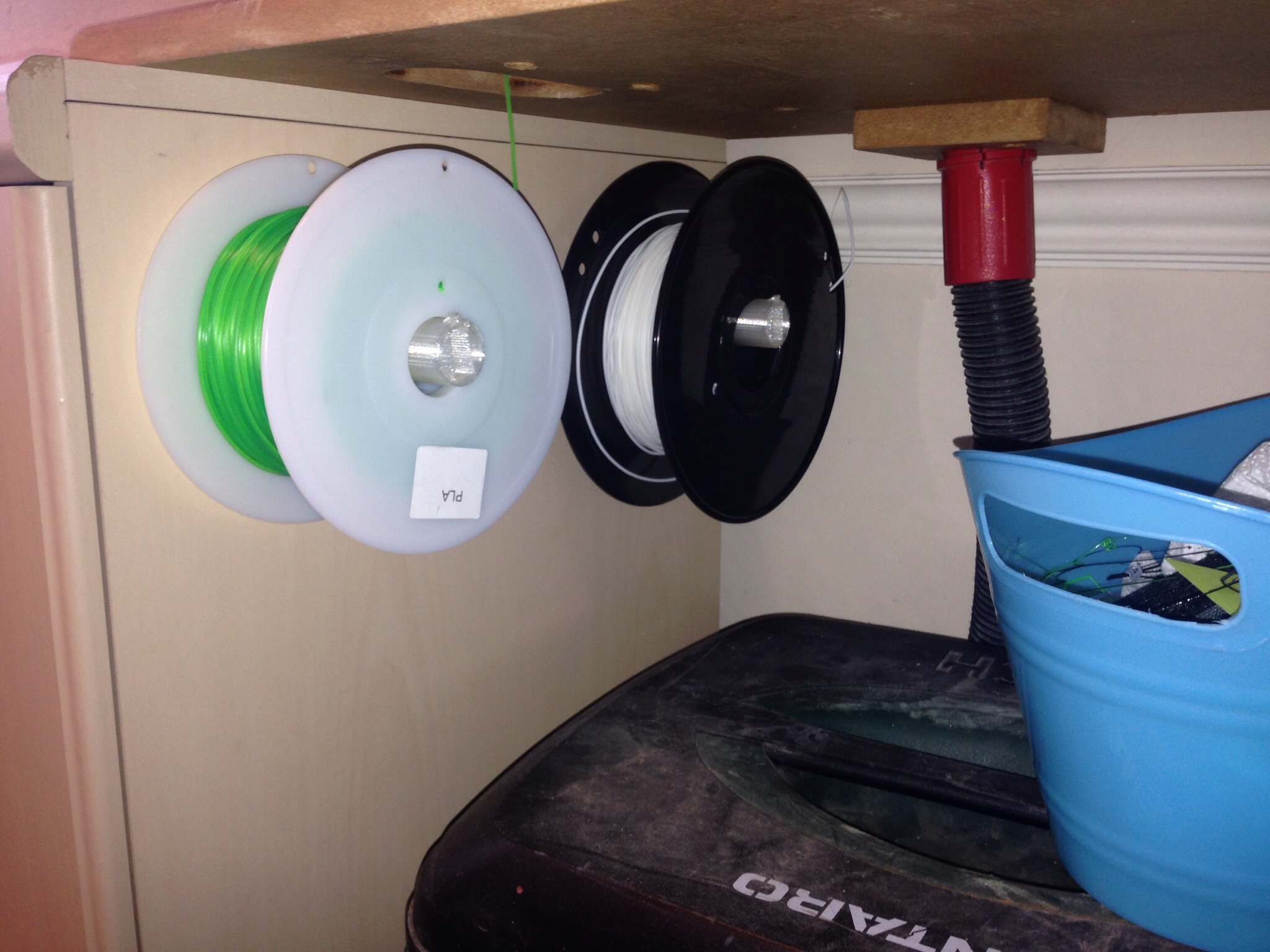

The filament spools from a holder under the "finishing platform" as I like to call it. It then passes through the wood, then acrylic up into the EZStruder. Works really well. I have another spool down there because I can.. Maybe hopes for a dual extrudes mod!
The finishing bench itself is an absolute lifesaver. Having no garage makes finishing prints with a lot of support a messy job but now having a table with a vacuum built in is big plus (hole in the top left).
The printer is lit up with some LED strips at the top of the printer and the work bench is lit by one long LED strip. I need good lighting for any time-lapses I'm doing over night which I post to my YouTube channel http://youtu.be/BrpLPVtNaY4
Finally the only real modification to the printer it's self is that I upgraded the heating resistors (which both failed at around the 20 day mark) with one 40W heater cartridge. It works a treat.
Hope you like my setup and would be glad to hear your feedback! :D

I like the leds around the work area, a cool idea.
You whole printer area looks great. Excellent job!

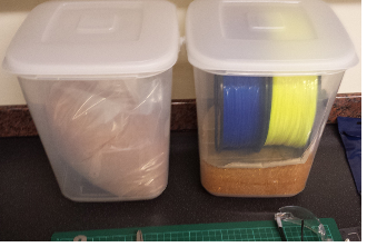

teoman wrote:You could als build an enclosure/ dehumidifying chamber for your filament.
Funny you should mention that!
I've just finished making a airtight box for some of my spools that also has airtight valves that let filament spool without it ever leaving the box.
Take a look:
The valves if you haven't already guessed are off bottles of condiments. They have a pretty neat pig valve that lets 1.7 filament through.
I've had trouble printing some nylon and that was partly due to the moisture in it. I was reading that curing it in the oven for 10 hours works but frankly I don't want to have an oven on for that long due to gas prices and fire hazard. So I went and got a fruit dehydrator (used to dry fruits) and from the feel of the filament it looks like it's worked quite well.
Link to the dryer:
http://www.amazon.co.uk/Electric-Dehydr ... dehydrator

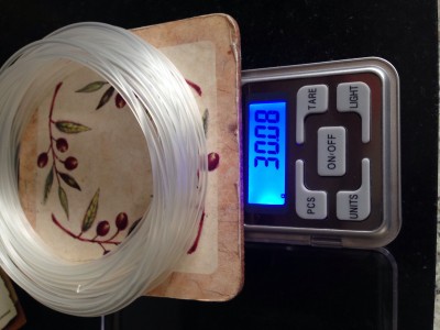

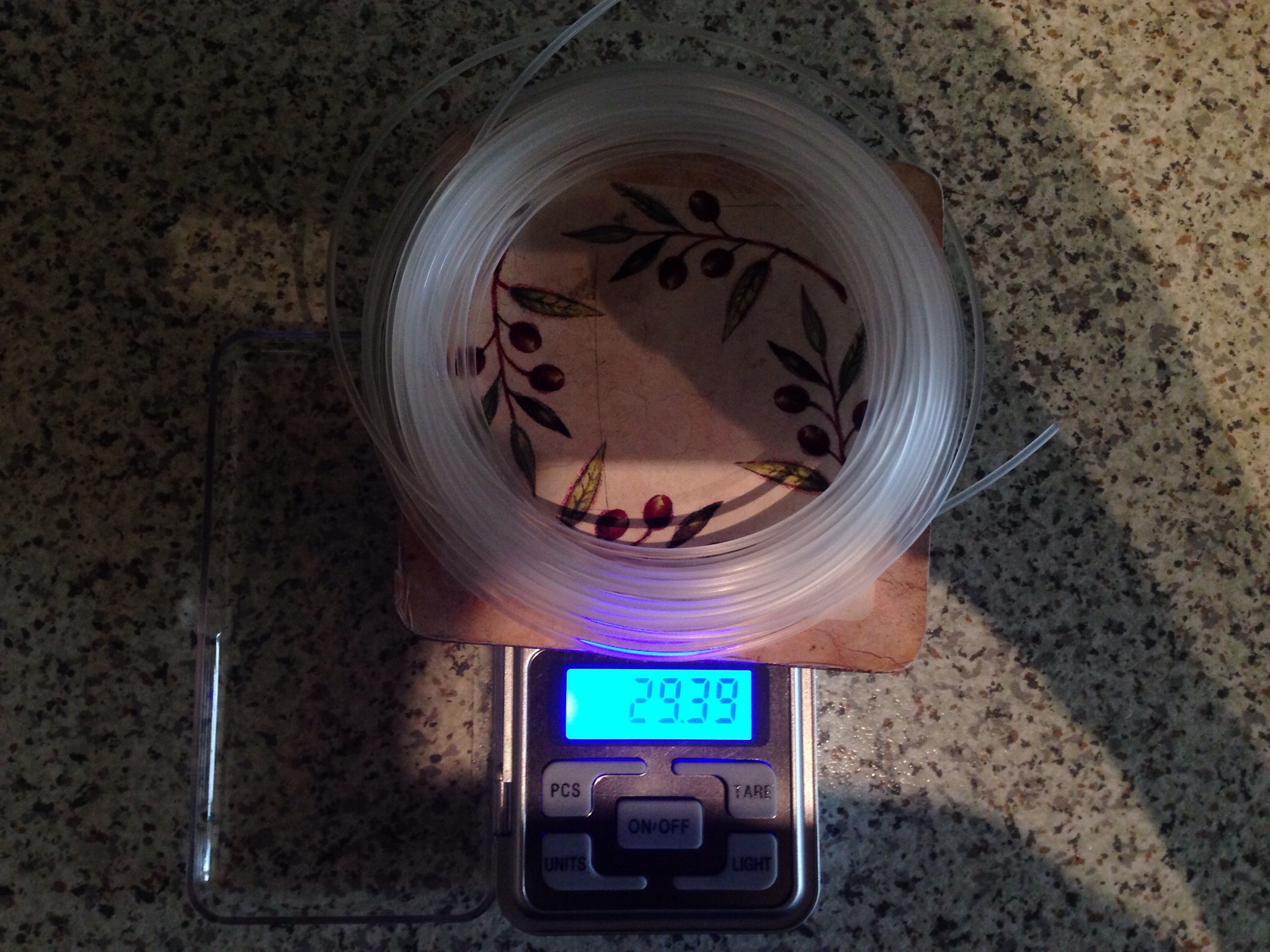

Unfortunately I didn't weigh the spool of nylon before drying. But I did have a 10 meter sample of Taulman Bridge nylon so I thought I'd give that a try. Bridge nylon doesn't absorb anyway near as much moisture as nylon 6 which is what I normally use and it was brand new out of the bag. I dried it for around 5 hours at 65°c.
Before
Before
After
After
So you can see even with Taulman Bridge nylon there's a fair bit of moisture lost and remember that's only 10 meters and it's brand new.

by RocketMagnet
Looks like you have a small bag of desiccant in there but seems small for your container volume especially considering it's not 100% sealed.
I'd recommend filling the base with a few inches of no dust (low friability) indicating silica gel like this
http://www.amazon.com/Quart-Indicating- ... B00BXK8E7M
It's easy to regenerate in the oven, you can see when it's water saturated so when to regenerate and cheap to boot.
% Loss on drying is pretty simple and is done to constant weight. Never heard of LOD being performed at such low Deg C so presume it's over many many days
to attain constant weight.
Nor sure how effective drying on the reel will be as you've got lots of unexposed surface. Personally I'd just long term store the stuff somewhere warm in a desiccator.
Not got a printer yet (considering the Orion Delta) so have not experienced how moisture content affects the print.. can you compensate with temp or is it generating tiny bubbles in the plastic as it's extruded that's the problem?
At a guess variability of the plastic density & diameter will be key as I'd presume it's simply stable mass flow rate to a stable temp heated nozzle that's the main factors?

RocketMagnet wrote:Looks like you have a small bag of desiccant in there but seems small for your container volume especially considering it's not 100% sealed.
you can't really see from the photo but there's loads of Desiccant packets in the bottom (almost covering the bottom now) but I'll defiantly have a look for some of that blue stuff in the UK.

by RocketMagnet
I'm UK also and got Indicating Silica Gel from Ebay this week. It's Orange (Dry) to - Green (wet) to - Blue (Totally saturated with water). Easy to regenerate in a low oven and it turns back orange.
http://www.ebay.co.uk/itm/380404031306? ... EBIDX%3AIT
I got 5Kg and it came next day. It's also the "glass bead" type so no dust but I've still got a bit of card for the rolls to sit on.. will sort a mesh stand out sometime though. May even plagiarise your idea and make a septum with cling film / bottle top and a roller holder to feed direct from a tub... really cheap from Morrisons, think they were £2- £3 each.
Got enough to long term store a fair few rolls of filament, I'll even it out over about 5 containers so ~1kg per container. 1kg is a fair bit per container but I doubt i'll need to regen it very often then.. ;)
