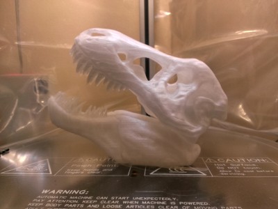

So I was inspired by Mike B to print the T-Rex skull when I saw his avatar. I was blown away when this print finished. This may be my cleanest print yet.
So, how many of you think I should attempt a cold acetone vapor finish following McSlappy's youtube tutorial here?
Or should I just leave it the way it is since it has that cool Crystal Skull look to it?

Hey guys! My bed was set to 90C and the hotend to 225C and the files were sliced using Cura and these settings
JasonCura.ini
Cura settings for ABS prints
(10.61 KiB) Downloaded 467 times
I printed it exactly as the stl loads from the Makerbot Academy model on thingiverse here
But here's my Gcode for the top and bottom of the skull, and here's the pic of the finished skull that came off the bed last night!

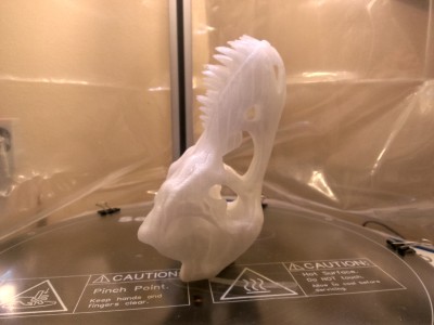

I didn't print any supports for either of the two pieces, I just made sure my printer was calibrated nice and low to my bed, sprayed the glass with "Aussie Mega Hair Spray", and away the prints went!
This is how I printed the upper skull, no supports :)

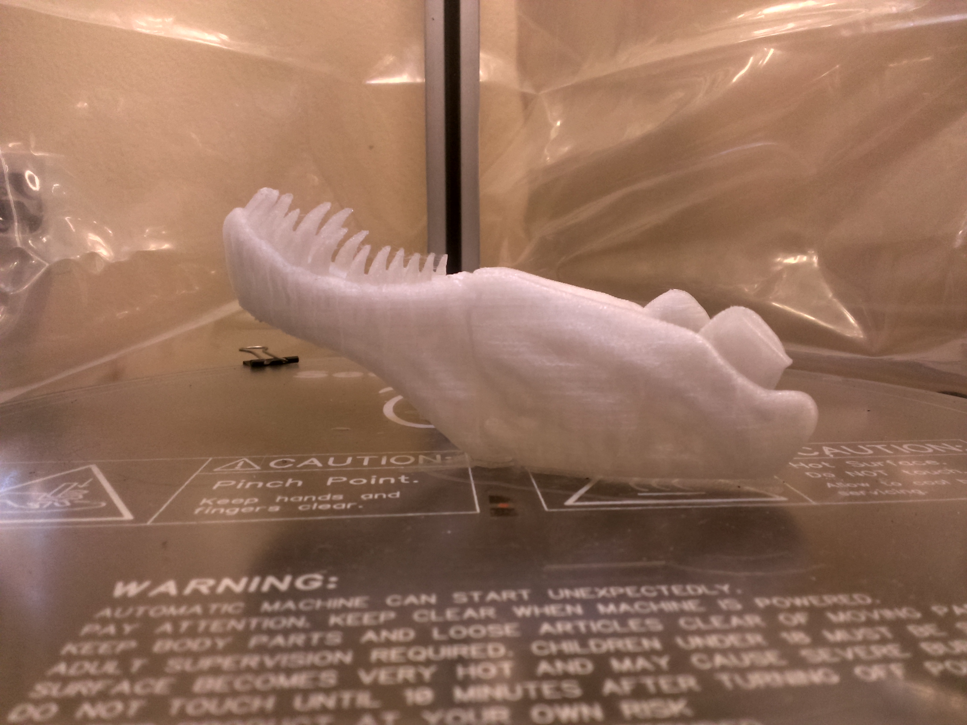

This is the way I printed the lower, also no supports.  I did slow the speed down to about 69% near the area that the jaws were beginning to connect.  The ABS was wanting to warp.
And here's the finished skull!! @_@ look at it
One crucial factor, or at least I believe it to be, is the shower curtain enclosure I made. It keeps the chamber just warm enough that it keeps warping from happening on my longer ABS prints, so I can print nice and slow to get the quality needed in this skull.

I know you printed the upper skull in the position shown in the picture but it sure looks like it would fall over.
Any tips on how to keep it from falling? I use hairspray but the base attached to the glass looks so small.

Yeah, Eagle, I have no real clue as to how it managed NOT to fall over, but apparently the guys and gals at the Makerbot Academy designed it specifically with this print orientation in mind.
I would say try calibrating your nozzle height just a smidgen lower than usual to get a nice solid stick on the first layer with the hairspray on the bed.

No problem guys! If it doesn't work the first time, I'd recommend slowing the print down. The top of the skull was a 12 hour print and the lower jaw was 7 hours.
