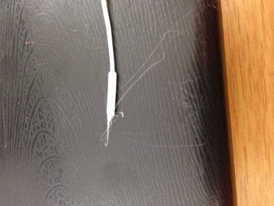

I've got another problem with my rostock max v2 printer. Now it's the nozzle.

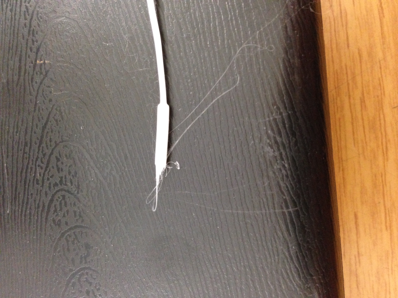

sometimes my filament gets stuck in my nozzle and it doesn't extrude anymore. When I pull it out (hard job, because it's really stuck, big time) and the end of the filement looks like you in the photo.
What could that possibly be? The extrusion temperature for this PLA is 215 Deg. I changed the PLA multiple times.

Are you using a fan on your hot-end? Cool the PEEK insulator between the hot and cold halves of the hot-end. You must do this with PLA or the filament will wick up heat and melt in the cold regions of the hot-end where you don't want it to and cause clogs like this.
Re: question about filament stuck in nozzle
+1
Sure looks like heat creep. It's melting too high up into your hot end then cooling and getting plugged there. You definitely need a fan on that PEEK section if you don't have one. Also, did you try lowering your temperature a bit? 215C is a bit high for most PLA. Might be contributing to the heat creep. Most of my PLA spools I can run between 180-195C, but I do have one that I need to get up to 205C to print effectively.

I installed the fan that cools down the PEEK insulator but the temperature of the hot end doesn't climb over 165° C anymore. It seems like the heating-resistors just don't have enough power to fight the temperature-drain that comes from the cooling. Strange.
