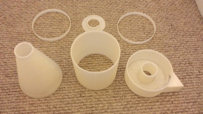

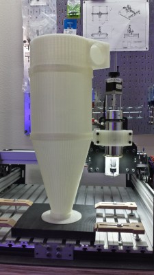

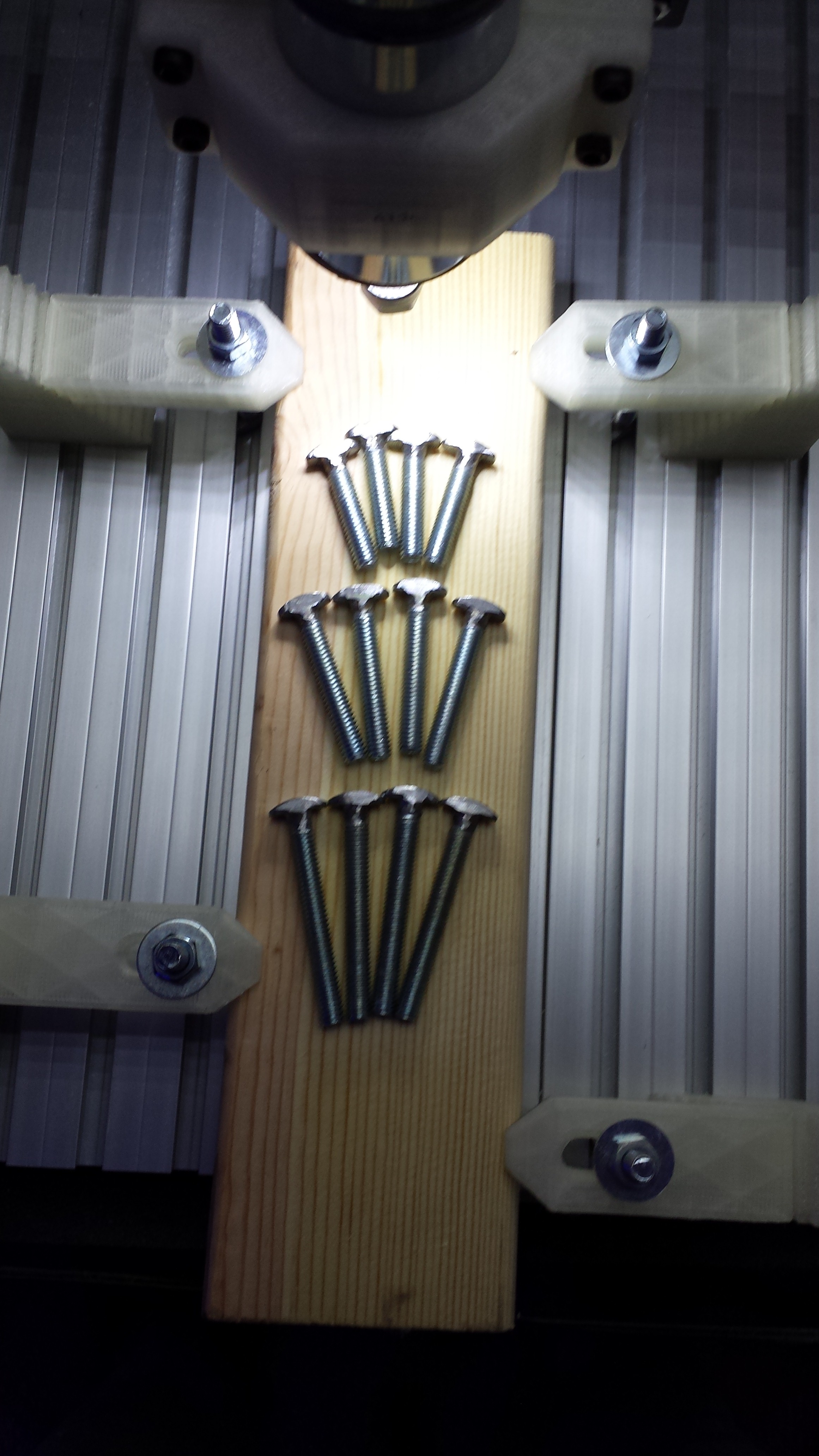

I do a fair bit of CNC work and the dust can be murder on the shop-vac filters. I downloaded and modded a cyclonic dust catcher design. Printed up in natural PLA and went together great. Just a few screws and the hose connectors left and it will be up and running. More pics when it is mounted and a few shots of the Vacuum and dust bucket once I give it a test. So far I have less than $20 in it. Cheapest system I could find (and what mine is partly modeled off of) was over $200. So far it is a win. Really looking forward to hooking it all up tonight and milling a job to see how it does. It is 17" X 6" unmounted and without the hoses attached. Since it is based off of http://www.thingiverse.com/thing:31595, it can be expanded up as needed to capture more dust if this height fails to do the job. I did how ever find the connecting rings a bit too small for my taste. I made them both touch wider and tall in Solidworks and now they fit great. The stock ones were too small and FAR too short for my liking. More pics to come as it gets put together today.
The bits and bots of it all.
Dry fits nice and tightly. Few screws and some silicone should have it running nicely shortly.

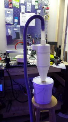

This is how it looks on my small bucket. As I mostly do PCBs and 6061 Aluminum, I did not need a large bucket. Notice it is grounded also by a screw towards the base. That made a huge difference also.

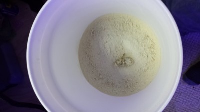

This is the empty vacuum bucket which used to be full of dust all the time.

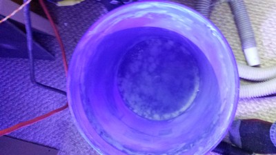

And here is the nice cyclone bucket full of all the dust I tested with. From course to super power fine dust. It all got stopped by the cyclone. LOVE IT!
I thought I might have to make a few more mods to the design but I have to say that it was pretty spot on. Will be doing some long overnight prints shortly to give a larger on to my father for his woodworking. THIS is the sort of thing I bought my Rostock Max V2 for.

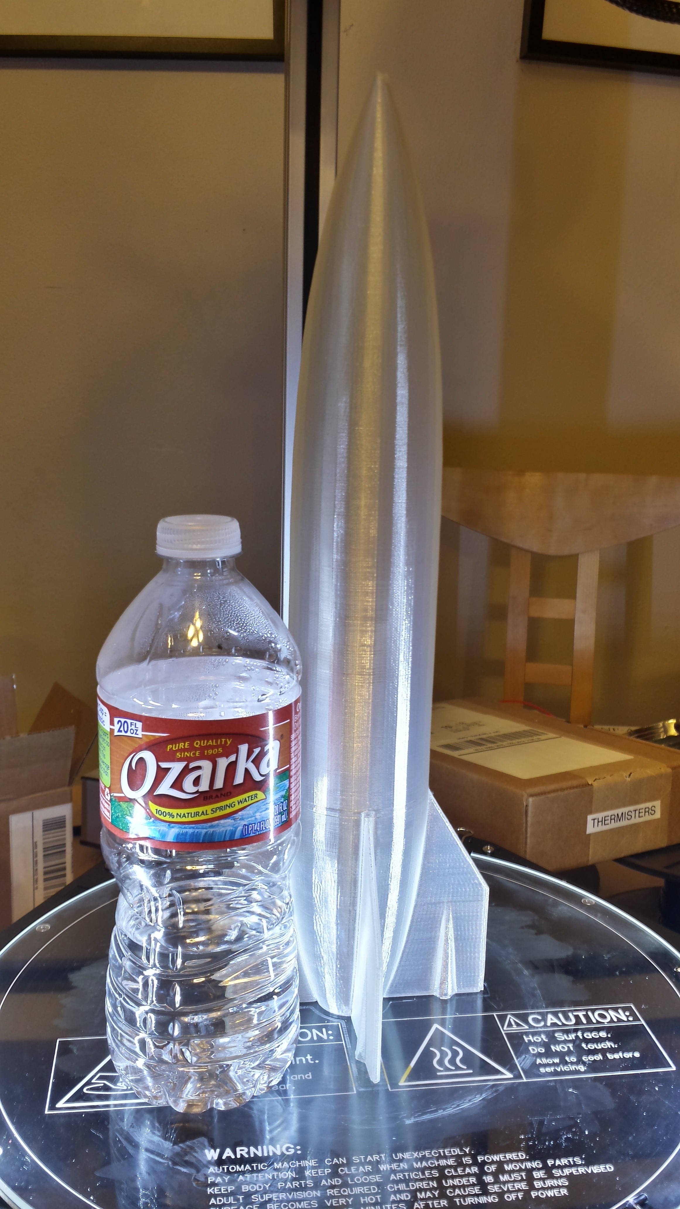

This is pretty much what I was aiming for. I printed it out ona spool of PLA that cost my $14.99 + tax. Only used about a 1/3 or 1/2 the spool over all. I told myself that if I could not make it and have it work well, that is what I would buy instead.
I think half the fun in this thing is watching the dust and stuff fly around the inside edge as it heads to the bucket. watching it! Will love to go visit my dad while he uses his and watch all that saw dust be caught. He is going to love this thing.

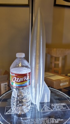

As an aside... This is my largest height print so far. Right at 14". Just a fun single wall print to show off at the Geek Gathering coming up to showcase the great size the Max can print to.
Just a fun test. My other half works at NASA so we have lots of silly space stuff all over. So this was a fitting height test subject.

I worked it up myself to hold a 400W Dc spindle. It allows the spindle to clear the Z motor plate and also has an attachment I am going to turn into my vacuum attachment point. Can you work with a Solidworks file?? I would think you might want to look it over and make a few changes. I used some odd sized scews and such. Or I can make the changes if you are unable to open Solidworks files.
Just let me know.
