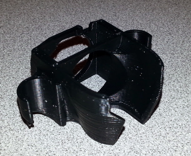

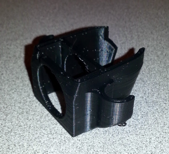

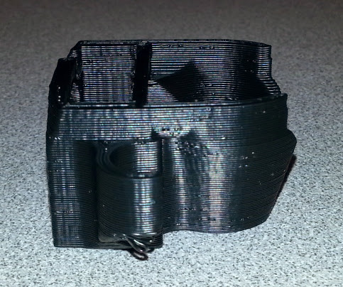

I've been over-working the PEEK fan shroud project. I've printed 3 or 4 to 100%, and stopped mid print on several more. I think I have concluded that there is simply too much overhang on the layer of the first sag, and then there is nothing in place to support the subsequent layers above it. I think the solution would be to re-shape that curve in the model or add support. I've tried printing slower (25% of norm) and it doesn't help. Doesn't really matter at this point. I made three usable parts, each needing minor clean up with a knife. The photos are of the first 100% print, pre-cleaning. The 2nd 100% print is the best, with the 3rd being very nearly as good.
The GDT fan in my kit was disappointing. It did not fit the 1st shroud, so I did a lot of filing of the shroud to enlarge the opening. During one of the many test fits, the fan housing broke beyond repair. I ordered two different possible replacements of the same form factor (25x25x10mm). I take note of the fact that both replacements slip smoothly into prints #2 and #3 without any filing. The remains of the stock fan don't fit the opening, so I'd have to say the supplied fan doesn't meet its own spec.
Finally got it wired up and installed on the hot end this evening. Ran a quick pre-heat to see if it worked and PEEK fan kicked in at 50C. Still need to re-run the PID tuning now that PEEK fan is in. I ended up using the Sunon fan linked above.
I printed a layer fan shroud the other day and the first 100% print looks pretty good. I'll see about getting that one installed in the next day or two. Ordered some PLA to try out and it should be arriving mid-week.
Learned one lesson the hard way, and annoyed enough about it that I might investigate changing things myself. There is a real shortcoming in the LCD control menus. While printing a PEEK fan shroud file from the SD card, I wanted to adjust the temperature a few degrees to see what if any change it would make to the finished product. So, click in to Printer Settings and dial down to the temp you want to change and click to enable adjustment. Game over. As I pushed the knob to allow temperature adjustment, the encoder read enough rotation to jump up one line on the screen just before it acknowledged the push. Sadly the line above is the Home Towers command. I need to study the menu layout and see if there is a safer way to organize the more critical tools.

I also had problems fitting the peek fan into the first print. Broke the fan fitting it in, so I never experienced its noise, as I ordered ball bearing fans for the peek, rambo, and layer fan from digikey (I think I posted the part numbers here somewhere). So all my fans continue working great and silently. The Astrosyn dampers will go in as soon as my trick laser trucks and arms get here.
I think the first print really needs to be some kind of calibration print so that one doesn't over extrude when printing the peek fan shroud. even just a couple % over will make the peek fan too tight of a fit. After getting the extrusion calibrated, then print the peek fan shroud.

I've swapped in the ceramic heater cartridge. The Ultra Copper RTV silicone from the resistors had a pretty good bond on the heater block. I was able to pull the resistors out, leaving RTV liner in the hole. Passed a 6mm drill bit through the hole to clean out a little. Ceramic cartridge slipped in with plenty of friction to hold it in place. Wrapped the block in Kapton tape and its good to go.
Added two more of the 30mm blower fans for layer cooling. A couple of prints had suffered from the very directional cooling pattern of a single fan. The trio should fix that.
Ran a fresh PID autotune to account for the new heater and Apollo is printing again as I type this.
