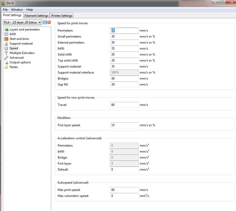

It looks like this problem remains unresolved. I am experiencing the same problem with my Orion. I have tightened the belts and reflashed, you name it but still have the problem on big prints. It is not consistant and I expect it is something like heat. To get things working I simply slow down the prints. In some cases down to 20mm/sec. This takes a long time to print but seems to reduce if not eliminate the problem. The side benefit is that the quality and strength due to better bonding is better.
If you come up with a solution I would be most interested.
Speed Settings
Speed Settings
