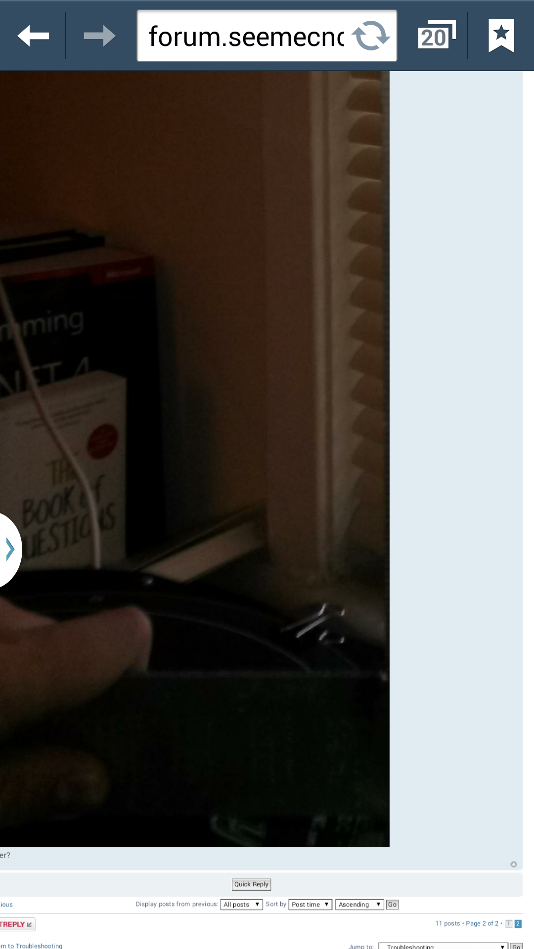

I've loosened the tower, but the distance is so small!
[img]http://i.imgur.com/saNVeFw.jpg[/img]
teoman
Posts: 1770
Re: Bottom base not level
Post by teoman »
Would you mind cropping and resizing the images.
I only see a part of your ruler.

My X and Z towers seem to be at an angle aswell. Y looks good.
4.4 degrees.
teoman
Posts: 1770
Post by teoman »
For those that want to calculate the degrees:
My right angle tool is 13 cm. And when i aligned it between the bed and the tower, I got 1 mm of a gap at the bottom.
So that is a triangle with an opposing edge of 1 and a hypothenuse of 13.
Open google and type "arcsin (1/3) in deg". And it tells you the degrees.

Try opening up the image directly http://i.imgur.com/tPtTihX.jpg
The side opposite that tower is always too low when trying to print on it, meaning the tower needs to be 90 degrees to the bed?

Migrated to laptop. Hit cmd- a few times, now text is so small i cannot read it but i can see your pictures.
