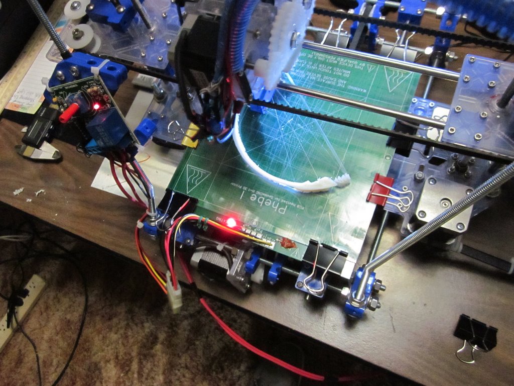

The new heated bed is working really well! Easily holds 100c, I have printed about 6 hours the last two nights without any issues.
Controlling temp with a Vellman board from SeeMeCNC.
Prints sure do stick better to bed and do not curl up.
Nice design, thanks TKL!
I have 4 spring standoffs for bed leveling, then two pieces of 3/32" glass covered with 3 layers of paper mask sandwiched together, then the PCB heater, then the clear plastic build sheet.
So far it has stayed nice and flat.
The stock bed underneath gets a little hotter than I would like, but no problems so far, prbably should insulate under heated glass with something.

Brian, what thermistor are you using? Stock Velleman? Did you futz with the MK138 resistors at all?

Hey Drew, just put a jumper in R6 to use the heated bed. That will allow you to set the low end in line with a heated bed, not a hot end
Re: Phebe is HOT!
Posted: Wed Jun 13, 2012 3:13 pm
by bvandiepenbos
johnoly99 wrote:Hey Drew, just put a jumper in R6 to use the heated bed. That will allow you to set the low end in line with a heated bed, not a hot end
I put a 1k resistor in place of stock R6
( jumper R6 will work also, according to Oly at SeeMeCNC )
I am using a 4k thermistor from SeeMeCNC
Glue in place with small daub of automotive high temp silicone, clamp the thermistor in place until silicone is dry.
Make sure thermistor makes good thermal contact to board, you don't want silicone between thermistor and board, only over it to hold in place.
One thing I need to change is the board LED, it sticks up to high and the head can hit it... should have used smaller LED and/or bend it back away from table.
I also wish I would have soldered wires to come out on underside of board.
Make sure you drill 1 or 2 small holes at back edge of board for zip-tie strain relief for wires.
I wired in a plug from old PC power supply so I can disconnect it for service or whatever.
~*Brian V

Hey, has anyone had any issues with the acrylic base warping from the hot bed? Just wondering if I should make one out of Alum. :roll:
Re: Phebe is HOT!
Posted: Wed Jun 20, 2012 10:51 pm
by bvandiepenbos
tommee10533 wrote:Hey, has anyone had any issues with the acrylic base warping from the hot bed? Just wondering if I should make one out of Alum. :roll:
the pcb heater board should be spaced up about 1/2" from stock bed with standoffs.
I made mine spring loaded so I can adjust standoff screws to level bed.

I have found that the location of the thermistor is not optimal, the temperature difference between the center of the bed, edge of the bed (white lined box) and thermistor location varies to greatly, up to 70C. This isn't a problem with the Velleman board but is a problem with using an Arduino board. I haven't found a way yet to compensate in the firmware for low readings from the thermistor pad, but in the mean time I have 'moved' the thermistor to be on the edge of the glass plate, its a closer reading there, within ~20C of actual temperature.

Why do you care if the temperature is correct, my bed thermister reads 20 degrees low across the board (largely because of location), I just take it into account when I slice the file. You don't need accurate temperature readings, just consistent.

michaellatif wrote:I have found that the location of the thermistor is not optimal, the temperature difference between the center of the bed, edge of the bed (white lined box) and thermistor location varies to greatly, up to 70C. I have 'moved' the thermistor to be on the edge of the glass plate, its a closer reading there, within ~20C of actual temperature.
I see nothing that can be done with the layout to change that. There will always be a difference between the temperature of the PCB tracks and the surface of a overlaying glass plate. The only thing to do is to glue the sensor to the glass.
