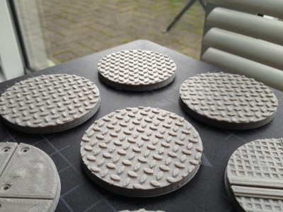

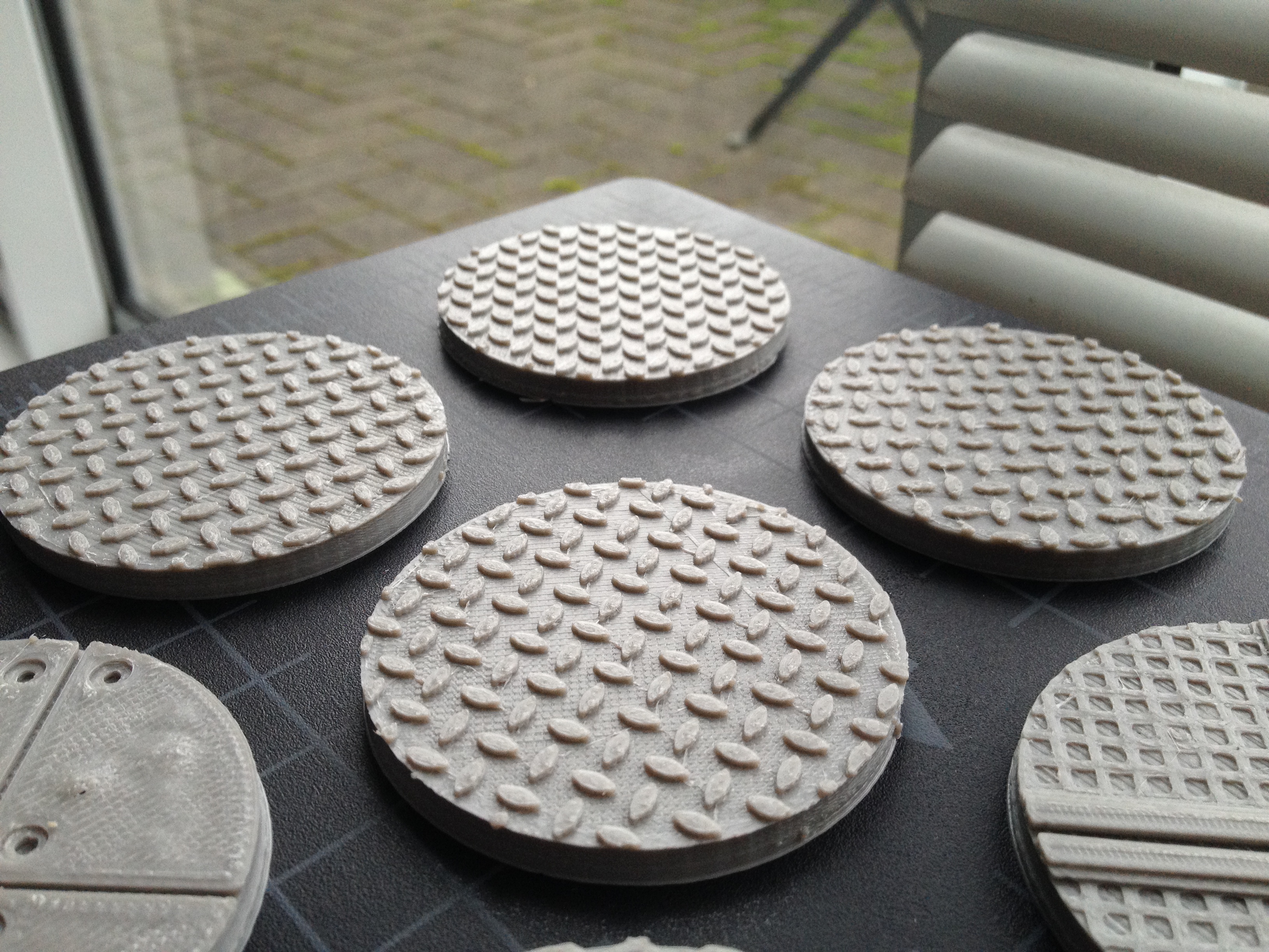

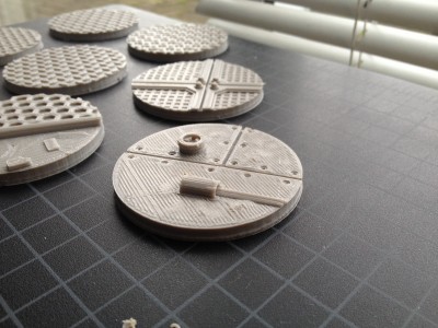

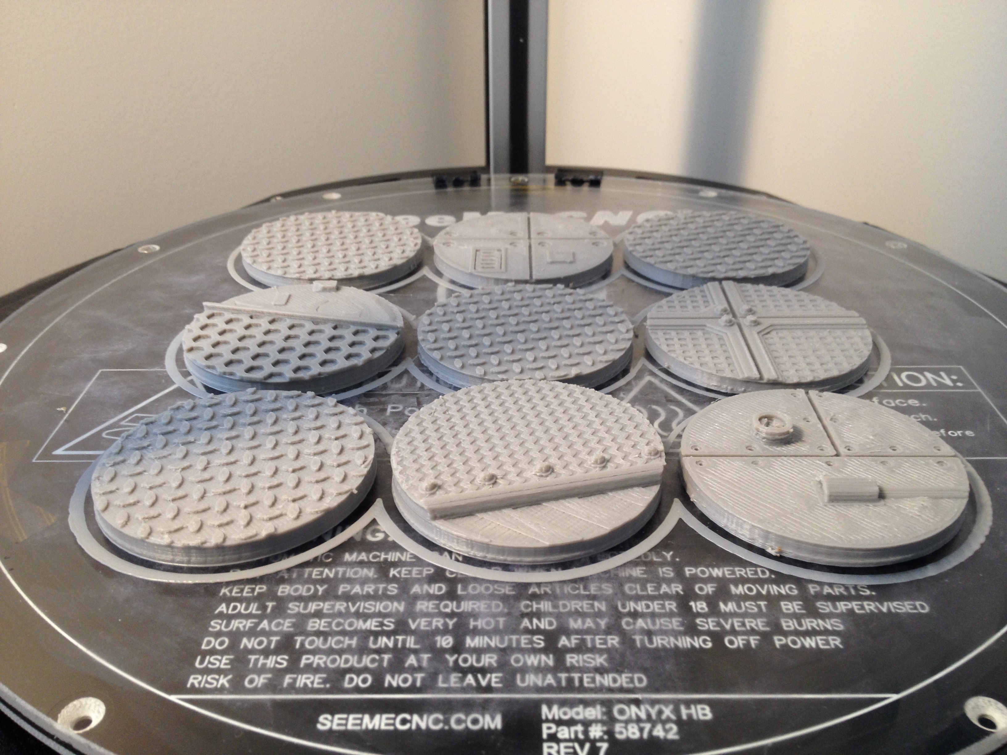

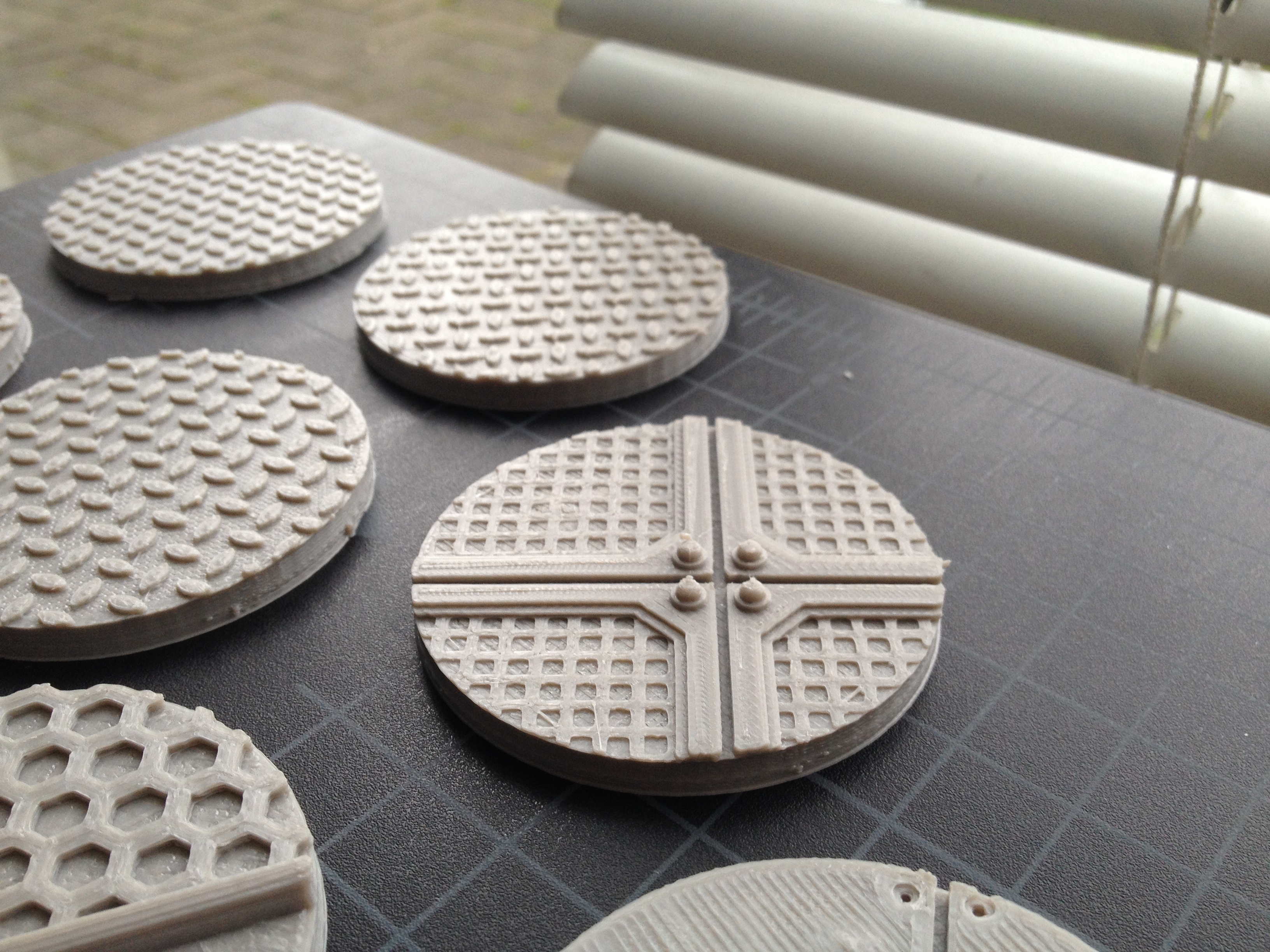

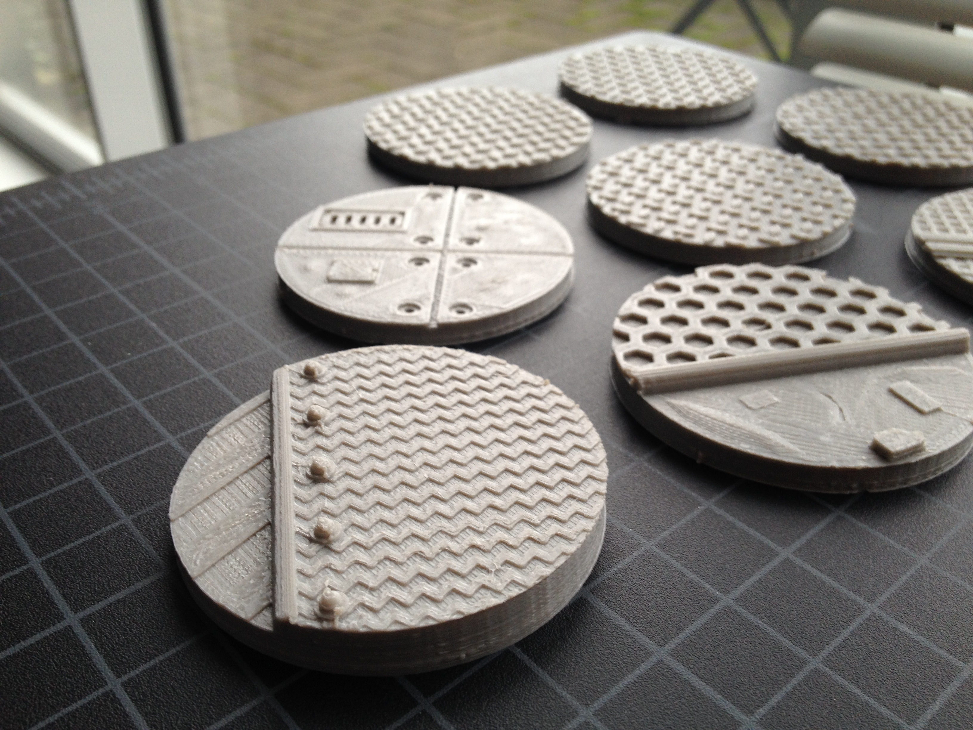

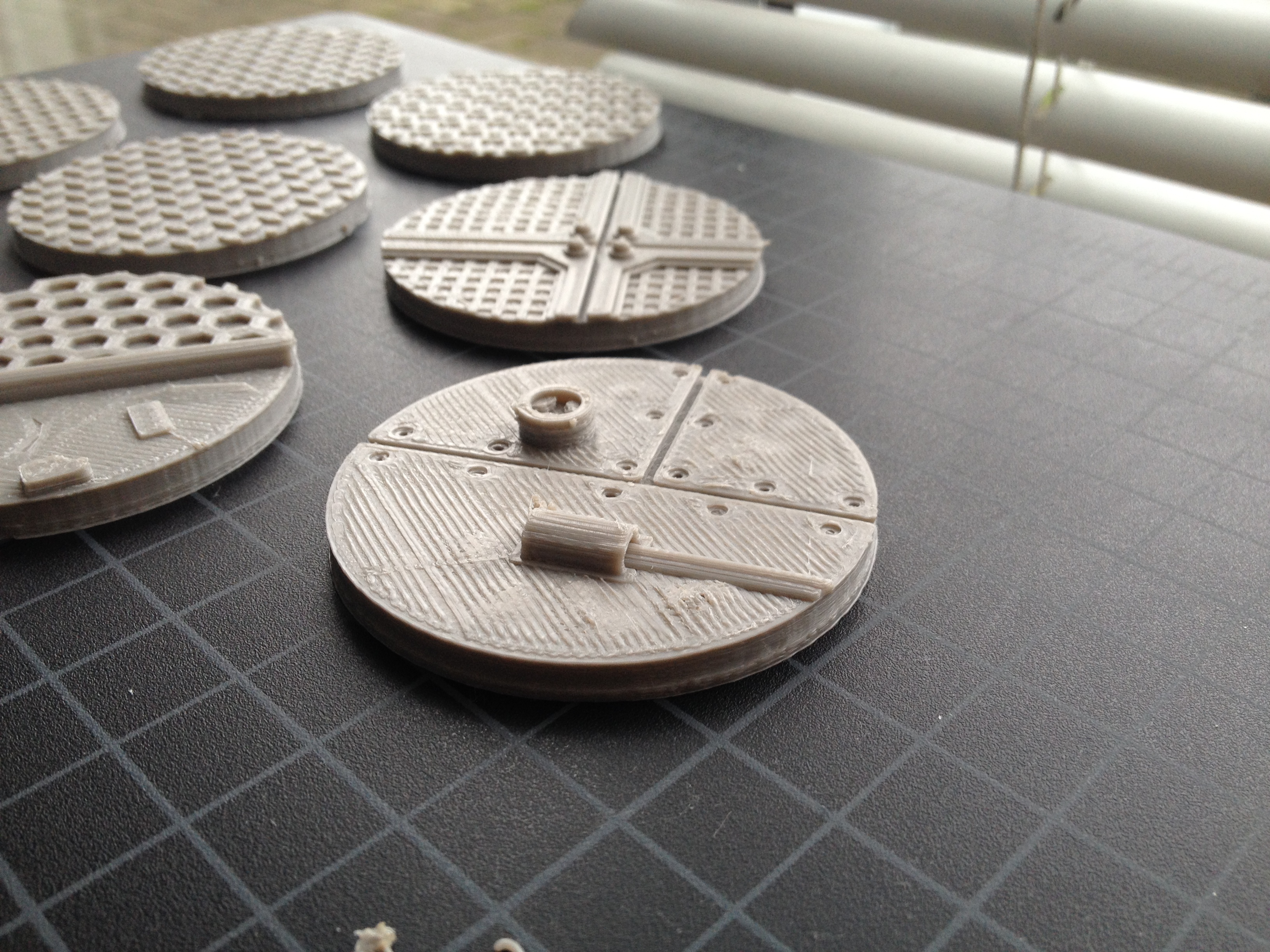

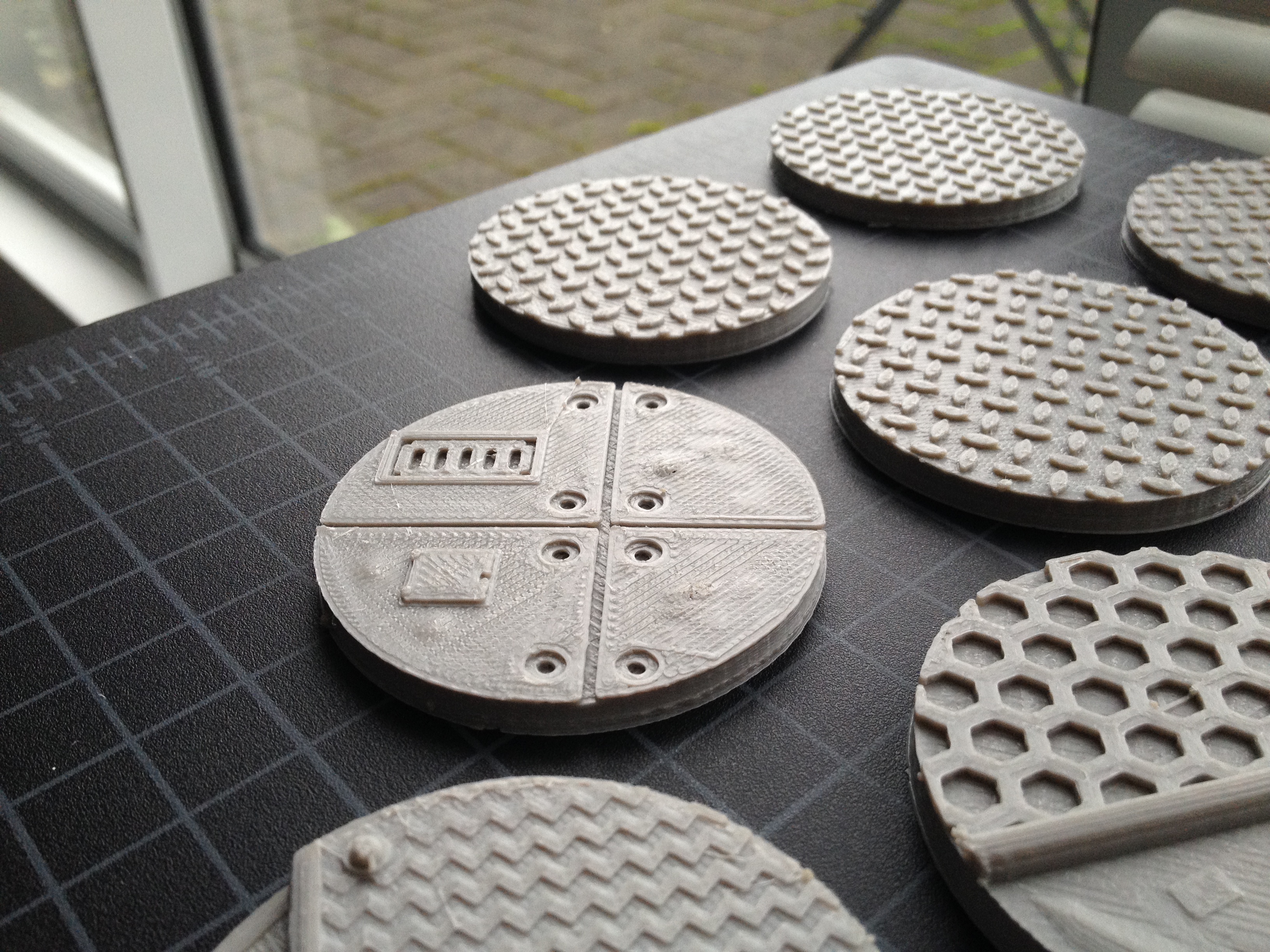

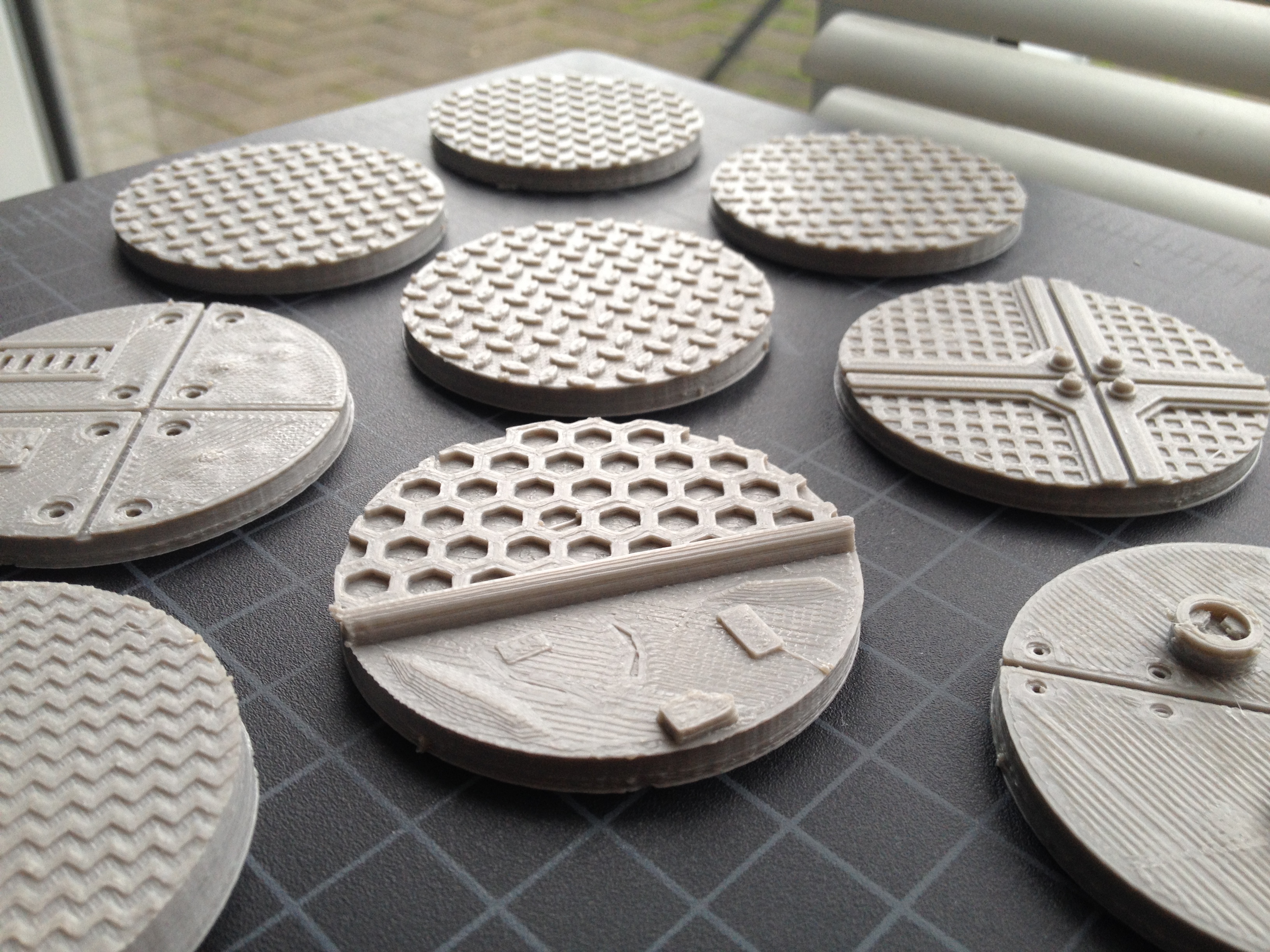

Scaled up from these 40mm ones from thingiverse.
Grey filaments.ca creative series ABS at 100 micron layers, stock .5mm nozzle (basically stock everything). Printed at "150mm/s" infill, 90 perimters. In quotes because I think the jerk and acceleration values are not enabling the true full speed. Approx 8 hour print time.

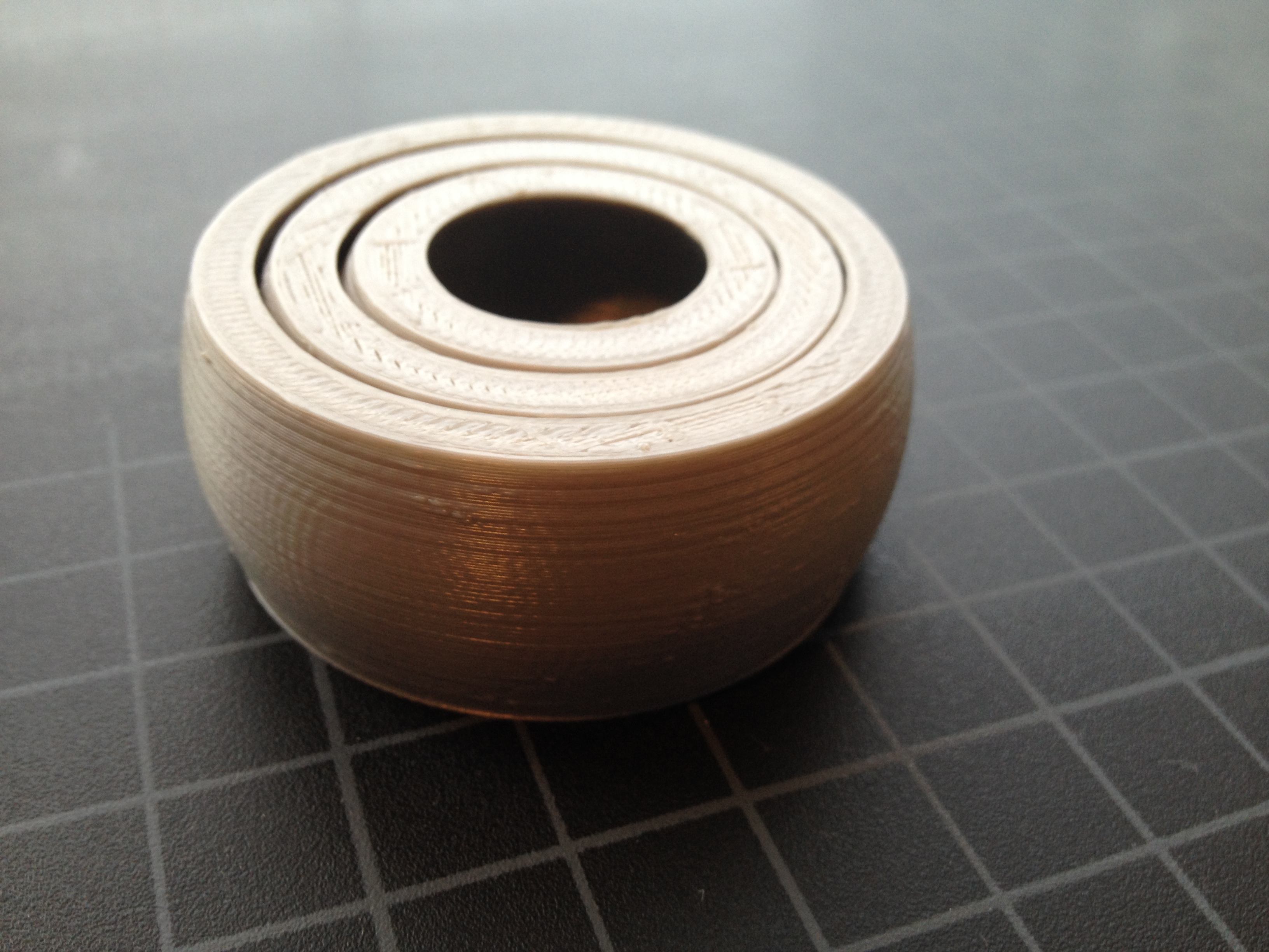

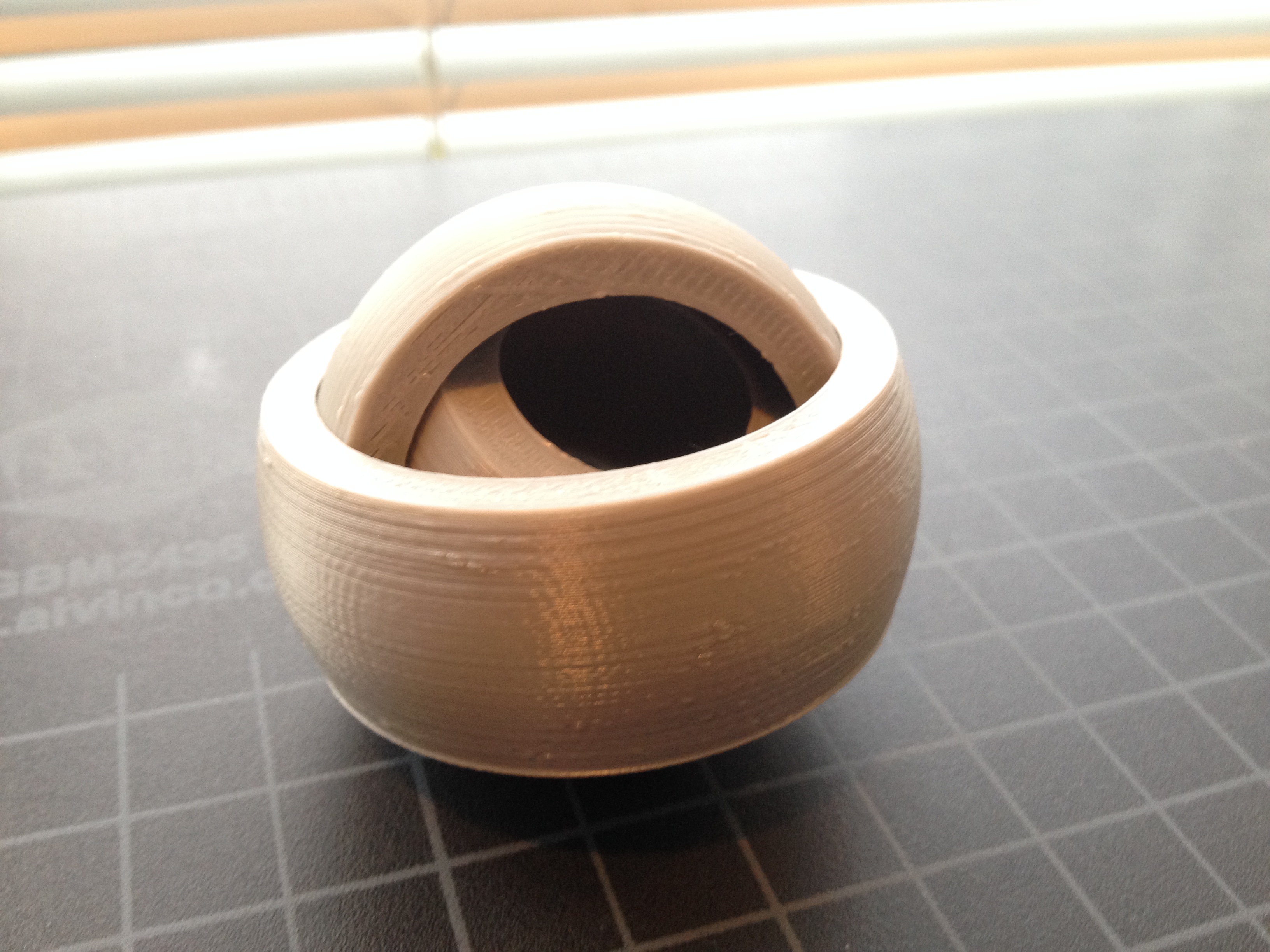

Also did this one in about 2 hours... 2 and a half maybe. 200 micron layers, all "150"mm/s.

Gorgeous prints there! Love those wargaming platforms... Makes me want to get some warhammer figs just to use these!

150mm/sec speed? holy crap... i think 60mm/s is screaming...
