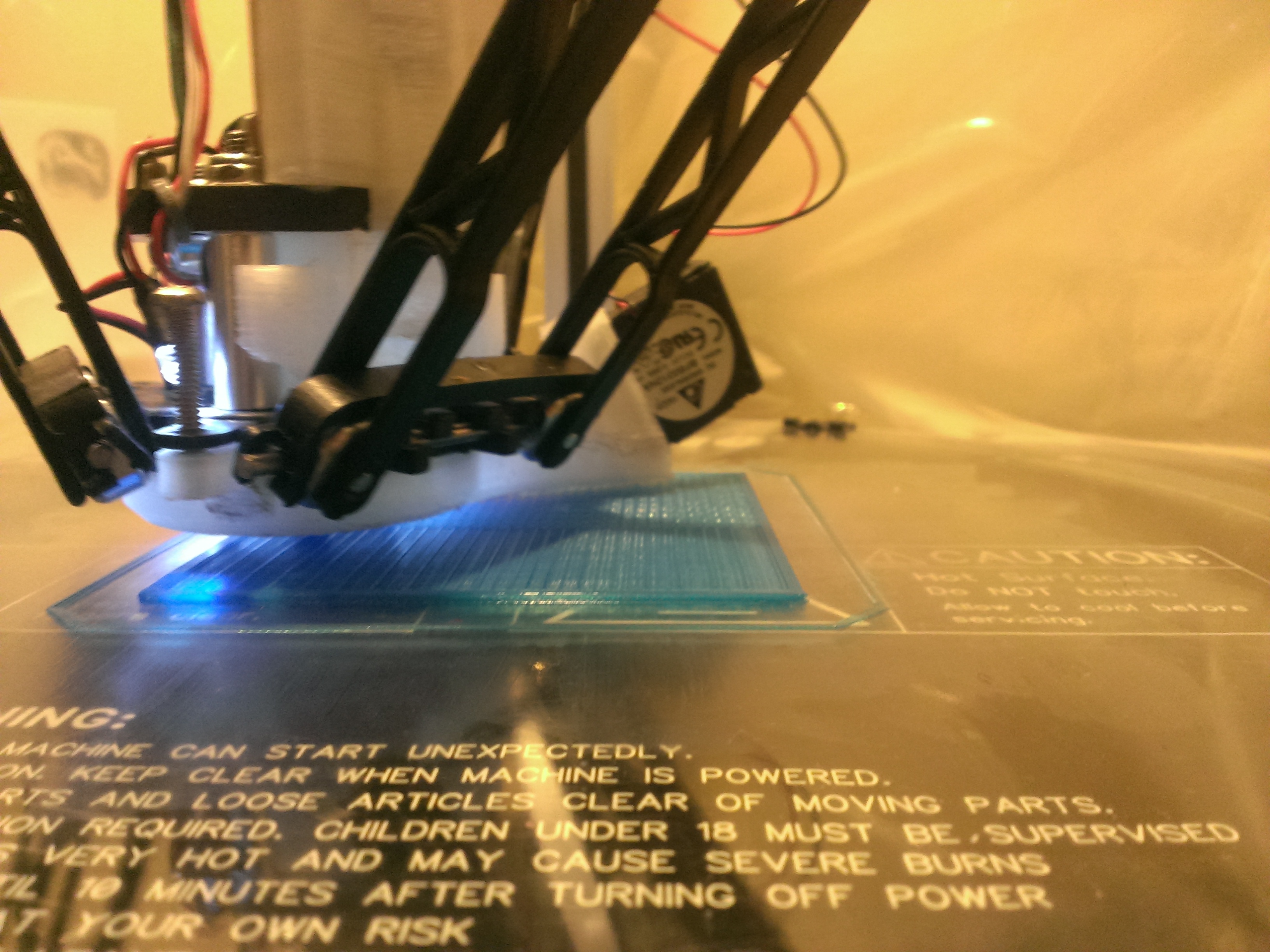

Designed this layer fan duct for 360 degree cooling
[img]http://i.imgur.com/oWO4vvW.jpg?1[/img]
files: http://repables.com/r/436

That is insane! I love it! Why didn't you post the STL with it, you naughty boy...
Re: V2 in Minnesota - plenty of questions.
Yeah... what he said!
Throw it up on Repables, if you're willing to share.
