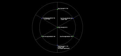

I've had a Rostock Max V2 running for a month or so and can successfully print objects that fit into a 5-6" diameter circle in the center of the machine and the turn out pretty nice. But recently I started a project requiring a rectangle of roughly 8"x6" and that's when I discovered an anomaly I haven't been able to adjust out. Here's the meat of the problem, when I do the calibration I get my Z,Y, X towers and center perfect with multiple iterations of end-stop adjustment and Horizontal radius adjustment using a 0.003" feller gauge instead of paper and it's all good in the triangle the towers form; however when I check points opposite of the towers I have positioning errors. I have attached a drawing of what I have found, but basically to the left and right of the Z tower the nozzle is higher that expected and lower than expected across from it. In the drawing the inner circle is 200mm OD and the outer circle is the 280mm OD print area.

Have you checked the perpendicularity of your towers to the bed. Looking at you numbers suggest that the X and Y towers may be leaning away from center and that the Z tower may be leaning towards center.

nitewatchman - I will check for square on the towers but everything seem fairly tight fitting, any advice on making adjustments if needed?

I found that on mine even though the towers fit tight in the base if the clamps were loosend the top could be moved quite a bit.

Thanks for the responses guys, I ended up shimming and re-calibrating until I got a level bed.
I'm not entirely sure if it's the technically correct solution but it did get my machine playing nice.
I did find that my towers are off slightly, which is probably the actual cause for my issue, but I can't get them to stay square they just pull back into the position the want to be in...I'll have to play with it more.
