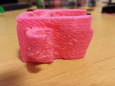

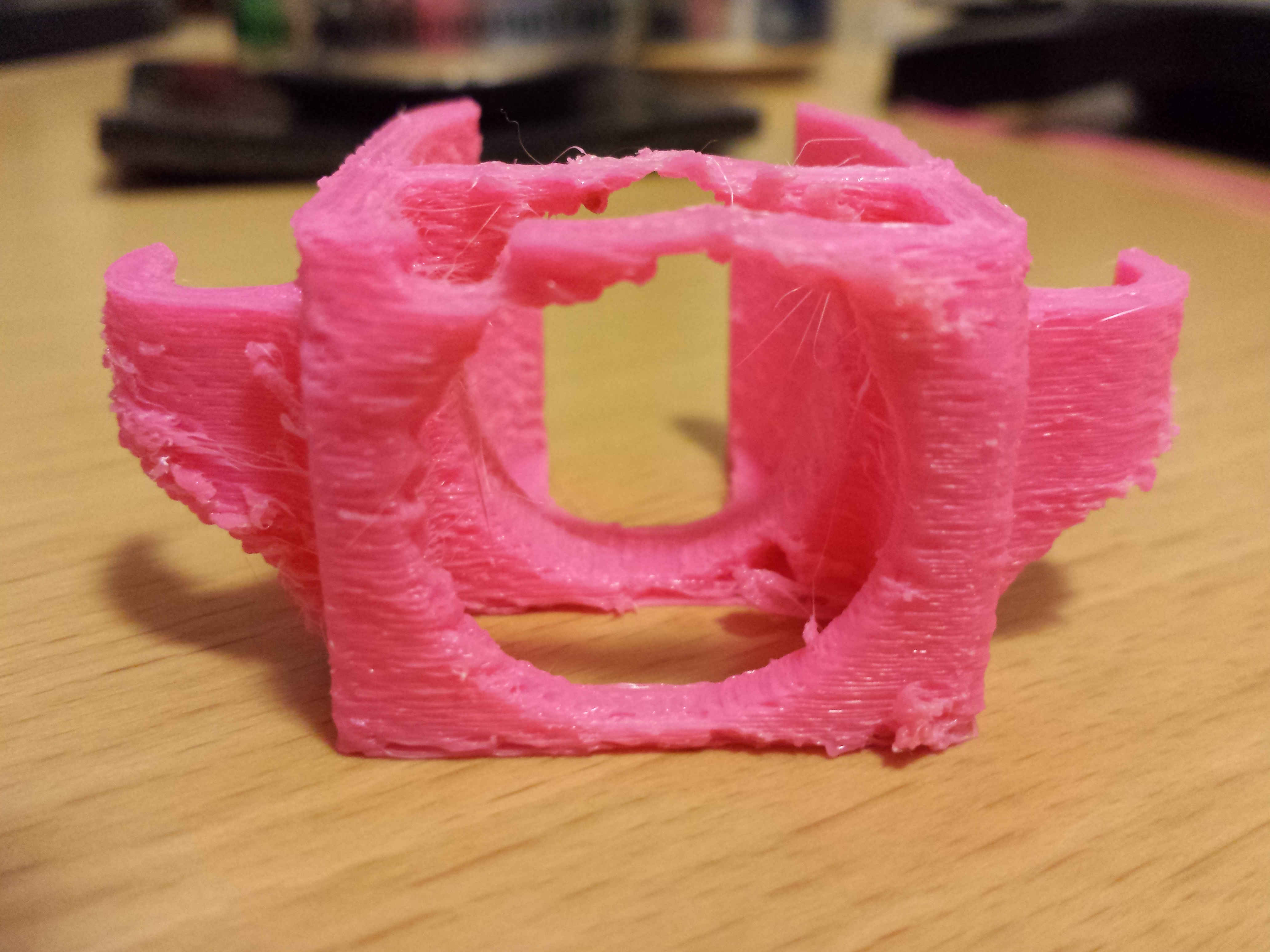

I just finished assembling my Rostock max, so my first print was the PEEK fan holder. The printer did an awful job with the print, the overhangs on the "wings" are a globby mess, the bridges on top barely formed, and the interior space is too small for the fan. This is with stock MatterControl settings, except the flow rate is 75% and I dropped the extruder temp by 5.

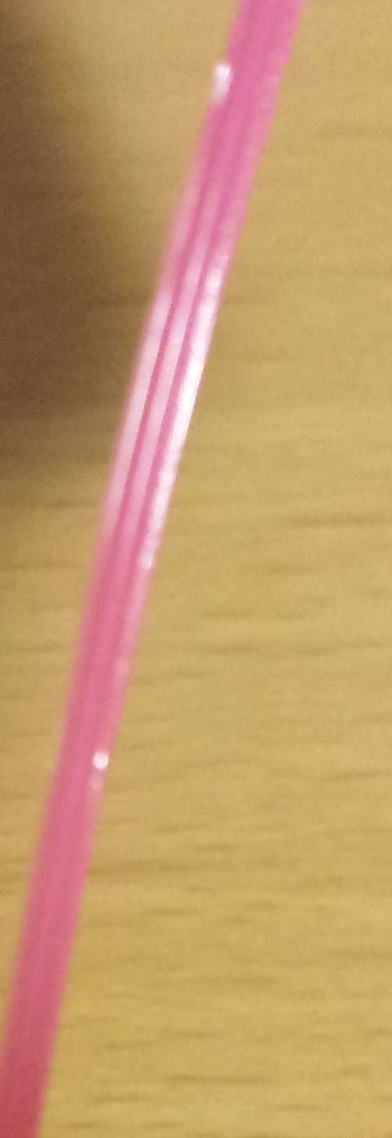

Then, when I was priming the nozzle for another print, I noticed something that didn't look right.
Extruded filament
Extruded filament

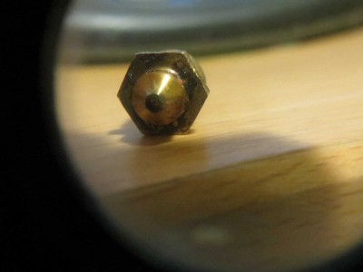

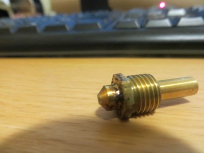

Why is the extruded filament grooved? Well, it looks like the nozzle is cracked.
Cracked
Cracked
Side
Side
I couldn't really get a clear picture (even by holding a magnify glass over my camera lens :)), but the inside of the hole is at a 30 degree slant. Compare that to the stock nozzle, it comes to a point.

Wow, the first cracked nozzle that I have seen.
Contact Seemecnc and they will take care of you.

This is exactly what my extruder head looked like after I slammed it into the bed during tower height calibration. I got a new one and all is well.
Russ
