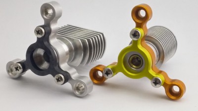

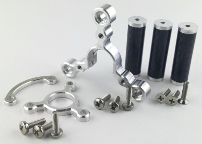

- Compatible with the E3D V6, Volcano and E3D LITE6
- 3 included M3 screw mount the hot end to the effector plate. Bye Bye long bolts and nuts!
- Also compatible with the Prometheus V2 and all standard 12mm slot mount hot ends.
- Basic kit includes everything you need to get your hot end mounted in minutes in a rock solid mount including our new strain relief loop for wire management.
- Also compatible with the Yellow Jack from The Maker Hive.
- New wire management loop for strain relief. Can be placed on any of the three sides. Wire can be held by it or wire tie used.

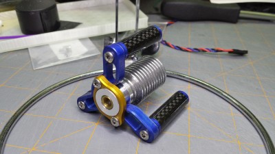

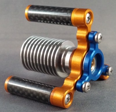

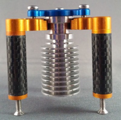

So I got a bit bored and decided to solve an issue I was having on my printer. I do a large amount of really long prints (36-52+ hours each) and I have had to replace my E3d V6 mount twice now due to it getting a TINY amount of wobble over time. It is a great designed mount, but wears out after too many large prints for my taste due to be made from plastic. So I sat down in Solidworks and throw together something that is working really great so far. Below is a picture of my BETA design and test model
It is an aluminum groove mount with a small locking ring to hold the print head in place. This rests on top of three custom length carbon fiber spacers. The spacers are capped off with ultralight weight caps that align the spacers and allow short titanium screws to replace the 1 3/4"+ steel screws and lock nut. This also allows you to only remove the mount and leave the spacers in place, thus stopping the mad juggle of trying to line up the spacer, long screw, mount, locking ring and the nut with two hands. Now you simply unscrew the nut on top and leave the screws at the bottom of the spacers attached to the printer.
So far my printing tests have shown no decreased performance compared to the mount I was using.
I am going to play with this mount for a few more days and refine it a bit more. The finish needs a bit more work to take the anodizing a bit better on the cut edges which is something I will work on in the next week or so.
I am also playing with a full carbon fiber mount to see how much weight I can lose on the print head overall. I am also planning to adapt this modular style of mount to both the Chimera and the Volcano print heads through changing spacers and the milled mount piece. Just waiting for both to arrive so I can get started on this ASAP. Also going to look at doing something very similar to the stock mount to make it a bit easier to mount a dial indicator for calibration and to lighten things up a bit on the stock print head. I had to throw it back on in a pinch while waiting for replacement parts on the E3D once. Would be nice to just undo the bottom three screws and drop in a whole unit with mount, spacers and print head with just three small screws and not fuss with the bolt/nut system.
More updates to come!
Posted: Sun Jan 04, 2015 6:15 am
by Nareikuk
Looks great. Will there be a YellowJacket variant?

I was wanting to grab some feedback from you about your thoughts on the Yellowjacket and my mount. I was looking at the Yellowjacket and noticed that overall both it and my mount serve the same purpose of mounting the print head to the effector plate. Of course the Yellowjacket packs a ton of other cool features into the same package also. I am very open to have something that would work with the Yellowjacket, but I am wondering what you had in mind? I can make a plate that will allow the Yellowjacket to be mounted on top if that is the desire, but It is sort of doubling up on attaching the head to the effector plate. I am always open to ideas and would like anyone's thoughts on how they would like the two items to work together.

You are right on about the long screws being a pain, I thread the OEM SeeMeCNC aluminum standoffs 8-32 and use short button head allen screws from top and bottom, then leave standoffs connected to hot end mounting plate when removing head. ...much easier!
Posted: Mon Jan 05, 2015 6:14 pm
by travelphotog
bvandiepenbos wrote:That is a really nice looking mount.
Sturdy and lightweight. Great design.
Thanks! You beat me to the punch on your trick trucks. I still plan on getting a set and anodizing them myself down the road.. Redoing the trucks was on my to do list but you beat me to the punch. I should be picking up a set within the next month or so.
One of the main reason for my redo was to lose weight on the effector platform and make it easier to do thing like mounting a dial indicator for calibration without have to do the Rostock finger shuffle to remount everything. I went with 4-40 5/16 and 3/8 titanium button head screws for mine (still waiting for them to arrive of course). So far it is MUCH easier to switch things out. The inserts are pretty easy to mill overall for the carbon fiber tubes. I even had to mill a special tool to hold the inserts for tapping which works out really well. I do know that I will not be returning to the 3 long bolt system again. This is the way forward me so far. Have you found the screws to hold well over time? Mine have so far but I hardly have 30 hours or less on them so far in printing.
I am working on a stock head mount tonight. I should have something off the mill shortly to show everyone and get some feedback.

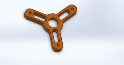

- BETA stock SeeMeCNC hotend mount.
So this is what I am thinking right now for the stock SEEMECNC hotend mount. I should have some pics up tomorrow if the mill plays nice tonight.

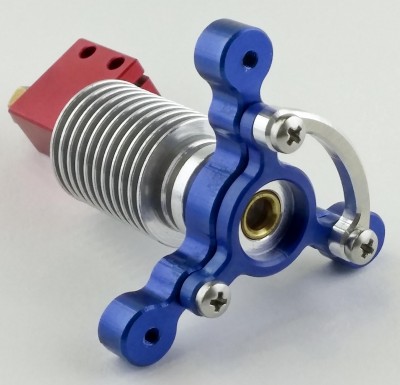

These are the fresh off the mill shots of the stock SEEMECNC hotend mount. I should get it anodized later today and also will try to cut some carbon fiber spacers and have a few shots of it mounted. Titanium screws came in today also! Really looking forward to getting everything mounted up and some beauty shots done this evening.
So here is a question for everyone. For the spacer on the stock hotend... Should we recycle the stock piece? Or would you guys like it better out of aluminum or maybe a carbon fiber tube on end as a spacer? Most votes gets to green light on that next.
Posted: Tue Jan 06, 2015 12:20 pm
by Mac The Knife
I machined my mount out of 1/2" bar to eliminate that little melamine spacer. I had considered it part of the cause of the problem of the hot end loosening up after time.

Mac The Knife wrote:I machined my mount out of 1/2" bar to eliminate that little melamine spacer. I had considered it part of the cause of the problem of the hot end loosening up after time.
I would mill it out of 1/2 stock but for me I have two drawbacks for that on this mount. My first concern is I do not use this mount so it is a side project and the second and main concern is I only have a Shapeoko 2 CNC right now so milling that much off a 1/2" stock is just not time or cost effective. If I had a larger mill and the demand was higher I would mill from 1/2" but right now that is just not a real option for me.

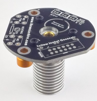

The yellow jacket board does not have any good way of holding the E3Dv6. There is a triangular part that can be printed to press the top of the hot end against the yellow jacket, but I think an alloy triangular wedge that clamps around the top of the hot end and bolts to the underside of the yellow jacket might be more secure. The board itself is quite thick and so will not flex very easily which is a very good start. Of course, either way, longer stand offs are required and your carbon/alloy standoff would be very nice. For mine, I printed three 13mm x 9mm diameter extensions to the aluminium standoffs supplied with the printer. I must draw up something in solid works and print it to see how it would work to hold the hot end more securely to the YellowJacket. I'll put it on my list
My explanation above could probably do with a diagram or two to help...
Posted: Tue Jan 06, 2015 3:53 pm
by Jimustanguitar
There's no reason that you can't just use it as a connector board. There's plenty of extra JHead groove to put a different mount in there and stack the YJ on top of it.

I just remembered something that may bring this project to a screetching halt (at least until a new board revision is done, and one is coming soon)
As it is now, the three mounting holes for the standoffs are electronically isolated, however the 3 in the middle are not. Anyone who has one of the Yellow Jacket boards look at the top of it, you will see a G- and a G+. The G- is connected to the ground and the G+ is connected to the hot end positive. This was intended to be use in conjunction with the
http://tricklaser.com/LED-hot-end-heati ... ED-HAT.htm Top Hat LED from Trick Laser. This would allow you to eliminate the wires and use the screws as conductors to power the LEDs but somewhere alone the line that didn't happen. So until that is removed from the current version of the Board, I would highly recommend using Nylon screws to secure the hotend clamp
