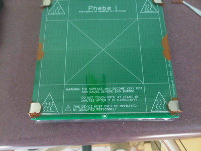

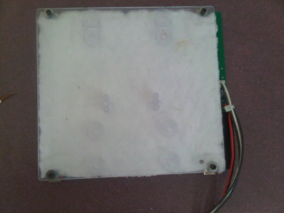

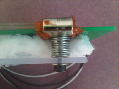

We added last week a heat bed and boy was that fun to build up. I took glass shelving clips and tapped then, then bent then to form around the glass and heat bed then attached to the original Seeme bed with alan socket heads to make fully adjustable table for the best prints i could obtain.
