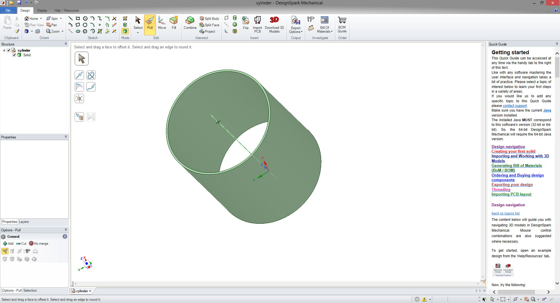

I am very new to 3D printing. Just recently finished my Rostock Max V2 assembly. Love this machine and technology. I am a Certified Prosthetist by trade and cant wait to implement 3d printing into my practice. The first project I would like to undertake is printing a cylinder 6" in diameter by 8" in height. Not sure how thick it needs to be but it can't be too flimsy. The cylinder is going to be used to prestretch a compression garment that is one of the first things applied after surgery which controls post surgical edema and helps with pain control. I have no CAD design experience so a simple project like this is very confusing to me at the present time. So I am asking for help to design this. If someone could send me the STL file for this it would be greatly appreciated and helping your fellow mankind at the same time. I have been modifying plastic trash buckets to perform this task presently. When I learn how to use CAD software to design I would eventually like to spruce up the cylinder with the letters COPA printed on the outside to represent my company name. Thanks in advance because I have seen how helpful people are here on the forum.
PS. Forgot to mention the cylinder is open ended both ends.

160mm OD, 4mm wall, 203mm tall.

Check out DesignSpark Mechanical. It's a pretty full featured (free) CAD program with an easy learning curve. I drew and printed my first parts the same night.

I also recommend Design Spark.
For this project just define two concentric circles, click on the space between and pull the cylinder to the height that you want. You can then export directly as an .stl file. Takes about that long.
