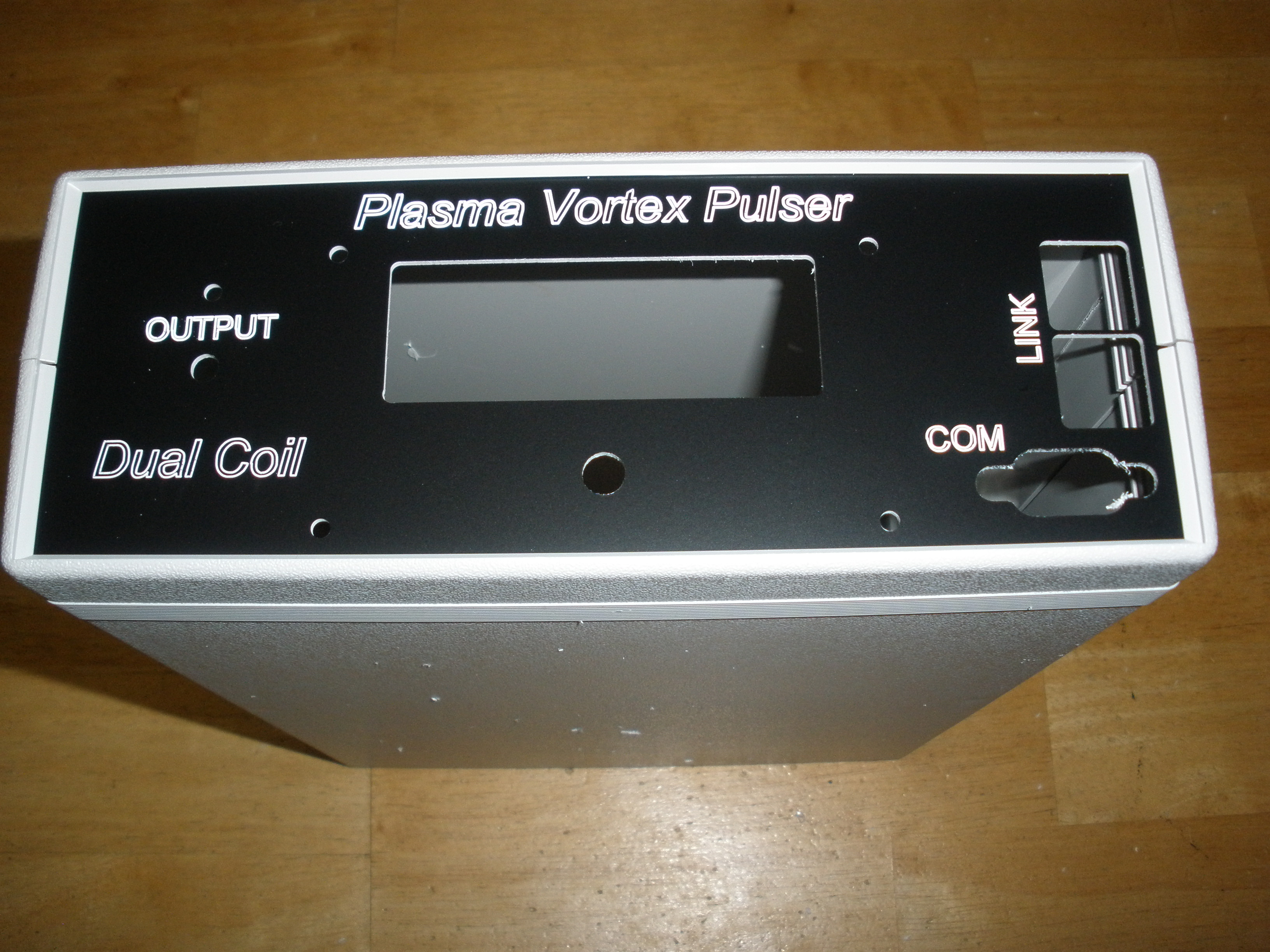

Any suggestions for decent 3D or at least 2-1/2D CAM software for a small mill? The latest update to my CAD software broke the CAM plugin (again). They haven't really updated the CAM plugin in years so only charge me for the main program updates, but still...
Anyway, I've got some very simple DXF to g-code software that is getting me through current projects (see attached) but I'm going to need something better eventually. Free is best if it works. Cheap is second best. Expensive is out of the question.
The lettering was done with an engraving cutter in the mill, then I changed tools to make the holes.

I downloaded the trial for SheetCAM and it looks like it's going to work well. At the moment I need to make a minor edit to the g-code file to turn my non-standard spindle on and off.
The demo allows you to save up to 180 lines of g-code which is fine for testing. I'm going to cut out some simple panels tomorrow.
Their way of selecting machining operation using layers in the DXF file is interesting, seems like it will be pretty easy once I get used to it. My current CAM plugin doesn't have any automatic selection of a group of things to machine, you have to click on each hole/pocket/etc. and set the entry point and what you want to do with it. The SheetCAM method should actually make things faster for panels with a bunch of holes (I have some with fan guards and air vents milled in).
