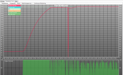

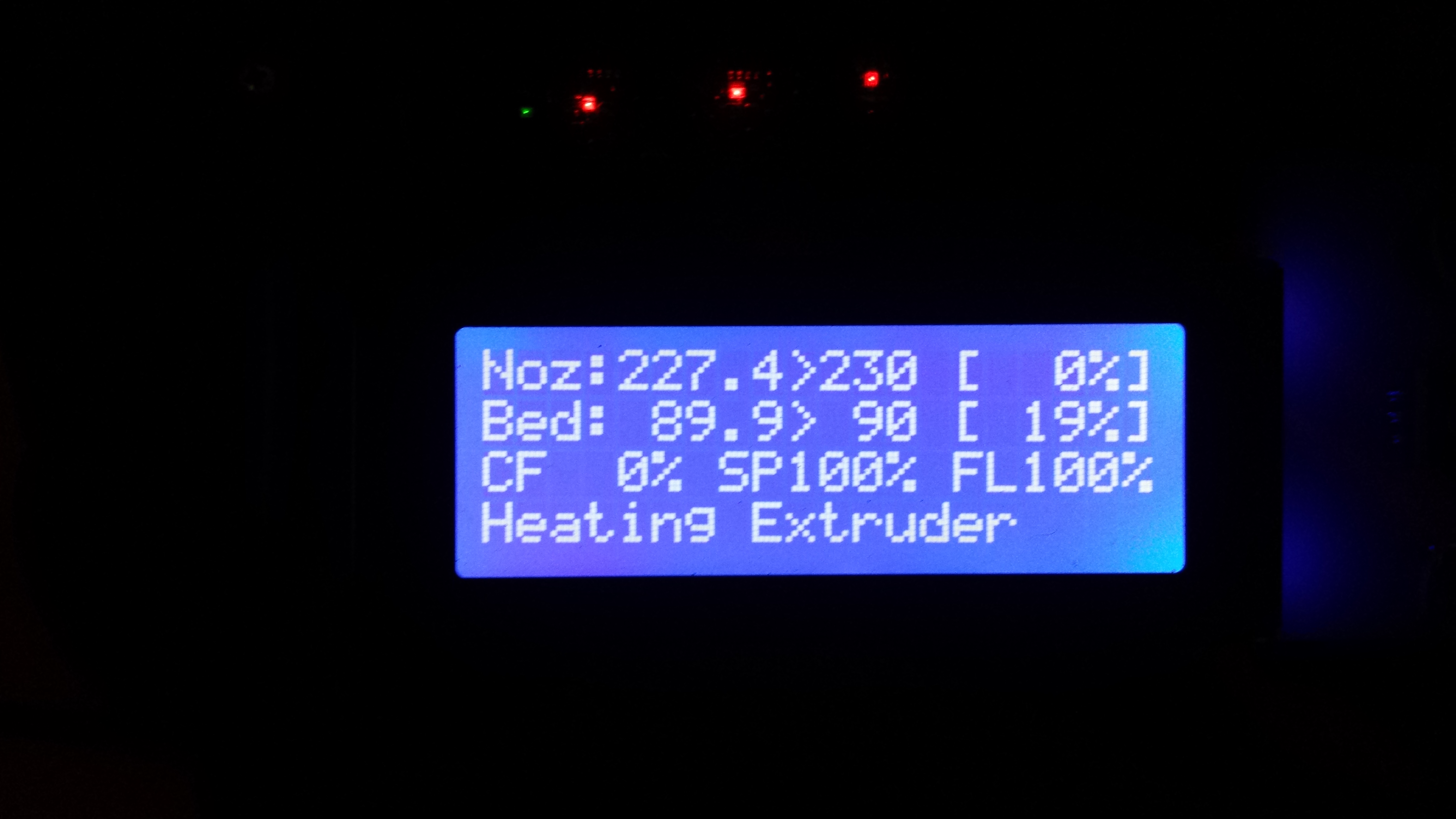

No its cutting the power to the nozzle as can be seen below as I've got the UI modded to display % Power to the Bed and Nozzle
and incidentally Layer Fan %age which is Cf @ 0% btw se below:
Cutting Nozzle power prior to setpoint
TempTrace
TempTrace
Anyway as can be see above its cutting it to Zero at ~227 with a target of 230 so never gets there.. if I manually set it to 230 it gets there ok.

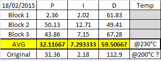

Posted: Wed Feb 18, 2015 5:30 pm
by RocketMagnet
Finally got round to doing this using MC Autotune and it did fix the issue somewhat. Not sure but there was a wide variance in each P I & D individual values over the 3 data sets
Is this normal or should they be +/- an acceptable variance?
PID Values
PID Values
PID Values.png (5.75 KiB) Viewed 16457 times
Presumably my original values already in the machine were set at 200°C during SeeMeCNC build? .. As I almost exclusively use ABS I performed mine at 230.
Really odd but it's been fine for several months. Should I be concerned that something is going faulty and I'm compensating for it or is drift normal?
