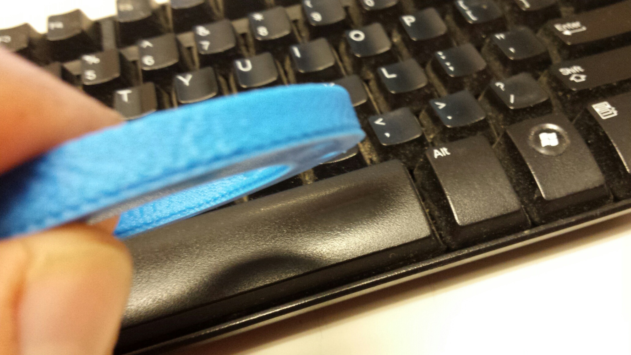

when I print an object, a single object, centered on the bed it prints a few layers just fine, then maybe 5 layers up the print shifts towards the rear tower for 2 or 3 layers, then it continues to print in its new location over the print. I end up with a step in the print. I have done the calibration steps seemecnc posted on youtube, this of course causes a weak print if it is something with a thin wall like a calibration box.
my first impression is that this is actually a hardware problem, not software (unless the slicer is doing it somehow)... I have checked belt tension, check all the nuts an screws on the carriages, gave them all the wiggle test, check my arms for play, watched the thing like a hawk to see if there was a mechanical problem as it was moving, looking for jarring or popping or anything that would cause this problem.
