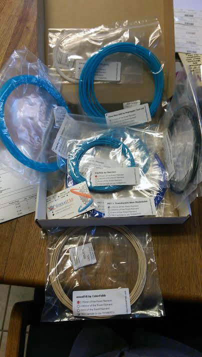

For filament I ordered:
@ Printed Solid
colorFabb Sample Pack copperFill
1.75mm Cheap PLA - 250gram Mini Spools Transparent Orange
also shipped super quick (see above photo)
@ SeemeCNC
1 pound spools of PLA in black, blue, and white.
@ MakerGeeks.com
SemiFlex-Snow
Maker Filament PLA 1.75mm Royal Purple 1kg
@ globalfsd.com
Pet + by MadeSolid - Colour:Translucent Blue
Multi Walled Carbon NanoTube ABS by Filabot
FilaFlex by Recreus - Colour:Blue
Glow in The Dark PLA by Reprapper Tech Co Ltd - Colour:Glow in the Dark Blue, Diameter:1.75mm, Sample Length:10 Metre sample
1.75mm Cleaning Filament by Oo-kuma - Diameter:1.75mm, Filament Length:1 Metre
Glow in The Dark ABS by Reprapper Tech Co Ltd - Colour:Glow in the Dark Blue, Diameter:1.75mm, Sample Length:10 Metres
So I'll have lots to play with! lol.

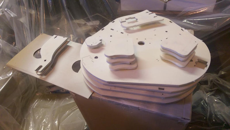

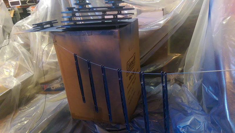

I plan to paint the edges metallic cobalt blue and maybe the pillars as well. (not painting the parts the wheels ride on)

Thanks, and yeah if I decide to paint them I'd buy this
http://www.rustoleum.com/product-catalo ... imer-spray
and this is the cobalt blue I got http://www.rustoleum.com/en/product-cat ... t/metallic

If you really want color on the beams, mask off where the rollers roll and paint the rest.

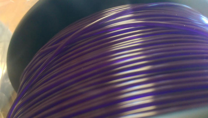

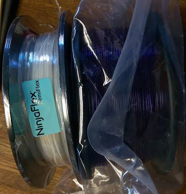

Got some more stuff in today, and the printer should be here Monday!
MakerGeeks.com order
Maker Filament PLA 1.75mm Royal Purple (pic taken through the bag)
globalfsd.com order
globalfsd.com order
They gave me a free sample of Colorfabb Woodfill as a thank you (HOW did they know I wanted to try that stuff!! :lol: )... not to mention it shipped from the UK and got here in under a week!

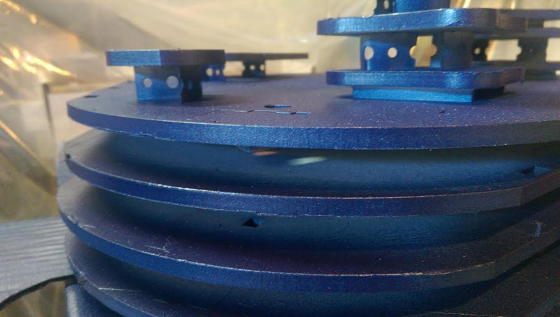

IT"S HERE!!!!! :D
Primer
Paint
close up of color

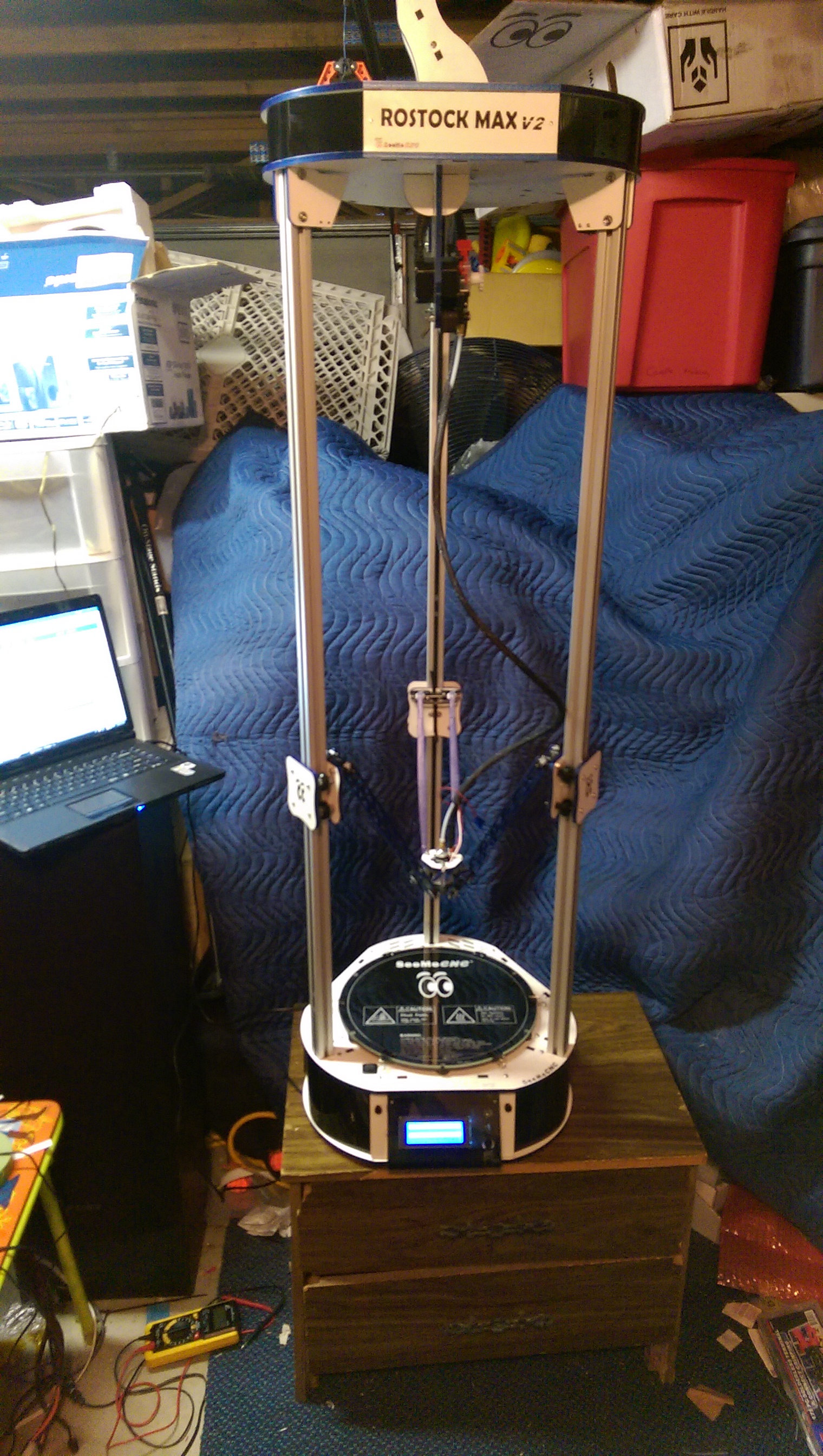

IT'S ALIVE.....kind of...
Well I got it built... but the y axis motor doesn't move. :(
I checked to make sure it was plugged in right, as well as the other way (just on the off chance it was wired back words...a guy can hope right!) but nothing.
the cold end motor doesnt seem to move either. I checked to make sure the wires were right and they are.
I even tried plugging it in to the Y axis and telling it to go to home and still no movement.
also in MatterControl my hot end is reporting 366c... what could cause that?
Re: FrznTek's R Max v2
Posted: Sat Mar 21, 2015 5:11 am
by teoman
I see your build is another one of those tight space builds.
Try connecting the motors that do not move to the outputs that do create movement. That way you can diagnose if it is a rambo problem or motor+wire problem.
Posted: Sat Mar 21, 2015 8:08 pm
by FrznTek
Thanks for the idea. They work , it must be a controller issue. I do remember the andrino software said something about low memory after I uploaded the firmware, and that it might cause glitches.
Posted: Sun Mar 22, 2015 1:55 am
by teoman
Try flashing the rambo again. I do not recall it complaining about memory.
Posted: Sun Mar 22, 2015 4:13 am
by FrznTek
I tried again, here is what it says... (BTW, it had no effect)
Posted: Sun Mar 22, 2015 9:07 am
by JFettig
Change your EEPROM clear from 512 to 4096 then run it, the memory is larger in this board than what that one is written for.
Posted: Sun Mar 22, 2015 5:18 pm
by FrznTek
just tried that, and it didn't help. :(
Posted: Mon Mar 23, 2015 12:55 am
by Colburn
I got the same message with mine the other day when building it. So far it runs fine, but I haven't run a large file yet. Also, did you try hooking a multimeter to the board when you try and run the failing motors?
Posted: Mon Mar 23, 2015 5:55 pm
by geneb
It's got nothing to do with the EEPROM clear size. The warning can be ignored.
Posted: Wed Mar 25, 2015 8:06 pm
by FrznTek
as for the low memory...
"I just spoke with John our resident Firmware GURU about the Low Memory notice is nothing to be concerned with. It is a notice that 70% or more of the memory has been used and is new to the 1.0.6 version of Ardunio that was recently released (which is why it is not mentioned in the manual)"
I sent a response on Monday to there email, so its been 2 full working days without a response which is a little out of character to the with in 24 hours during the work week I have had to this point.
Posted: Sun Mar 29, 2015 12:30 am
by FrznTek
They got back to me on Friday and had me test/look at some stuff.
I ran the clear eeprom, re-downloaded the firmware, made the motor change to "{155,155,155,165,0}" just like last time, and no change. (the Y axis still doesn't move when plugged in to the Y axis port.) the pins also look fine.
I plugged the Y motor into the second Z axis to see if all 3 would move and all three do indeed move, so it seems to me the Y port is the issue.
Posted: Sun Mar 29, 2015 3:08 pm
by Eaglezsoar
FrznTek, from the troubleshooting you have done, I must agree that the Y port on the Rambo is defective.
If not under warranty, you can send it to the manufacturer for repair.
I would pull out the Rambo and carefully inspect the circuitry for the Y axis port to make sure there is not a solder blob or
a break in one of the traces, however I doubt that you will find the problem. When you experience a loss of a port it is
usually one of the electronic components that fail.
Please let us know how you resolve this problem.
