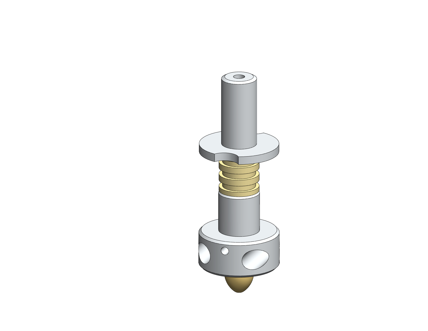

The extruder hot end is assembled, but required hi temp copper RTV silicone from autoparts store.

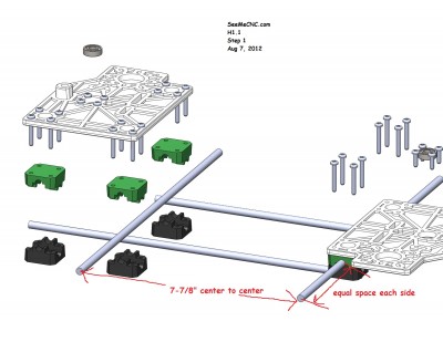

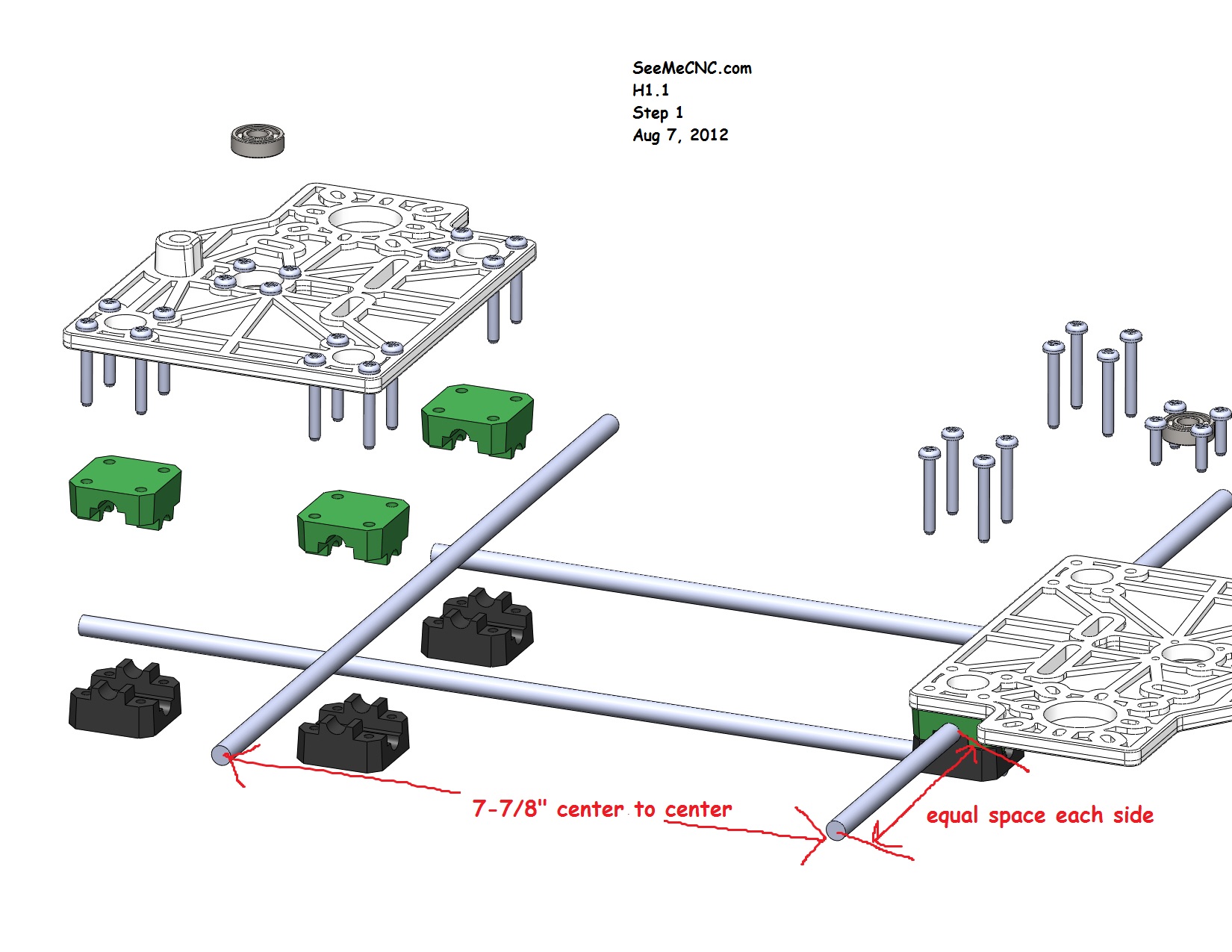

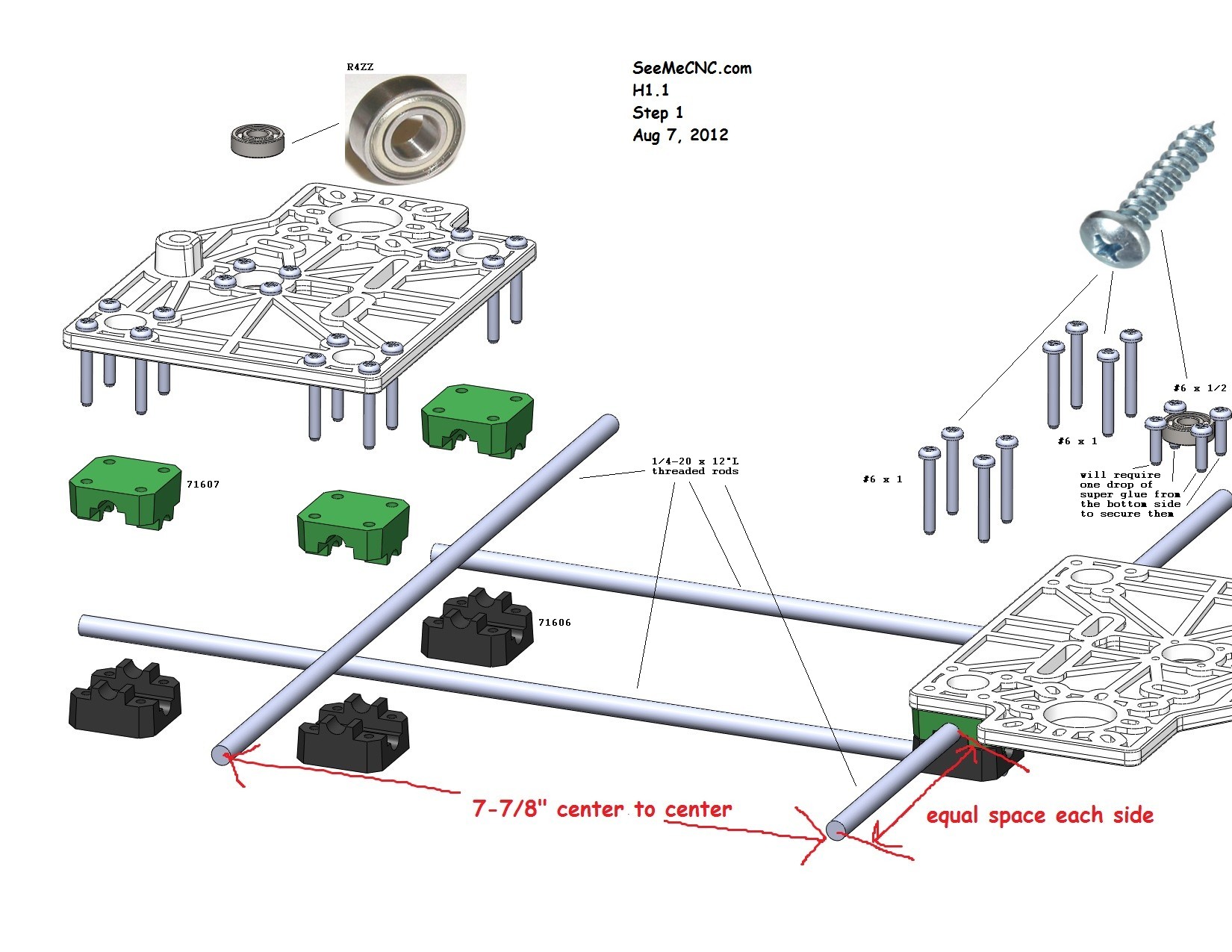

Machine Assembly:
Starting with the base of the machine. Orient parts as shown. The #6 x 1 sheet metal screws hold together cross bar clamps. All threaded rods are 1/4-20 x 12"L. R4ZZ ball bearing held in by #6 x 1/2" sheet metal screws and will require one drop of super glue from the bottom side to secure them.

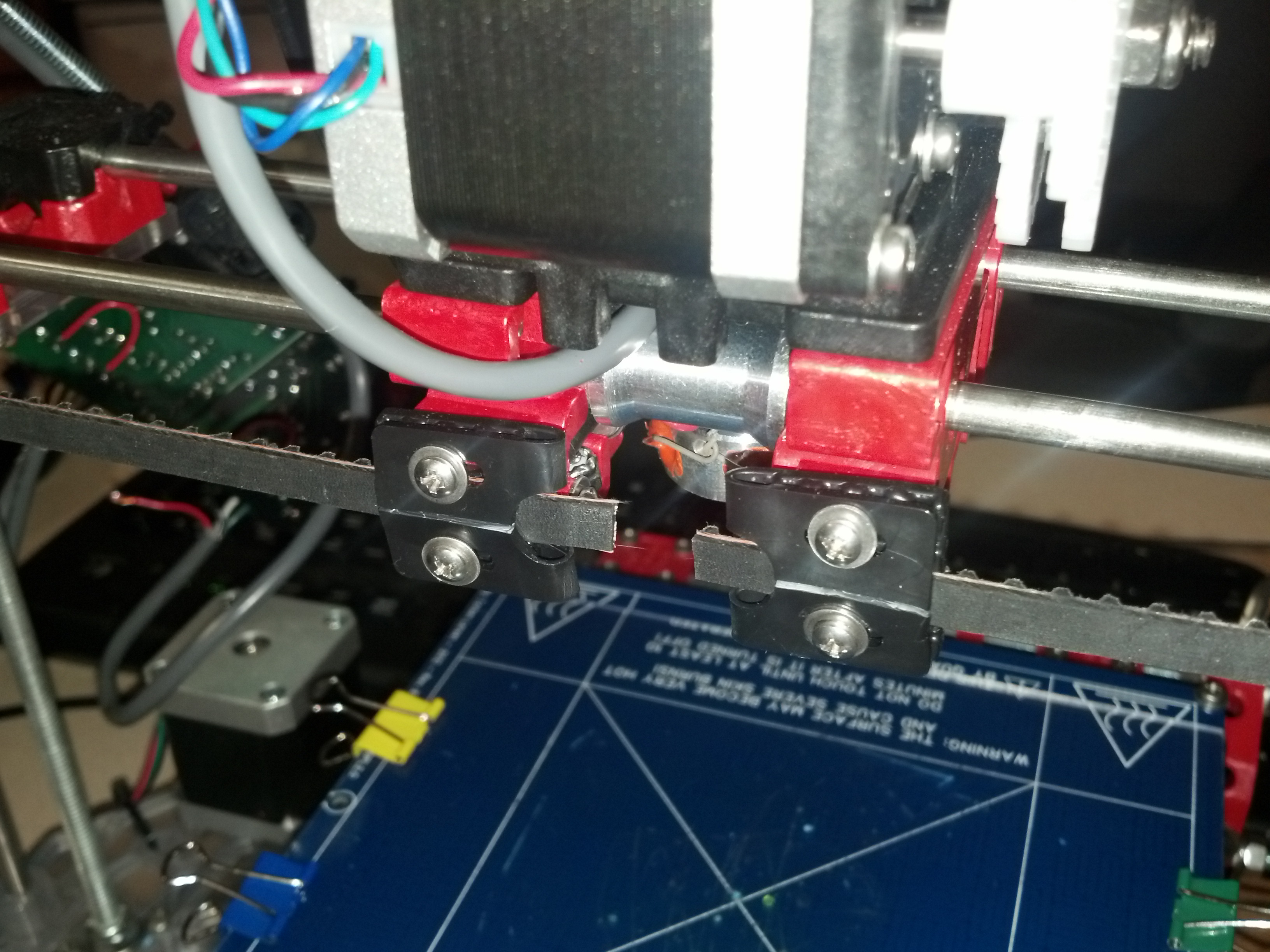

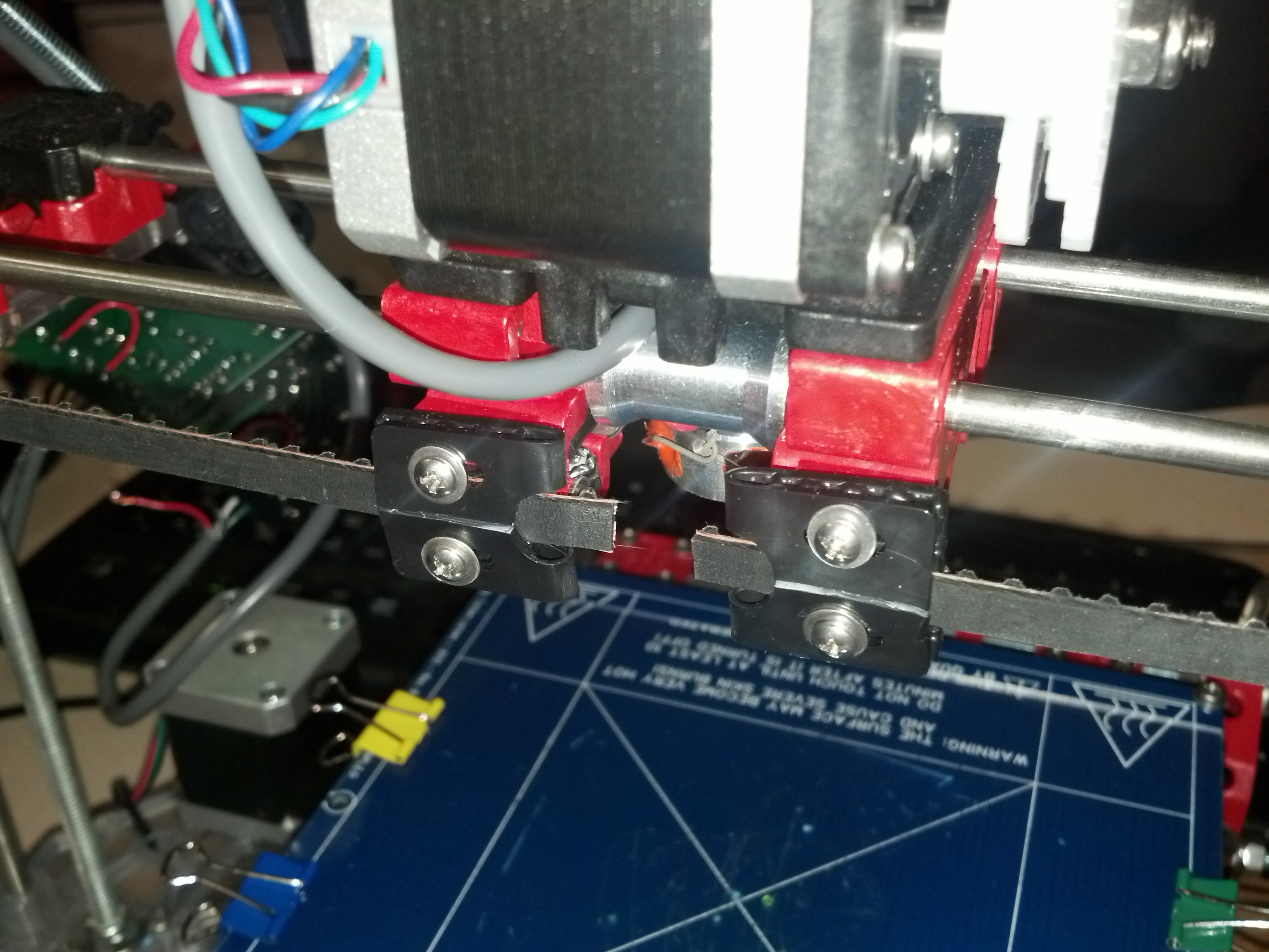

does anyone know how the belt clamps work?
jasco13
Posts: 67
Joined: Sun Jul 08, 2012 6:53 pm
Re: Couple Questions
Post by jasco13 »
They fold in half with two screws through them and belt in between. Toothed side of belt goes against toothed side of clamp

Post by AndGorew »
jasco13 wrote:They fold in half with two screws through them and belt in between. Toothed side of belt goes against toothed side of clamp
that works for the y axis belts but not for the x axis belts. There is no holes for the x axis belt clamps to be screwed to. do we have to drill those holes ourselves?
jasco13
Posts: 67
Post by jasco13 »
That is the only way I can see to do it. I looked at that for about 15 minutes last night trying to figure out another way and looking at the pics posted on the SeeMeCNC storefront site it looks like we will have to drill. Just hope I get it right the first time.

AndGorew
Posts: 30
Joined: Mon Mar 26, 2012 11:36 pm
Location: Springfield, Illinois
Post by AndGorew »
Doug we both mean drill 4 holes for the clamps to screw to instead of just the belts screwed to it. that way you dont have to worry about stretching out a hole in the belt
dougmsbbs
Posts: 32
Joined: Thu Jun 14, 2012 12:43 pm
Location: Goshen, Indiana
Post by dougmsbbs »
AndGorew wrote:Doug we both mean drill 4 holes for the clamps to screw to instead of just the belts screwed to it. that way you dont have to worry about stretching out a hole in the belt
Ahhh! I see now! :lol:

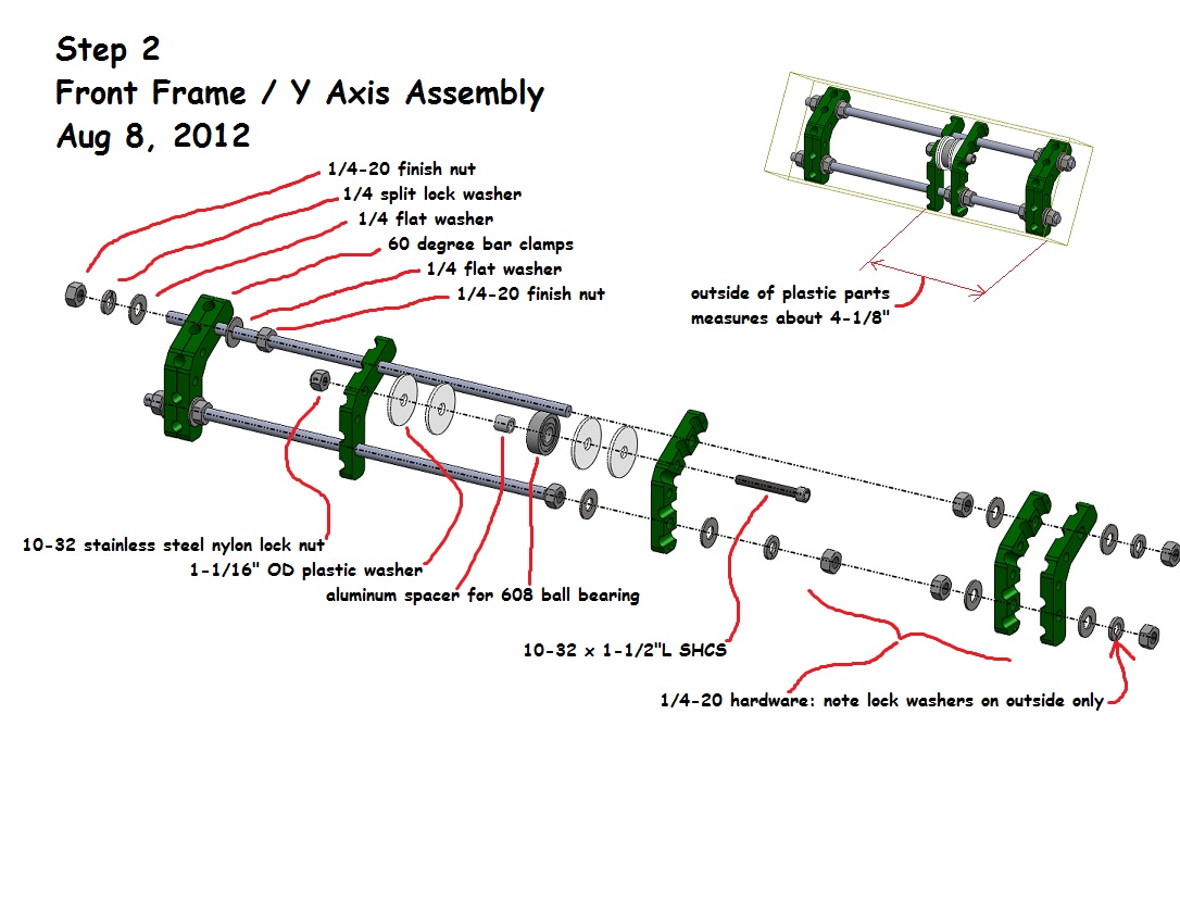

H1.1 Step 2

Here's a picture of the belt clamps of my own invention.
I recommend pre-drilling a 3/32 hole. 1/16 hole will work too.
The #4 x 1/2" sheet metal screws are for belt clamps (the length of screw is measured under the head of the screw, and as a side note, flat-head screw lengths are measured over-all length)
No1 screwdriver
do not over tighten
~PartDaddy

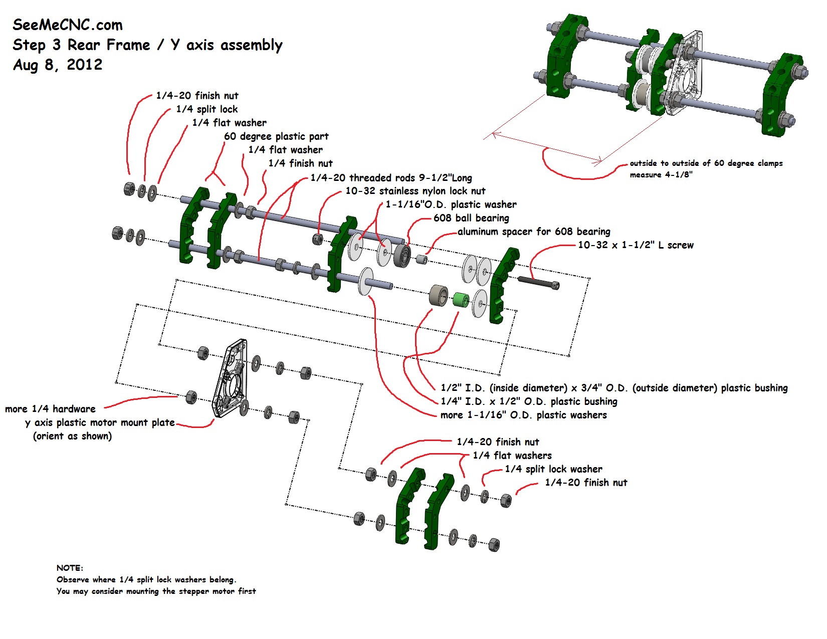

PartDaddy
Posts: 392
Post by PartDaddy »

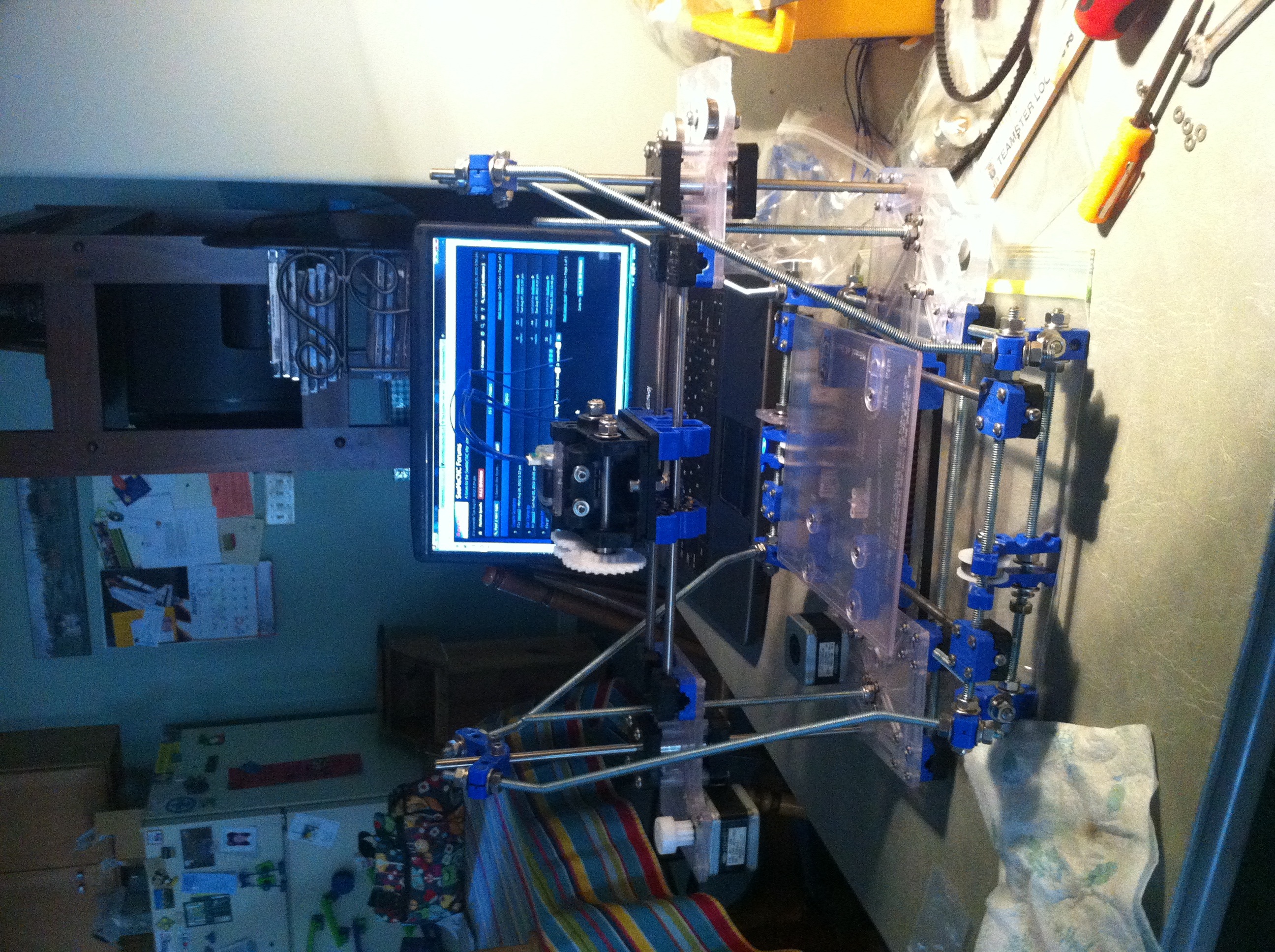

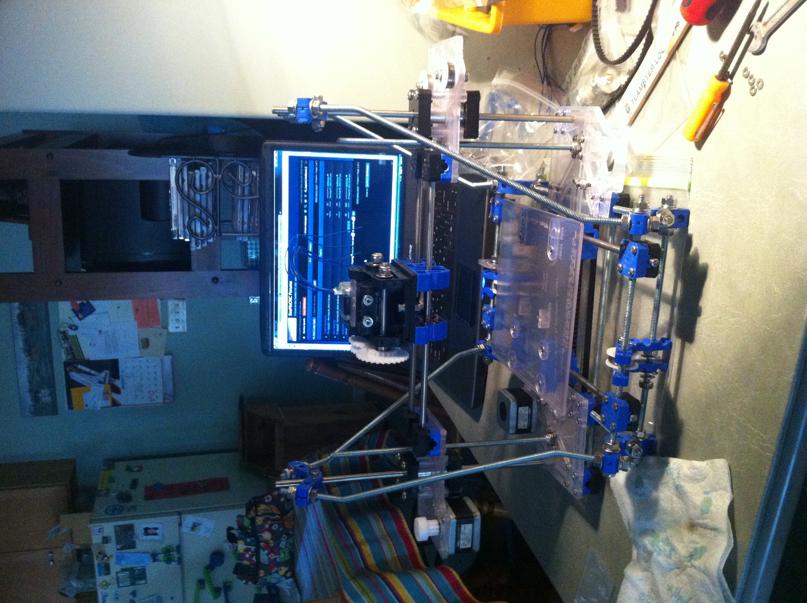

Mechanical Assembly Complete. Going to start on the wiring tomorrow. I've got races this weekend so probably won't have it up and running until next week, but I'm getting closer.
[img]http://i1267.photobucket.com/albums/jj5 ... C03190.jpg[/img]
