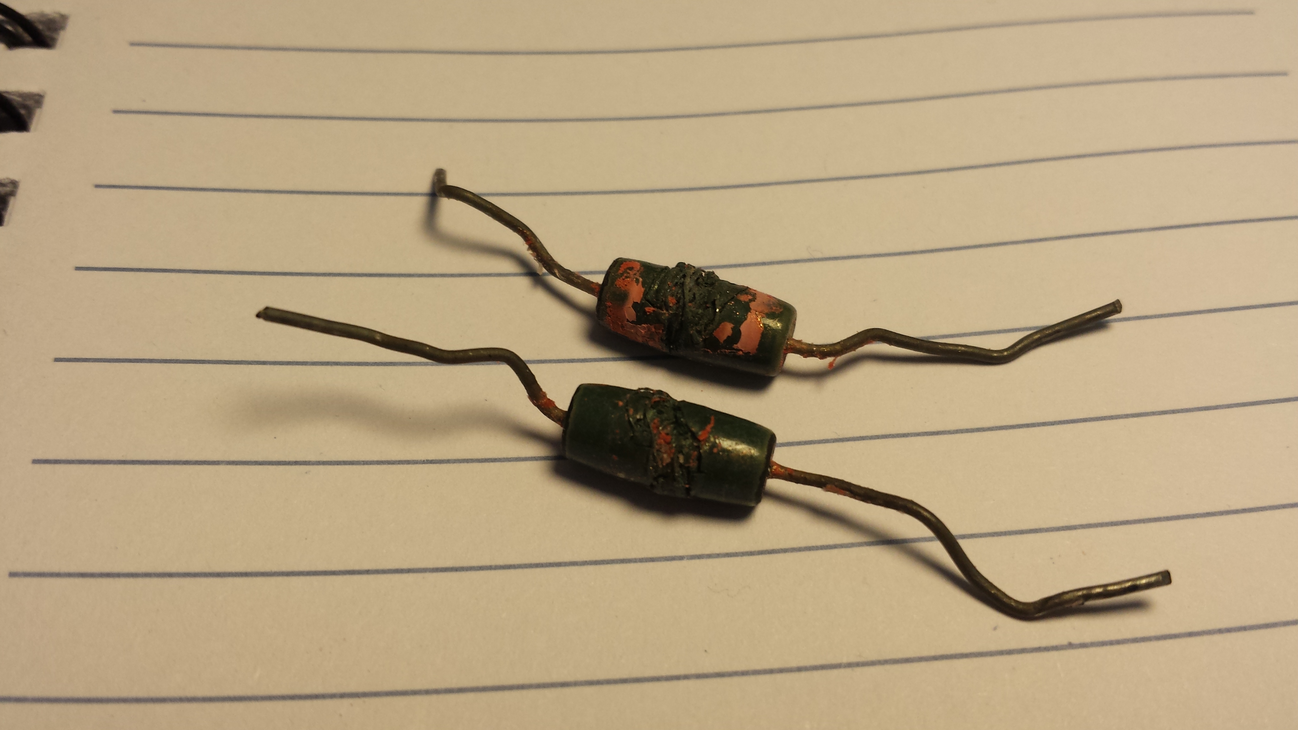

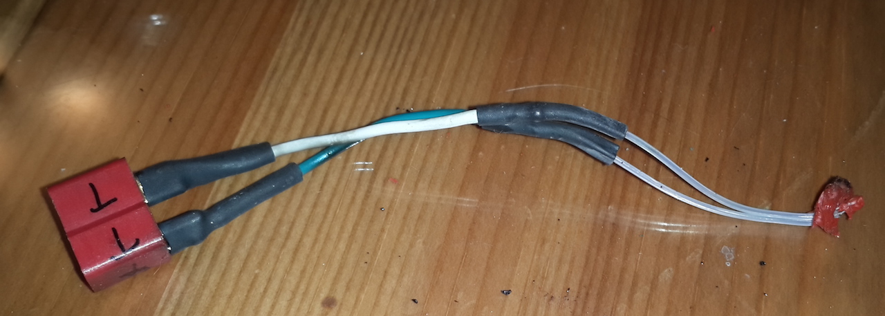

Thanks for the input... I've got it all to bits and the resistors came out easily with one side coming out pretty clean I just pulled out by hand and the RTV just crumbled.
Had to persuade the other side... but still pretty easy job.
I've decided just to fix my current hot end, I may go cartridge heater in the future or E3DV6 but fixing what I've got looks simple enough... hopefully I wont end up blowing my Rambo fuse or something else :roll:
Both resistors I've removed look chewed up, is this deliberate in house to help the RTV stick to the resistor or is it heat damage?
The upper resistor is indeed totally dead with the lower one working but reading higher Ohms than my spares, I also managed to kill my Thermistor (snapped the wire.. yeah fixable but the wires look in poor condition anyway) so I've ordered one of these from the UK as I'm in the UK and it's 3 weeks from the US.

Anyone know what amp rating the extruder wire is please?
Considering this as I'm making up a new loom:
http://www.ebay.co.uk/itm/High-Temperat ... 0988618670
But I seem to recall that the rating fro the cable is much higher than this?

Others will correct me if i am wrong, but in the rostock i remember it as being 22 AWG.
Also, if you get a heated cartridge it also comes with plenty of that wire.

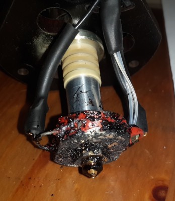

I was reading this thread the other day, and presto bingo, my extruder would not heat above 157 degs. I knew it was a bad resistor, so i decided to upgrade the thermistor and the resistor. I was never happy with the RTV application, in my opinion it is the only really cheesy part of the printer.
First part was removing the hotend.
I was lazy and i did not remove the filament, so just after removing the bowden tube, i cut the filament with a pair fo scissors.
Hot End Removed
Hot End Removed
The hotend is well used and a bit covered with burnt filament.

The resistors were fairly crumbly, and they were no longer surrounded with soft reddish RTV but rather a crumbly black substance.

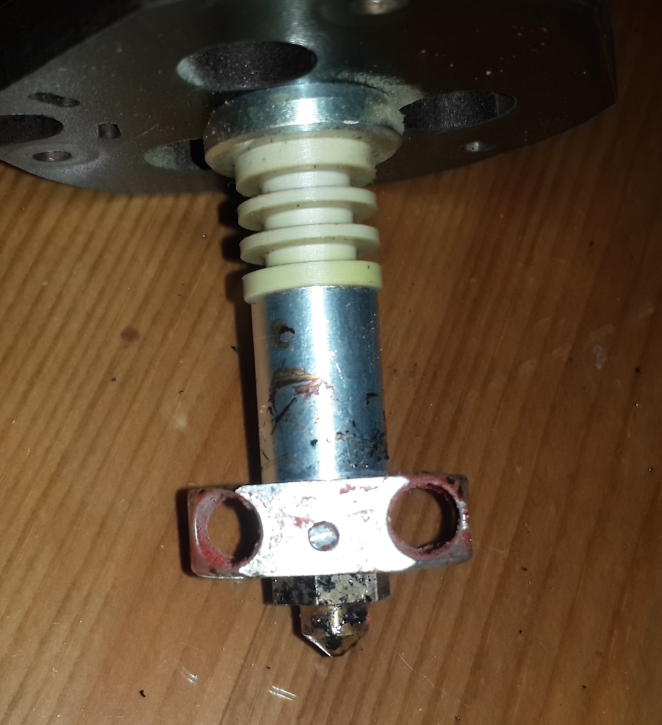

Then i used my hands and my nails to clean the hotend, rtv was rater easy to remove as it just crumbled off.
Cleaned hotend

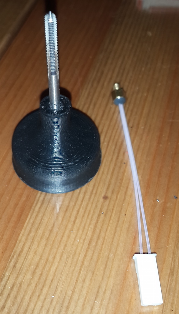

I then used a m3 tap to tap the hole for the thermistor, the hole did not need to be enlarged. I made the handle for the m3 tap myself.
M3 thermistor
M3 thermistor

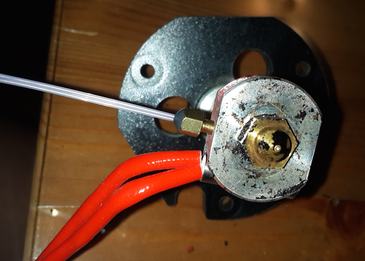

The hole in the aluminium in the hotend is not quite deep enough, so the resistor ended up prodruding slightly. But as it is a metal to metal connection i think that it should be ok. If anyone has bright ideas to remedy this i am all ears.
Thermistor in place
Thermistor in place
I then installed the provided connector the wires.
Connectors installed
Finally, i routed the wires through holes in the hotend. I did not use the groove to ziptie them to the side, i think that this makes a tidier setup.
Updated hotend top
Updated hotend top
Updated hotend bottom

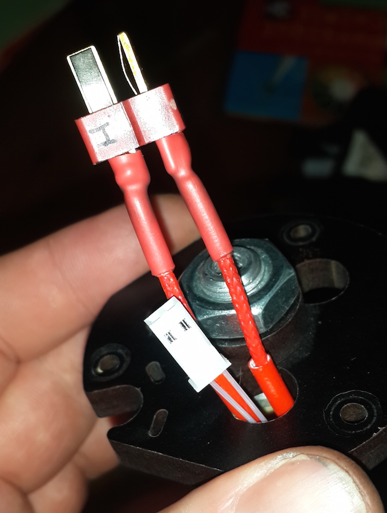

Well managed to get it all done and made up a new wiring loom which was both easier and harder than I was expecting.
Below is the list of things I used all sourced within the UK - I picked suppliers based on if they used Royal Mail as it was generally next day or +1.
Got a real find with this wiring for the Nozzle heaters, it's very nice double insulated stuff... the outer coating is only 200 DegC
but it's very impressive and much better than the standard wire IMO.

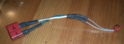

I cut the insulation off these crimps:
http://www.ebay.co.uk/itm/121163030670
I used these pre made up thermistor cables (which agree within 0.1 DegC of the original at room temp). So much better than messing around trying to solder or crimp the tiny gauge thermistor wire to another wire.... Not sure how it compares at 230 DegC but seem ok.
http://www.ebay.co.uk/itm/221613016131

Surprisingly it all worked first time and nothing blew up ;)
Main issue was a bit of white smoke from the resistors on first couple of heating cycles. Next time my resistors die i'll change to heater cartridge possibly try E3DV6.
Either way going to make a spare inc loom/hot end I can just swap out when the resistors do die... with the white smoke initially I'm wondering if I've messed up with the RTV
any maybe there are some air pockets and my resistors will have a short life. I was careful and took my time .. sure I packed it all out well but maybe not..
Also the PID tune isn't very good yet, P and D look spot on (in Repetier Host) but I need some manual tweaking outside of the MatterControl auto tune for I.
