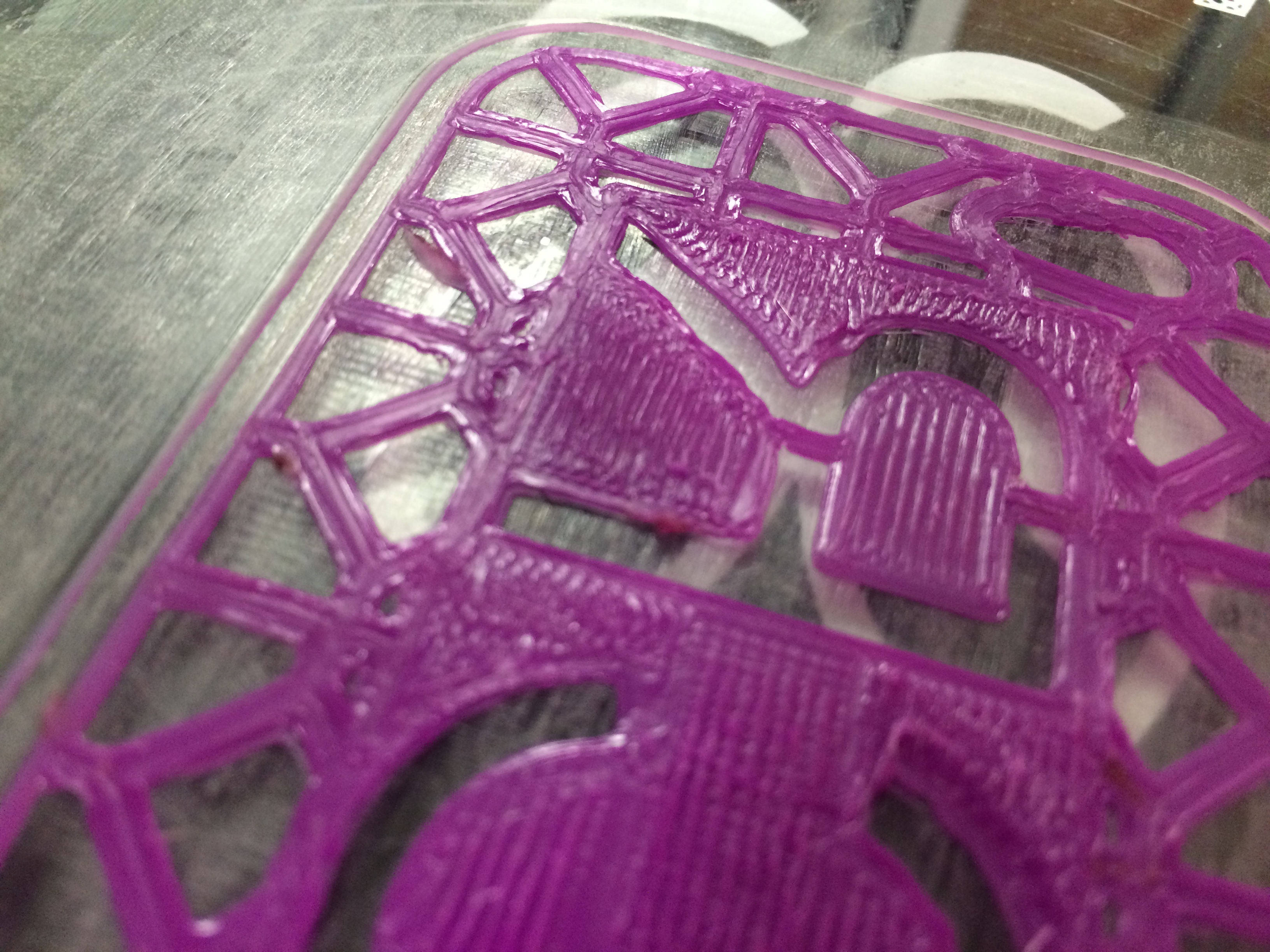

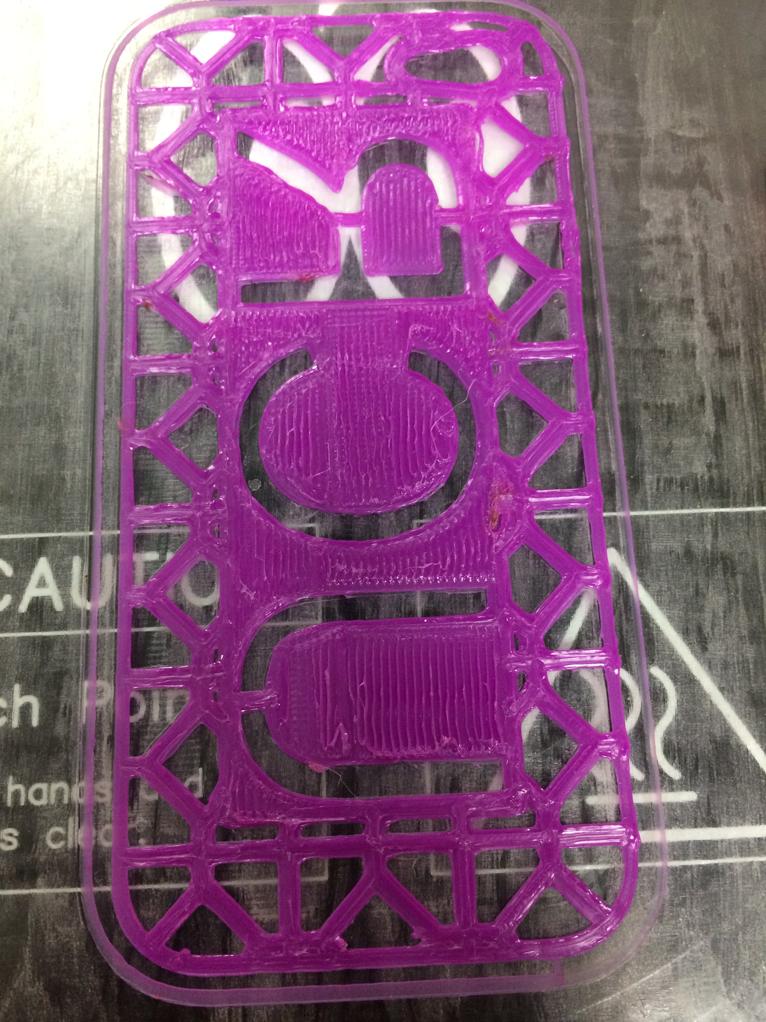

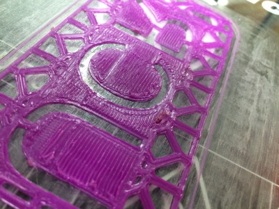

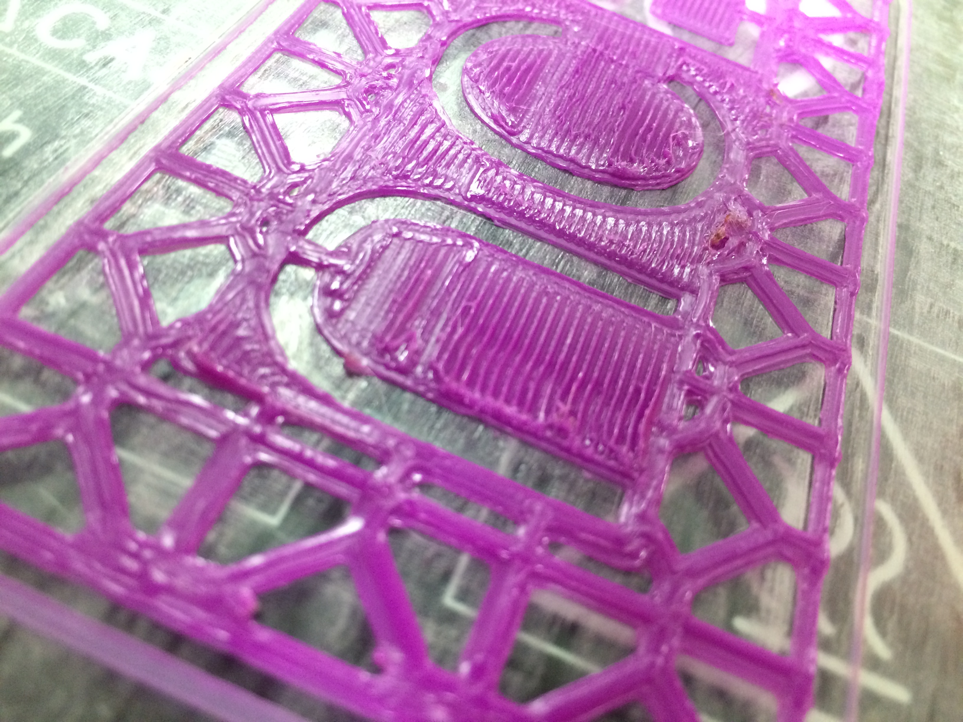

I have a Rostock Max V2 and I am trying to figure out why my first layer is making the mistake of running into the filament it is laying down. You will be able to see what I mean in the images.

little low on the first layer... easiest way is to adjust the first layer by your results...
on the lcd:
click the knob and go all the way down to advanced and click the knob.
go all the way down to calibrate z height and click the knob
click home
after the machine homes, click adjust z height
turn the knob counter clockwise to lower the nozzle, when you get closer to 0, turn the knob very slowly... turn it until it displays 0.10 mm and click the knob
click set z=0.00
if your first layer is still a little too squished, you can repeat this for another .1, .05, or whatever you need to dial it in...
this will make the nozzle for your first layer 0.1mm higher and not so squished... the knob can even go into the negative, so you can dial in your first layer how you want this way... (negative if you want the nozzle closer to the bed, positive for if you want the nozzle higher off the bed)

Thank you for your help. It worked out perfectly.
