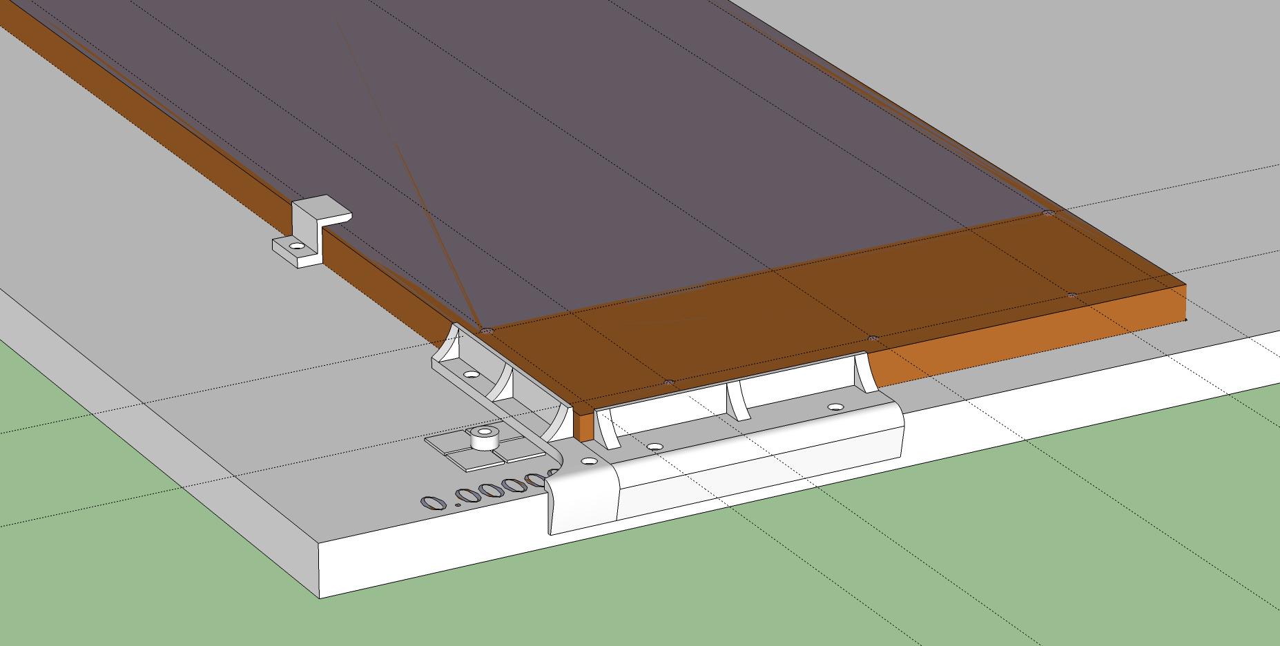

I'm routing some Baltic birch plywood, .68" thick and I think 13 plys, on a Probotix Meteor CNC machine. This job is not too fancy. A 3/8" center-cut end mill will drill a few holes, then plungebore a few 1/4" holes, and finally mill a few pockets. I keep hearing different stories about whether plywood should be routed with a conventional or climbing cut. For this particular application, which would be better - or does it even matter?
PS: Fixturing is fun! I'm going to post a thread later about how I got everything properly aligned. That definitely took some figuring out.
