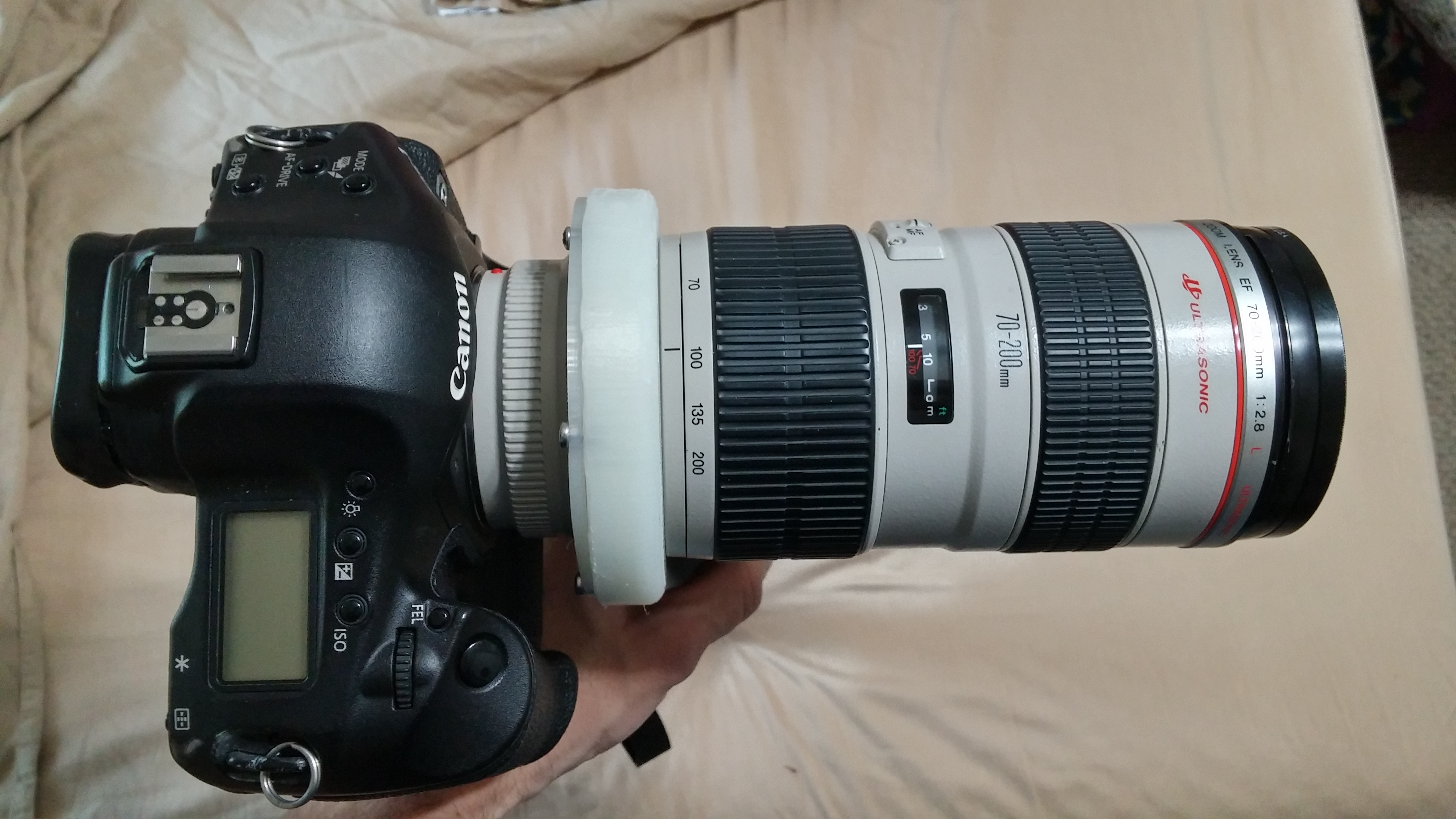

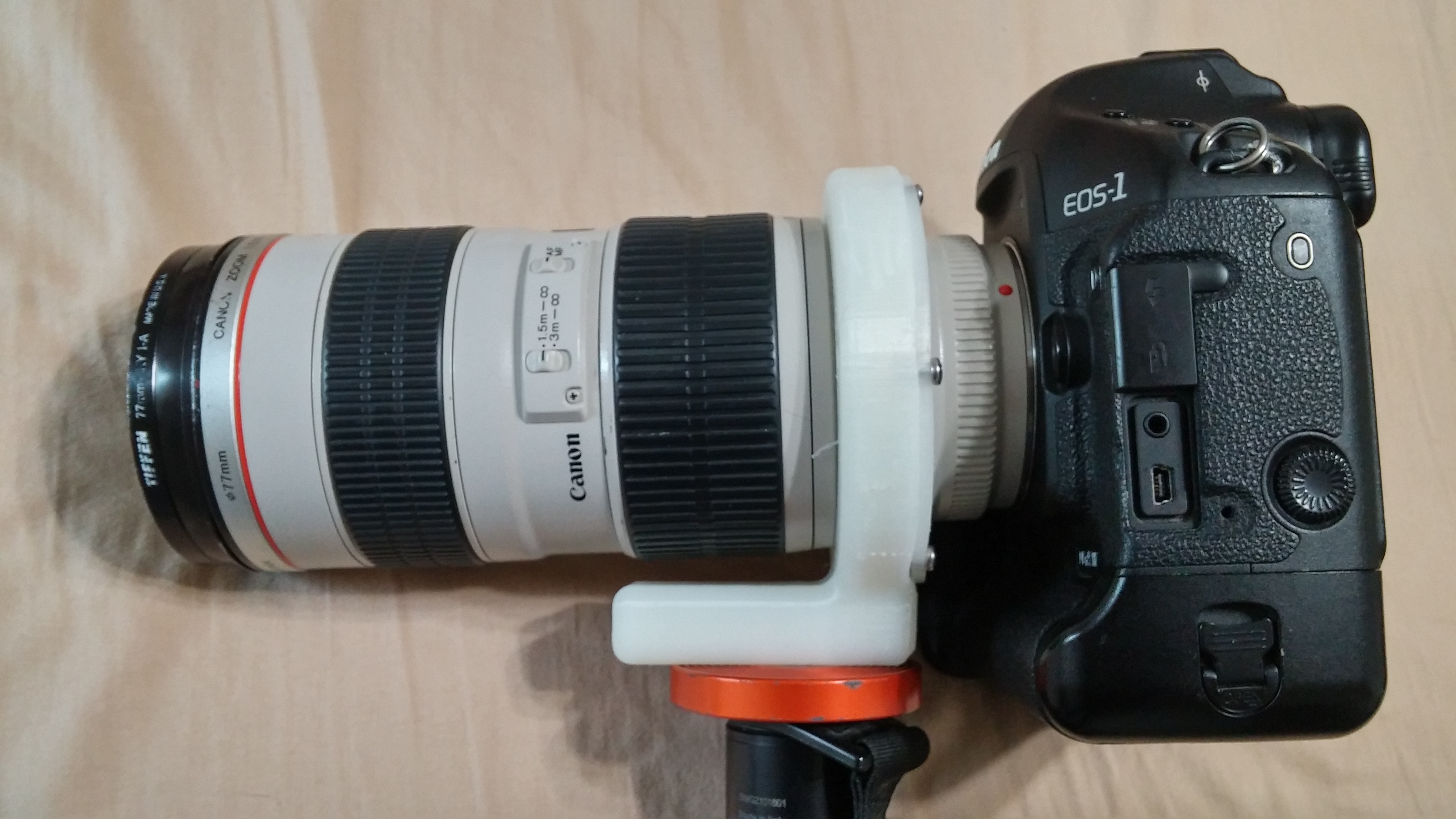

So I will keep the back story short here. As most might guess from my user name, I am a professional photographer. I shoot sports for a living and I travel pretty much every weekend 10 months out of the year. I shoot Canon gear (please no gear debates here) and I love it. But for one flaw. My largest client who keeps me on the road every weekend is a very unique style of sports photography which only uses a 70-200 2.8 lens. For the last 5 years I have been faced with a nagging issue. The canon lens has a flaw in the tripod mount on the lens used to mount to a monopod when shooting for 15+ hours a day. The design is pretty simple but flawed. It uses a set of four unevenly spaces screws with small brass bushings on them to ride inside of the tripod foot track/raceway to allow the lens to rotate and when turned just right, to remove the tripod mount foot from the lens by 4 cuts in the raceway wall which line up when turned just so, to allow the tripod mount to slide off the lens. Great in theory. But junk in practice really. Those same four small cunts in the raceway wall which allow the collar to be removed, also dent and deform the brass bushings mounted on the screws, which leads them to fail and they have a raw crew head digging into the collar raceway and seizing the lens rotation at the worst moment in an assignment. Each repair costs over $400 even with a Canon CPS Platinum level 30% discount and we do this repair 2-5 times a year. So enough was enough and I set out to replace the design as best I can... In short 3D printing and putting a $8,000+ plus camera rig at the mercy of a 3D printed prototype design before it is milled from aluminum on the CNC. Nylon 910 came out and i decided to give it a try after having found Bridge and a number of other nylons and other 3d filaments lacking for everything I needed, strength, lightweight, low COF for a bearing function, ease of printing and affordability. The design is still being refined but I have produced a prototype and I refine the design each weekend after shooting with it. So far the 910 has been truly amazing! It is super tough and takes post printing manual and CNC shaping very well with endmills, burrs and sanding discs as the design is refined and tweaked. Screws hold fast and tight in the 910 (printed solid) and supports and rafts are removed with very little effort or cleanup (though 910 is TOUGH and holds FAST if your supports are not planned well). So far the design ( a bearing ) has held up to everything I can throw at it for the normal usage I seek to replace from the stock Canon design. In the end the body will be Alca 5 tool plate aluminum with a 910 liner and 910 ring (mounted to lens) Here is a small snap shot of the first BETA mount which worked perfectly. It is made up of an inner 910 ring fixed to the lens, An outter body peice that surrounds the inner ring and a small ring plate that holds the inner ring in place to the outer body.
I know most of that makes little sense. The short version is this. the Canon design to rotate the lens about a axis is flawed and breaks all the time which costs over $400 to replace. This design removes the brass bushings in favor of a 3D printed 910 bearing. More pics to follow and CAD renders if anyone shows some interest in how the project is moving along. This is the very sort of thing I bought my MAX for, solving my real world issues with cutting edge filaments to rapidly prototype designs. This will save myself and all the 80+ sports shooters who work for me several thousand dollars a year and allow infield replacement of worn components as needed without the need for special tools or a service center.

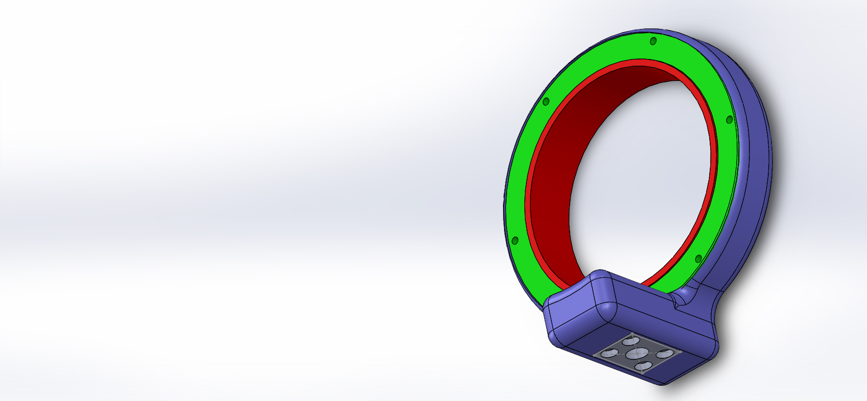

Anyway, that's pretty slick Photog. Are the different colors in the screen shot separate parts? Can we see an unassbled version of your design? I'm curious how it works.

Thanks guys for the feedback. I am on day 11 of 15+ hour shooting days on the lens bearing and it is still shooting like a dream. I am between shoots right now for the day so not able to address all the questions and comments above. But I proimise that I will address each in turn shortly. More photos will also come from the damaged lens and the flawed mount which causes all the issues so everyone will have a better idea of what the root issue was. I will also try to get some exploded model renders done so the inner workings of the bearing can be seen better also.
