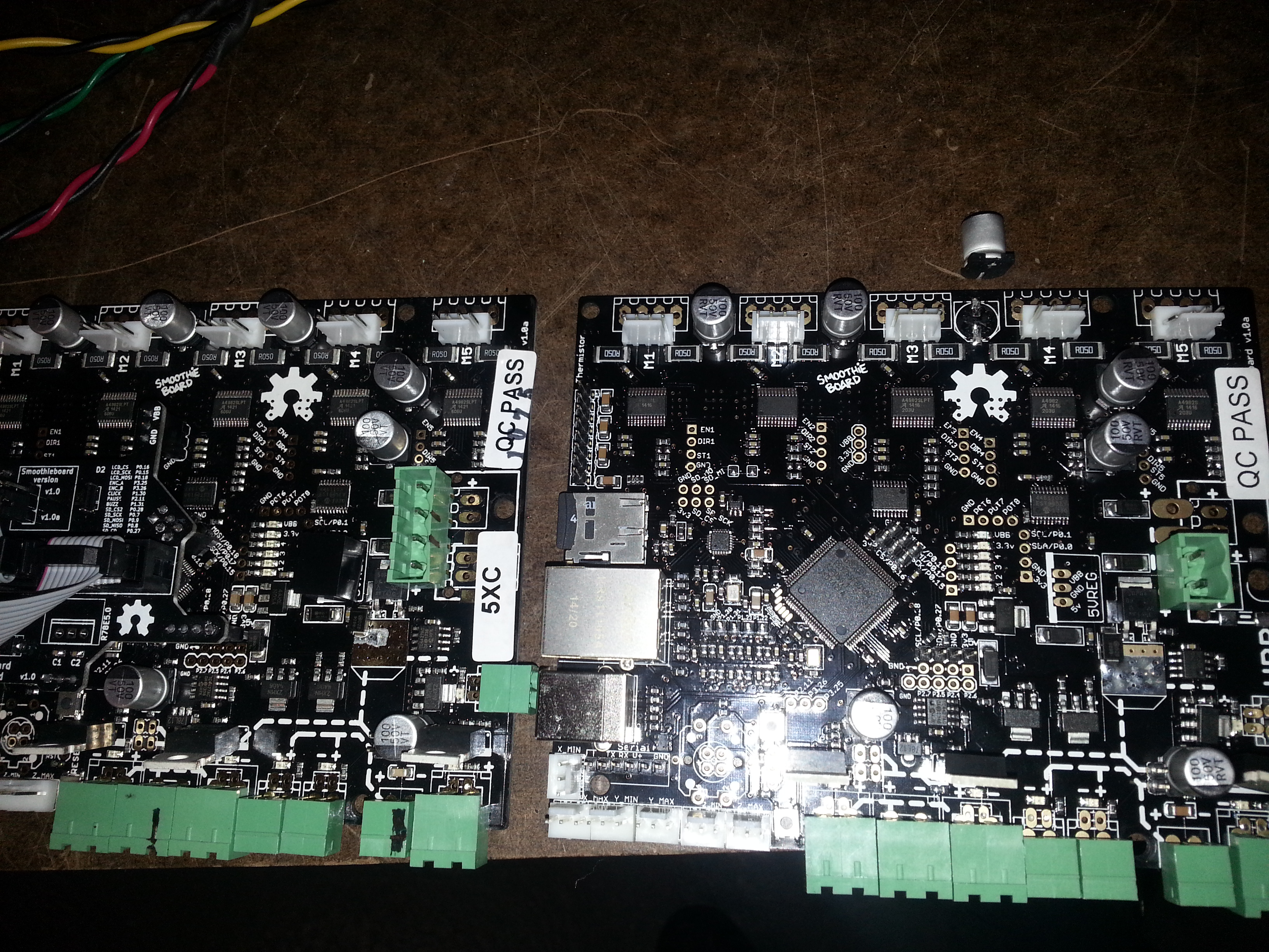

So it appears I have a dead smoothieboard. Been fighting with it for a week and cant get anything beside the 3.3v to light up.
I'm only using USB, but apparently I should be seeing 1,2,3, and 4 light up on the LEDs.

On power up (plug in usb) you should see 1,2,3,4 light up green one at a time then fast flashing. 3.3v should light up orange/red as well.

It's definitely dead. I get the 3.3v led only when using USB. None of my computers recognizes that anything is plugged in via usb.

Update: He is sending a replacement.
Re: Dead Smoothieboard
I promise if I wasn't so invested in the smoothieboard to work, Id tell everyone to avoid them like a plague.
Between them not shipping the GLCD with no communication, then receiving a dead board.. The replacement came today with a capacitor broken off and the 4x power header replaced with a 2x. But it has a QC Pass sticker, so I guess it's good to go.
Hopefully no other issues or surprises.

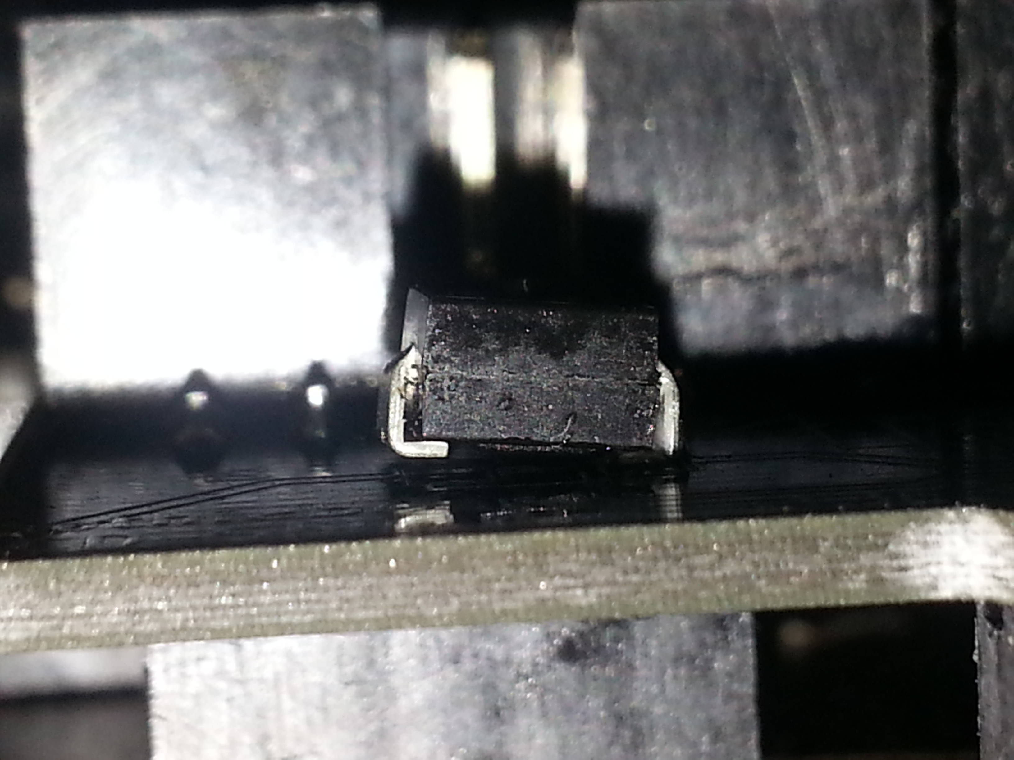

After an hour of trying to figure out why the LCD wouldn't turn on, noticed the GLCD shield had a lifted smd capacitor. I'm glad I at least have another set to compare...
