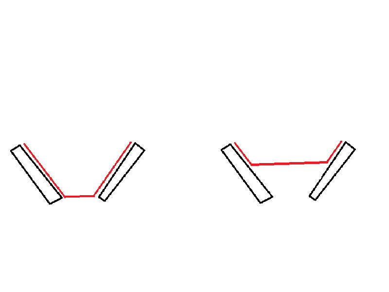

This is awesome! I too have the Prometheus and I love it! I started out by bolting the layer fan directly to the cooling fins since there was 3 unused tapped holes there, and it actually worked pretty well! Tipping 2 fans seems to be one of the most elegant solutions to the cooling problem. I'm really looking forward to your results with this setup KAS. I want to do it like this too.

It would be best to make a shroud - could be metal - to go around the heater block, in order to keep the breeze away. Don't mount it to the hot end itself - it will just act like a heat sink. Mount it to the effector, and leave enough clearance that it won't touch the heater block anywhere.
Another solution people have used is to wrap the hot end in silicone tape. It won't stop the heat loss (since it's touching the metal directly) - but it will slow it down.
Definitely don't use the hot end itself to mount the shroud or the fans. Leave it be.

I took alot of the information that you guys had come up with in this thread to design mine. It only used two fans like the Atom 2.0 for compactness and also to not have issues with the cooling fan getting in the way.
I have had really good success with it so far. I have 50 hours of prints on it, with a couple 12 hour prints.
One thing I should say is that if you use it, the fans need to be all the way in the mounts. I used a pair of large vice grips to get them in place. The fans are metal so your not going to damage them.
