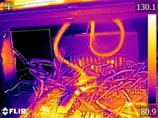

Just messing around with a FLIR E6.
If you want anything specific, just let me know. I'm working on getting video of the heat up.
Bed set to 60C. The outer rings overshoot a bit while the center plays catch up. This was taken without the glass on.
[img]http://i482.photobucket.com/albums/rr18 ... IR0003.jpg[/img]
[img]http://i482.photobucket.com/albums/rr18 ... IR0008.jpg[/img]
The stock wiring from the controller to the heated bed is not up to par for the job.
[img]http://i482.photobucket.com/albums/rr18 ... IR0006.jpg[/img]
[img]http://i482.photobucket.com/albums/rr18 ... IR0007.jpg[/img]

Very interesting - are you sure you're able to draw the conclusion that hot wires = insufficient gauge? Maybe the wires are hot because they're connected to something hot?

That's a good point, ill try to get another picture after this print. I'll let everything cool down and try to catch it heating up. Looking over my test video, it looks like the wires get hot from the controller side first; It's just not that clear to be definitive.
update:
It's been printing a while and temp saturated. Although you can see the two power wires going up to the hole. The middle is currently cooler than both ends. Just not sure if the connector side is pulling heat from the board.
[img]http://i482.photobucket.com/albums/rr18 ... IR0016.jpg[/img]

Okay, no doubt about it at all. The power wires to the bed light up well before the bed even hits 40c.
[img]http://i482.photobucket.com/albums/rr18 ... IR0022.jpg[/img]
[img]http://i482.photobucket.com/albums/rr18 ... IR0020.jpg[/img]
[img]http://i482.photobucket.com/albums/rr18 ... IR0021.jpg[/img]

I disagree about the stock wiring not being up to par, even if it's not up to your expectations. For the load involved, the wire is staying within a safe temperature in operation. Wire temperatures in the neighborhood of 50C aren't a problem...that's still cold enough to touch and hold with bare fingers.
18 AWG copper is about 6.5 Ω per 1000 feet at 25C. Temperature is a factor, so at 50C it's 7.1 Ω per 1000 feet. Either way, that's a very small resistance for the actual length involved in this case. Still you're putting a fair amount of current though it, Power = Current squared times Resistance, so even that tiny number means you're dropping a couple watts of heat into the two wires. Some wire heat above the ambient temperature of the electronics box is to be expected.
16 AWG is 4.1 Ω and 14 AWG is 2.6 Ω, per 1000 feet at 25C. So yes, upping the wire side will reduce the resistance and result in less heat generated in the wires. So it's a fine upgrade if you want to do it. It's just not required.

I'm not a electronics guy by any means. I just saw the wires heat up and didn't think that was optimal. Also, they get much hotter than 50c, that's just the hottest spot when I took that picture.
I just soldered 14awg 600v rated wire and they light up like a toaster as-well. Since I only measured ambient to 80c once on each wire size, I'd take these results with a grain of salt.
I'll have to agree with Eric and others, that no obvious benefit was made by changing 18awg to 14awg.

1) the wires are heating more than I would like. any power lost in the wires is power not heating the bed. Plus it will contribute to heating the connectors. I am finally upgrading to that 750W corsair today, I am going to upgrade those wires while I am at it.
2) The smoothie board was getting hot. while it looks all within spec, as an EE I try to avoid having that much heat on my boards, as it reduces reliability and life. A fan or directing more air over the smoothieboard is the solution.

That ball of hot mess is the 14awg solid wire from the smoothieboard to the Onyx bed. Also two separate power supply wires from the stock supply. The 14awg is to hard to work with so I'm going to try stranded 16awg next.
I'll also get the steppers( .9 degree installed and they appear to run cooler than stock), Extruder(stock), Hotend(prometheus), Onyx with & without glass, carbon fiber heat spreader and soon an aluminium spreader, also printing stuff.

Have you measured the temp of those wires after the bed is up to temp and its maintaining? I imagine it would depend on the temperature since mine holds about 95% power at 90C and less at lower temps.

JFettig wrote:Have you measured the temp of those wires after the bed is up to temp and its maintaining? I imagine it would depend on the temperature since mine holds about 95% power at 90C and less at lower temps.
I'll try that now since the bed is still hot.
16AWG stranded wire
[youtube]http://www.youtube.com/watch?v=8dTOWAZDyyU[/youtube]
edit: image of the bed sitting at 80c for about 20min everything inside is saturated with heat. It's hard to tell what's really happening because the FLIR automatically calibrates the color scale. While the wires look cooler, it's still in the upper ranges closer to the bed temp.
The transistor that controls the bed on the smoothieboard gets up to 80-90c. Is it normal to not put a heat-sink on something like that?

The outside ring of your bed doesn't get that hot, so the edge-on view is a poor indicator of bed temperature as well.
When you stick your hand in the video, it gives a nice thermal reference point. Surface temperature of your hand should be about 30-35C.
On Mosfets you'd need to check the datasheet for that part, but the upper temperature is usually over 120C. That said, if it's a through-hole part, heat sinks are easy to add, and putting one on the bed output can't hurt. Active cooling (fan moving air across board) is the other way to improve the situation.
