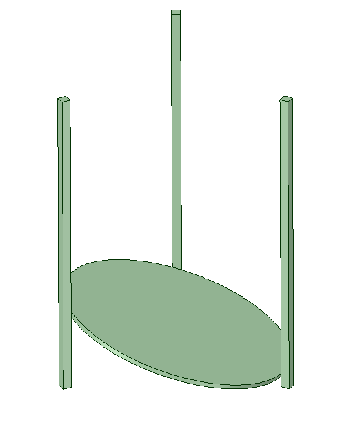

Let's say - just for giggles - that we have a print bed angled at 45 degrees relative to the towers (this is impossibly extreme and no one in real life would ever have this). The center of the print (a.k.a. the centerline of the print bed) on the first layer would still be pretty close to the center of the 3 towers. However once you get to the 100th layer, the center of the print would be nowhere near the center of the towers. It would be skewed way off in the direction that the print bed was angled.
I don't think any endstop adjustment could make the effector somehow "know" about that gigantic offset and compensate as it traveled to higher and higher print layers.
Of course this is a purely theoretical example and not exactly the same issue, but my point is that I believe there is a limit to what endstop and eeprom tweaks can fix before mechanical adjustment becomes necessary.
