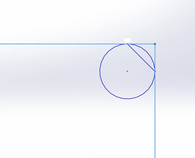

Re: Smoothieboard: Is it worth it?
I don't necessarily dislike it, I think the corner speed calculation is questionable on a 3D printer, makes a lot of sense for moving a heavy effector say on a mill, though there you'd want to actually cut the corner to maintain velocity.Jimustanguitar wrote: I also read recently that somebody didn't like the programming for how it computes its motion, but I don't know enough about that to repeat it well. Was that you, PolygonHell?
On an FDM printer for optimum quality you want to ideally maintain constant head speed, because plastic extrusion rate depends on pressure in the hotend, i.e. It doesn't start and stop immediately, so any variation in speed can lead to inconsistent plastic deposition.
The Jerk setting as it's used in most firmwares, as much as it is a hack, does a pretty good job of keeping you close to this ideal, and if you actually print at your jerk setting, it pretty much is the ideal.
Smoothie varies the junction speed based on a supplied constant and the angle between the incoming and outgoing motion, using some approximation for centripetal acceleration. If that calculated cornering speed gets too low, you can end up with over extrusion at sharp corners, as the print head spends too much time there and the pressure doesn't decrease fast enough.
Having said that there is nothing inherently worse in this approximation, and if it lets you increase your acceleration enough it might actually be a win, it's just hard to say for sure, and intuitively I'm not convinced the more complex algorithm is better for machines with lightweight effectors.
I own 2 smoothie boards, one on a Kossel, which is running a very old version of the firmware, and one in a box I bought to upgrade the RMax and have never gotten around to installing.
Just was poking through the smoothie firmware config options page (http://smoothieware.org/configuration-options) and found this:Polygonhell wrote:I don't necessarily dislike it, I think the corner speed calculation is questionable on a 3D printer, makes a lot of sense for moving a heavy effector say on a mill, though there you'd want to actually cut the corner to maintain velocity.Jimustanguitar wrote: I also read recently that somebody didn't like the programming for how it computes its motion, but I don't know enough about that to repeat it well. Was that you, PolygonHell?
junction_deviation - 0.05 Similar to the old "max_jerk", in millimeters. Defines how much the machine slows down when decelerating proportional to the vector angle of change of direction. See here and here. Lower values mean being more careful, higher values means being faster and have more jerk
would this be the jerk setting you are talking about?
Also, I found the acceleration setting
acceleration 3000 Acceleration in millimetres/second/second. Higher values make your machine faster and shakier, lower values make your machine slower and sturdier. This is generally proportional to the weight of the tool you are trying to move.
Yes smoothie replaces what was "Jerk" which is not jerk in the mathematical sense but rather a way to encapsulate allowed instantaneous changes in velocity, with junction_deviation which in effect assumes the corner is cut by following a circle that touched both the incoming and outgoing edge, and has a radius such that the maximum deviation from the intended path is the specified value. The actual junction velocity is them limited such that the cetripetal of this theoretical acceleration does not exceed the set acceleration.junction_deviation - 0.05 Similar to the old "max_jerk", in millimeters.
The reason I'm not convinced by this, is two fold, the first is that the cornering velocity is now dependent on the angle of the incoming and outgoing paths, which means the tighter the corner the slower the motion, this means your printer will deposit too much plastic at tight corners, the second is I think the argument that this calculation is based on some physical reality is specious. If the firmware actually did cut the corner which is what high end motion controllers do then yes it's a good approximation, but all it's really doing is applying a heuristic based on the dot product of the in and out vectors.
It will likely allow you to increase acceleration over what the old "Jerk" setting would, but it's hard to know if it's an actual win.
As I said on a mill it makes a lot of sense, because the inertia would force you to pretty much set jerk to 0, so the new calculation is a clear win, but Printers are not mills in general the effector mass is tiny. I've built axis for printers where you can reliably instantaneously transition to 100+mm/s at a 180 degree transition points.
- Generic Default
- Posts: 554
I'm just wondering about that junction deviation thing. In the picture above, suppose the nozzle of the printer is supposed to trace the square corner exactly. Would Smoothie make it trace the curved path or the diagonal path as junction deviation? I'm assuming that setting junction deviation to 0 would either cause an error or make the machine decelerate to zero velocity and then re-accelerate to full velocity on the new vector. Is that how it works?
Check out the Tri hotend!
I believe it traces the original path exactly, BUT, it restricts the velocity as if it were following the curve.
The idea is that it's a better approximation than Jerk.
