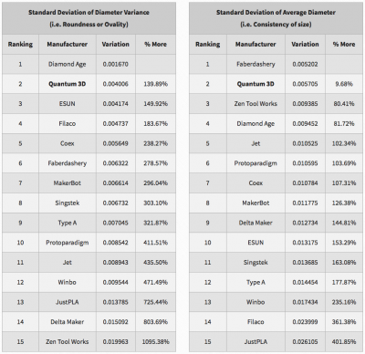

There was a guy on this forum the other day from Quantum3d, a US supplier. I found this interesting chart on their website. If their tolerances are that good, I might just have to try it. Looks to be $30 a roll. Has anyone used their stuff?
The other top performers are from the UK and New Zealand.

I got a test sample from quantum 3d. Testing my calipers on it showed very little variation, which is good. Unfortunately I couldn't get a good print out of it. Maybe it has special temperature requirements or something but it didn't print the stuff I usually print very well at all.
