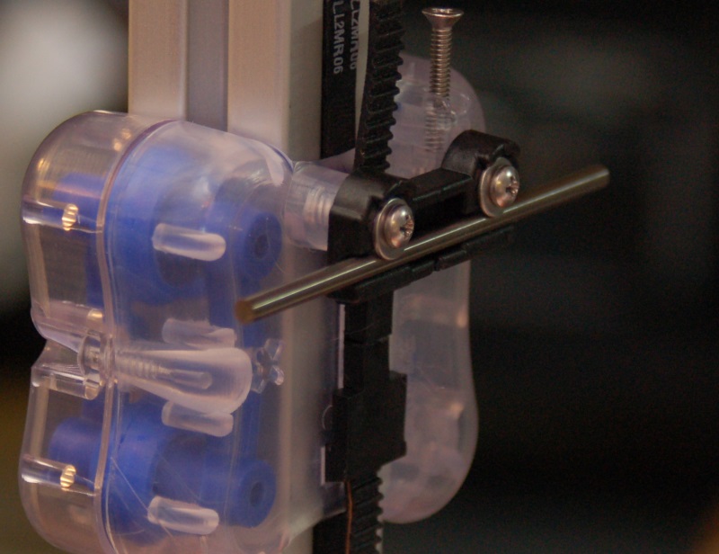

They're heeeeeere!
Posts: 5359
They're heeeeeere!
Muahahahahahha! *spindles moustache*
:D
Re: They're heeeeeere!
It looks as though it could start talking any minute.
Posts: 5359
It's mumbling, "Self-adjusting I am...yes...."
geneb wrote:It's mumbling, "Self-adjusting I am...yes...."
I wish I could self adjust!
Posts: 5359
We could screw some R4 bearings and a spring clip to you, but I doubt it would work. :)

Yeah I saw the front page RMV2 and was like: "Wait a minute..." Very cool-looking and practical to boot. Does the $900 sale from Matterhackers include the kits with the new cheapskates? Any more changes to the bots? All metal hot end that is ninjaflex-capable anyone? I recall a mention of using something other than binder clips to clamp the bed. New firmware?
Any news you can share? Do tell.
Posts: 5359
If the stock MatterHackers has was boxed & shipped after Wednesday the 22nd, they may have the new carriages.
As to the rest... I could discuss it, but then I'd have to kill you and there's WAY too much paperwork involved for me to do that. :D

This looks cool, but what is it I'm looking at? Is it just a new cheapskate carriage? Part of a Max v3? The final piece of the Eris puzzle?
EL Cuajinais
Posts: 96
Joined: Wed Feb 18, 2015 9:09 am
Post by EL Cuajinais »
My guess is all of the above. The RMV2 will ship with these new carriages. If you look at the SeeMee main page you can see the RMV2 is already showing this new carriage. I think when there are a couple of more upgrades like this one they will up the version number to V3.

Posts: 5359
They've been working on the new carriages for quite a while. The win here is two fold - first, the part count is WAY down. From around 17 to around 9. Secondly, you don't have to fiddle with adjusting them. There's a pivoting spring arm inside that keeps two of the sleeved R4 bearings at a constant force against the tower. The new belt clamps are a breeze to install as well. No fuss, no muss.
When they get around to updating the downloads page with the 3rd Edition (358 pages folks!), you can see how they go together. (I should note that the 3rd edition does NOT mean a v3 machine! It's just a big content update at the end and some feedback based tweaks [as well as the new carriage instructions])

geneb wrote: Secondly, you don't have to fiddle with adjusting them. There's a pivoting spring arm inside that keeps two of the sleeved R4 bearings at a constant force against the tower.
I'm sure the guys at SeeMeCNC have fully tested this (and the springs are probably quite stiff to compensate), but I'd be a bit worried that during a fast acceleration you could make the spring compress slightly, increasing error at the nozzle. Personally, I can't imagine replacing my Trick Laser carriages with anything else because they work great. They are solid, small, light, extremely smooth, and easy to adjust. Over the original V1 carriages though, I'm sure these new self adjusting ones are a huge upgrade just like the Trick Laser carriages were for me.
Posts: 5359
The spring arm only compresses when force is applied horizontally. If it compresses during vertical stress that means your Rostock MAX is experiencing a violent rapid disassembly event. :)
