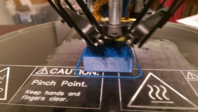

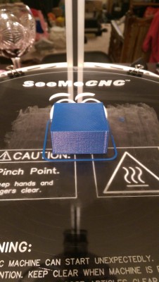

Posted: Fri Aug 07, 2015 9:33 am
by cyber.shifter
The prints actually aren't that bad. Here's a couple pictures.
Cubish object in print.
Finished
Finished
Re: Off-Center Nozzle during calibration
Posted: Fri Aug 07, 2015 10:16 am
by BenTheRighteous
Well that looks pretty damn good!
Are you totally, positively convinced that you've actually got a problem, and this isn't some trivial mistake like your script is actually sending your nozzle to 7,9,0 or something instead of 0,0,0?
It's hard for me to tell from your pictures but just by me trying to eyeball it, that looks pretty centered.
Posted: Fri Aug 07, 2015 2:32 pm
by cyber.shifter
The center of the bed on the X-axis is centered between the two white boxes around the caution warnings, if that helps you see how much it is off. Also, the dimensions are off by a bit over half a mm over the whole 20mm of height. The reason it really is a problem right now is is because I'm trying to print a square object that will be at the print area edge. If it's not centered, part of the left side won't print. I didn't think about the script thing, but this is happening when I use the on-board functions of the machine to drop the Z-height for calibration. So maybe it could be something in the firmware?
