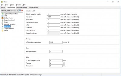

So I am trying to dial in my new printer. I have the files for Materials and Quality that were linked to in the instructions. I've got my bed very square and set my Z height to Zero using a .051 mm (.002 in) feeler gauge.
I'm trying to really dial in the first layer right now. My problem is I seem to be going down a rabbit hole. I know I should only change one setting at a time. My questions are as follows:
1=In order to get the most accurate height of on a print I would think that my Z height should actually be set to true "0.000 mm". Am I wrong and if so will the .051 mm be an acceptable height?
2=What is the difference in the slicer settings for Print>Layers/Perameters>First Layer Height (in mm or %) and Print>Advanced>First Layer (in mm or %)?
3=Why would it give me the option of %?
4=Is my extruder nozzle .5 mm? If you where going to create a test cube would .5 mm walls be achievable? (I've tried and at first my walls were 1.05-1.1 mm thick, I changed my Extrusion factor to .8 and recieved a .8-.88 mm wall thickness). Now I cant get a first layer to lay down.
Also the overall dimensions of my cube were really close other than a height of 9.8-9.88 mm, when it was suppose to be 10mm.
Thank you for any input!

1) For starters, .051 mm is .002 inches, not .02. With the other potential sources of error, you're not likely to ever see that. Z height is one of the things with which you can experiment to get print quality you like and a suitable amount of adhesion for your specific material on your specific print surface. If Z is set at true 0, it won't be very tolerant of overextrusion on the first layer and may sometimes have excessive bed adhesion, making parts difficult to remove (and it also won't be very tolerant of high spots on the bed).

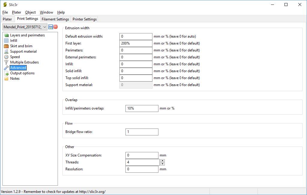

2) You don't say if you're running this through MC (which I never have), but in native Slic3r, there's a box in the Advanced menu around several of the settings identifying them as Extrusion Widths. Beyond the obvious difference, First Layer Height, if expressed as a percentage, is computed against the default Layer Height, but First Layer Extrusion Width, if expressed as a percentage, is computed against the First Layer Height.
3) See answer to (2).
4) The standard Max v2 nozzle is indeed .5mm. If you leave the extrusion widths on automatic, they will by default be set wider than the nozzle. In order to extrude a suitable amount of plastic for a single-width wall you probably need to manually set the perimeters width to conform, and such a narrow extrudate probably would need a very accurate, true Z=0 to adhere.

Here's the Advanced menu in a native copy of Slic3r. See the box around the first 8 settings?
When I've done a test cube for extrusion width, I've made it a single nozzle width wall and manually set my perimeter widths to match in the slicer.
