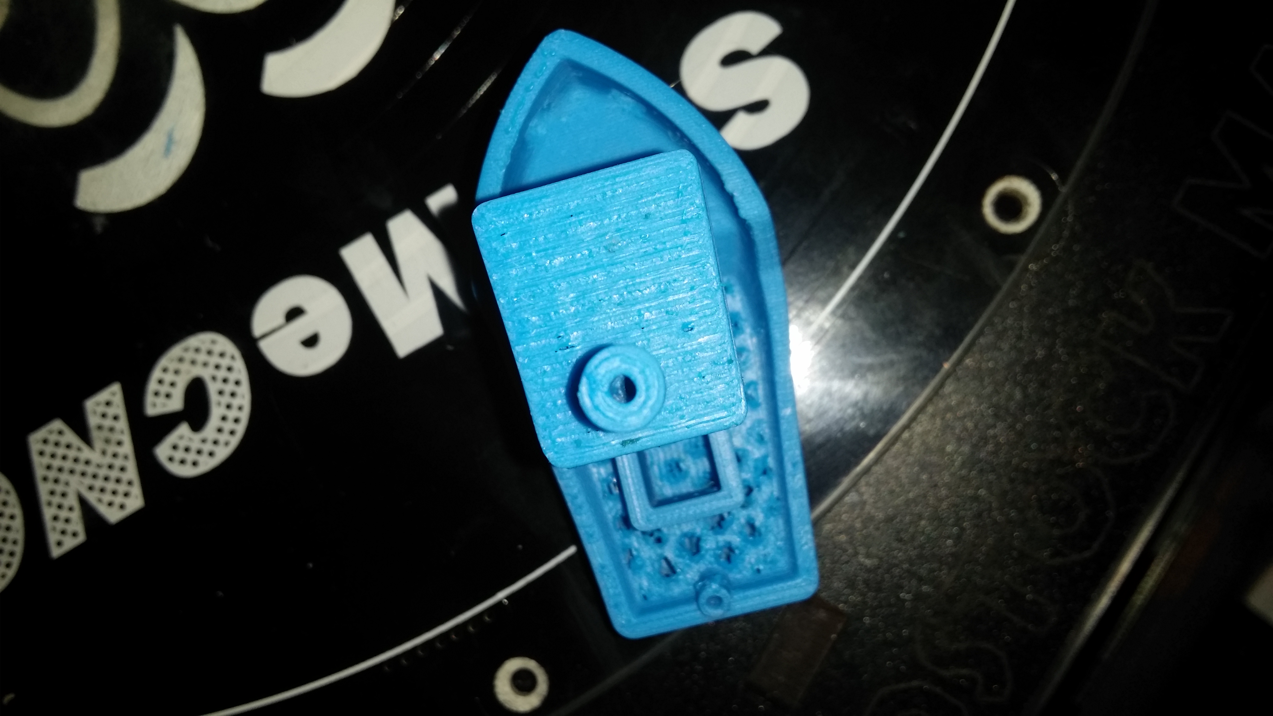

These dots have been showing up on a few prints, any reason?
Picture of the issue

I'm printing with abs it days either add a cooling fan or increase top layer higher. I thought it was frowned upon to print abs with a fan
Re: Improving benchy print?
You can use a fan with ABS, but you have to do it cautiously so that you don't warp and delaminate the layers.
Increasing the number of solid top layers would definitely be the first thing to try. Go for 3 as a general minimum.
