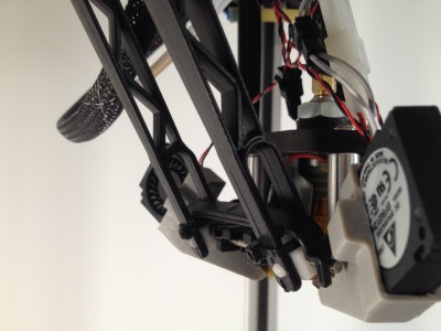

So been talking on #reprap trying to work through some issues. I've replaced my hot end with a genuine j-head with a .4 nozzle. Currently I'm trying to print with ABS running my hot end at 230c and the bed at 100c. I'm having issues with infill it never seems to work quite right when it's at a lower infill setting. At like 60%+ it looks good, at 10% it looks terrible, lots of gaps and such. I've gone through the fine tuning e-steps process but I can't seem to get it down. Also there is a weird pattern in the top/bottom layers that's sort of in the shape of a cross that goes across the piece, in the corners where the cross aren't it's less smooth, and in the cross areas it's more smooth? I was told to print a hex tower to verify I was printing correctly and it seems that I am. Also there is a bit of wiggle on my effector that some of the guys seem to think isn't normal? I took a picture of it, they told me to ask here if this is normal.

Yeah, fairly normal. Put some zip ties around the arms right where they meet the acetal joint, to clamp the prongs down onto the acetal. Not too hard, but just enough that they can't bend away from the joint. Helps tremendously with this.

Got a pic of what you mean?

I did what he said. My effector is not wiggle free but it's better than before.

I'll try that. Apparently with the older traxxas ball joint type connectors there wasn't this much play. Which imo kind of sucks considering I'm sure they went injection molded for cost.

Actually, I meant more like this:
but either/both work to varying degrees.

You're better off with it like Tincho85 did it, but use rubber bands instead. Wire ties are too static and too easily over-tightened.
None of the Rostock MAX printers have used ball joint arms out of the box. The ball joint arms are produced by Trick Laser and are very good. I've got them on two of my machines.
I strongly suspect your issue is a slicing problem and not a hardware problem. My oldest machine (See my avatar) is configured just like yours - stock arms and a Reifsnyder Precision Works .4 J-Head (if you didn't get it from RPW, it's a cheap-ass Chinese clone and those f*ckers are killing his business, literally.) and I've been running that poor machine ragged for the past two weeks. Performs flawlessly. Just like yours. the effector will jiggle like an epileptic fat kid in an earthquake, but that doesn't seem to have any adverse effect on the printed output.
If you've got the old style carriages, make sure they're properly adjusted - better yet, just get a set of the new injection molded carriages - they're light years ahead of the old design and don't have to be adjusted.
