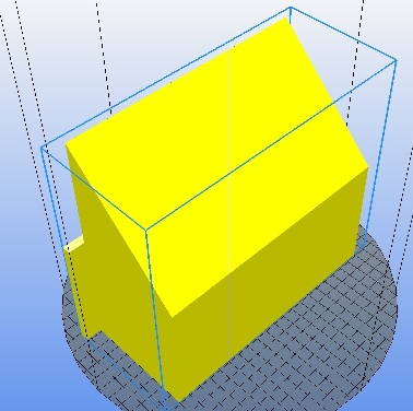

I printed an hour's worth of material as a starter/learning tool. I'll show the pics then ask questions at the bottom:

This will be a (rectangular) "box" about three inches tall, with an additional three inch (tall) 45 degree sloped "roof":
example 2.jpg (43.11 KiB) Viewed 13271 times
The two problems I encountered were the obvious de-lamination, and that the glue came unstuck on one corner of the print. That corner curled up slightly (about 1/4") but the printer just kept chugging along as though everything was as it was meant to be.
Q1: How to I get rid of the de-lamination problem? Here's my ABS default setup in MatterControl:

That's a difficult object to print in ABS, sharp outside corners are the worst case for warping both warping things off the bed and delamination later in the print.
Pretty much all you can do outside of making sure everything about the printer is perfect is add Micky mouse ears (and probably a Brim) to the model (at lease 2 layers deep) and print hotter probably at least 240 (which is as high as I'd go with the stock hotend) and ideally hotter.

Mickey mouse ears are a way to fight the lifting of the corners from the bed. Big circles are added to the print near the base to enlarge the surface area at the bed. I find it to be quite a ridiculous technique. Turn up your bed temperature first, to like 110 minimum and see if that helps.

As i replied in your other post, it is like making a big skirt around the object except, because the corners are the worst part you make small flat circles around that. Which looks like mickey mouses ears.
And if when you do get lifting, the mickey mouse ears lift and hopefully the lifting does not happen or it does not reach your actual print.
Later you just cut them off.

The reason rounding corners helps is because it better distributes the warping forces as the plastic shrinks, with sharp outside corners, the forces are all applied directly to the corner. A Circle is the object least likely to warp off the bed, but even that will warp.
Mickey Mouse ears are circles added to sharp angles, both to increase surface area and remove the sharp corners where the warping is worst at the bottom of the print, there is an example with the Kossel mini motor mount here https://github.com/jcrocholl/kossel/blo ... _motor.stl though I would have places the center of the circle at the middle at the vertices.
Increasing the bed temperature will probably also help, but at some point you start to introduce other issues, notably elephant feet where the first 5-10mm of the print display a slight hour glass shape.
