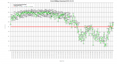

Needing proof that something was wrong, I found a way to prove that i am getting constant disconnects and horrible speeds, i would start logging my speed test results. Because i would need to gather as much data as possible, manually logging speed test results would be a horrible idea, i needed a scheduler that could do it for me all day and all night. but my computer is not always on, so writing a program on the machine wouldn't be the best solution either.
First I used a raspberry pi, but because of the 10/100 Ethernet port, i could easily tell by comparison with my PC that speeds were not equal while running the test one after another.
Upgraded to a ODROID C1+ and things seemed spot on, i forked a previously made speedtest CLI code i found on github, modified it as to enable logging, the cron'd some tasks including emailing me the results of a days speeds in a .csv file.
I then wrote a c# program to plot the info and save as a png so i could visually show these people the issues i am having. this PDF of last months results was sent to vivint for review.... wish me luck for some discounted Internets
