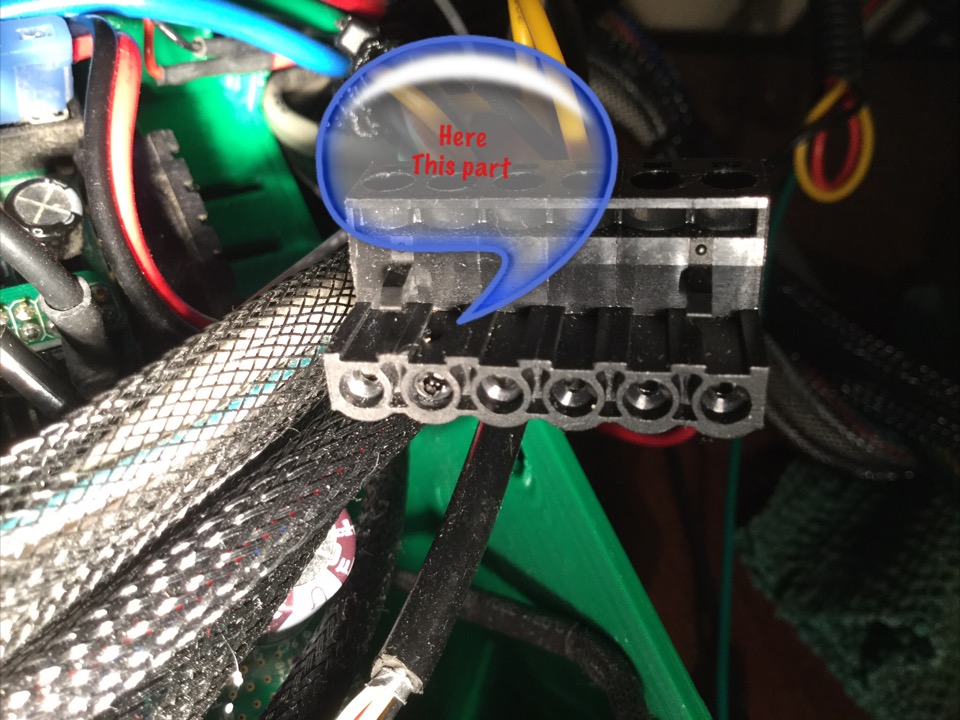

I could buy this item? It is the power in header on the side of the RamBo. It looks like it got a little toasty.

I'd email Ultimachine about it - if nothing else they can get you a part number you can use to order it from Mouser.
Re: Does anyone know where...
You can also send the card to Ultimachine for repair and the costs would be reasonable.
Thanks, the card is fine . Ultimachine has the header available on thier website. Wish I could find a supplier in Canada.

There's a BOM for the RAMBo on their github. I've replaced components on it (in Alaska) and they're all on Digikey/Mouser/etc, so shipping to Canada shouldn't be bad.
RAMBo github
The schematic pdf lists that as part MSTBA6, the BOM says that's: "6 pin fixed terminal block;Molex;39532-1006"
Mouser and Digikey both helpfully list the appropriate mating connector.
http://www.mouser.com/Search/ProductDet ... XWUw%3d%3d
http://www.digikey.com/product-detail/e ... ND/1280673
I'd double check to make sure that these are the correct parts, but looks like if that's all you fried, it'll be a cheap fix!
Wow, thanks for your effort in looking this up. I see digikey.ca has what I am looking for.
No problem. Thanks should go to Ultimaker for nicely documenting their work online.
Good luck with the repair!
