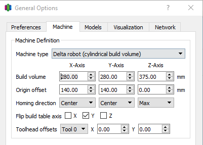

From my understanding S3D uses the largest square that fits inside your build envelope(circle). That's the reason the print area looks small in comparison.
In your Processes section edit your FFF settings: Under the g-code tab, to set the build volume to X-Axis 266, Y-Axis 266, With Origin Offset 133 for both.
Then uncheck the "Update Machine Definition" and "Update Firmware Configuration" to disable those options.
That will stop S3D from automatically adjusting your settings from the firmware on the printer. Now your build table should be appropriately sized and stay that way.

The X and Y axis figures of 266 will give a "diameter" of 266mm. The 133 X and & axis offset will put the zero point in the center of the bed.
When working with S3D, the X and Y axes are both set to the diameter of the printing volume and the X and Y offset are always half the diameter, regardless of what kind or size of delta printer you have.

Here's my current S3D settings:
s3d settings.png (10.54 KiB) Viewed 27216 times
