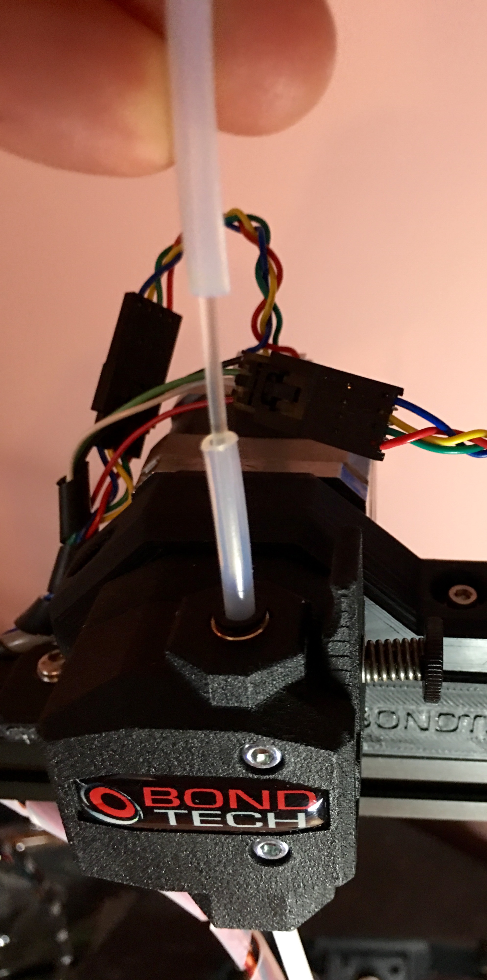

Here's a tip on setting up the filament infeed. The QRs have PTC couplers on the infeed side too so you can either connect a long tube over to your filament spool or do this:
This helps in several ways.
  1. it's easy to feed the filament in, you push it through the long tube from the spool to the end where you can grab it to push through the extruder and Bowden.
  2. during retracts, the top indeed tube lifts the amount of the retract so you get a visual indiction of retract.
  3. you could insert a little felt or other lint free pad (microfiber is what I use) in the space to have a filament wiping system to remove surface grunge. PLEASE DO NOT use this to add "canola oil". I will never post another tip if you do!
For the feed tube itself I use PTFE with a 3mm ID and 4mm OD. The larger bore minimizes friction and the thinner walls allow it to bend nicely from my filament spool to the extruder. I got mine at McMaster Carr.

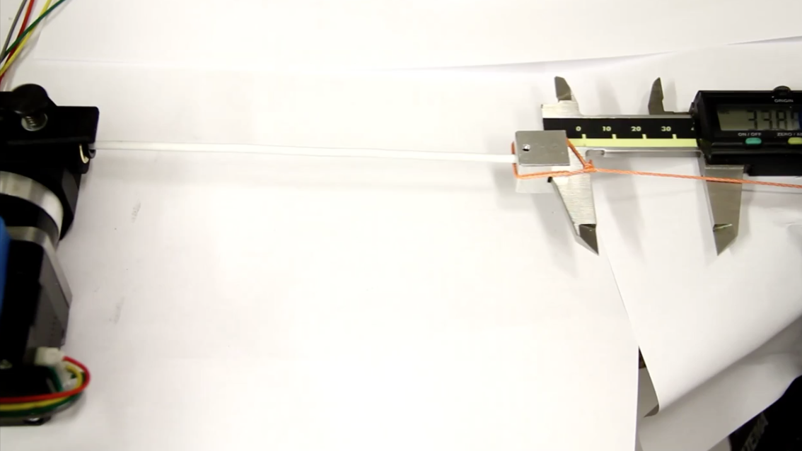

Martin rigged up a cool fixture and shot a video he shared with me to test the calibration and reproducibility. Here is a screenshot of the fixture. The cord is hooked to counterweight so the filament goes both ways. This is neat because it removes all human measurement error and it puts a little tension on the filament to keep it straight.
Martin measured some of his drive gears and they are all 11.35mm +/-0.02mm (measured at the top of the cobbled diameter). He is seeing 476.55 steps/mm for 1.75 PLA and 493.45 steps/mm for 3.0 PLA. He's seeing .01mm repeatability over 100mm.
I am going to create a similar fixture and test all 8 of mine. But some thoughts he passed on:
Make sure the drive gears are clear of any plastic debris.
Make sure the gear grooves are lined up perfectly. If the filament is not exactly in the valley, it can throw things off.
One thing to keep in mind is that 50 steps moves the filament .1mm. If you are not very precise and repeatable, even a .05mm variation would result in a variation of 25 steps/mm. The reason for measuring 100 mm of filament is to improve measurement and minimize errors but a little variation could creep in. I like Martin's fixture because it precisely measures the amount moved to the resolution of the calipers. I do not know how many different filaments and/or QRs he tested, I've asked for that.

From Martin: it was ABS he tested and only one extruded. He'll do more testing too b
