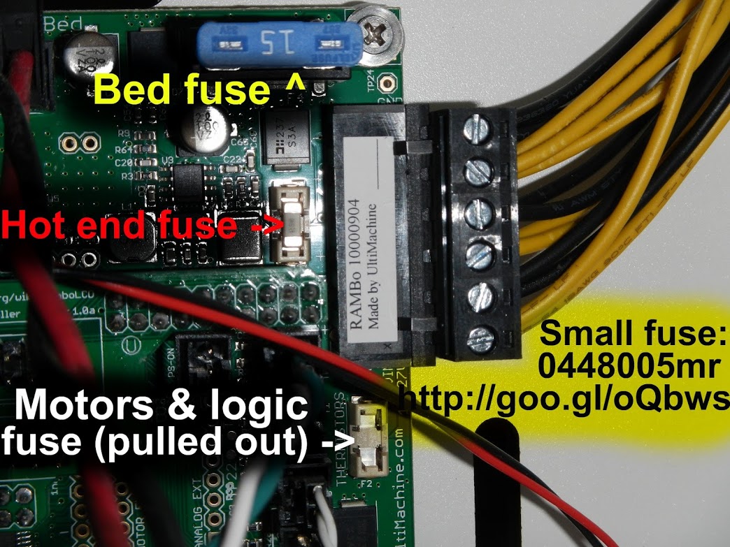

If none of the motors work, there's a wiring problem or you've got a blown fuse.

You need to have a multimeter or borrow one. Turn off the printer and unplug it.
You need to find the two small fuses as shown in this picture.
Carefully remove the two small fuses and measure their resistance, a good fuse should have 0 ohms, a blown fuse will show infinite ohms (an open condition)
If one of the fuses is blown it will have to be replaced. See this link for where to get the fuse. I recommend that you buy some spares.

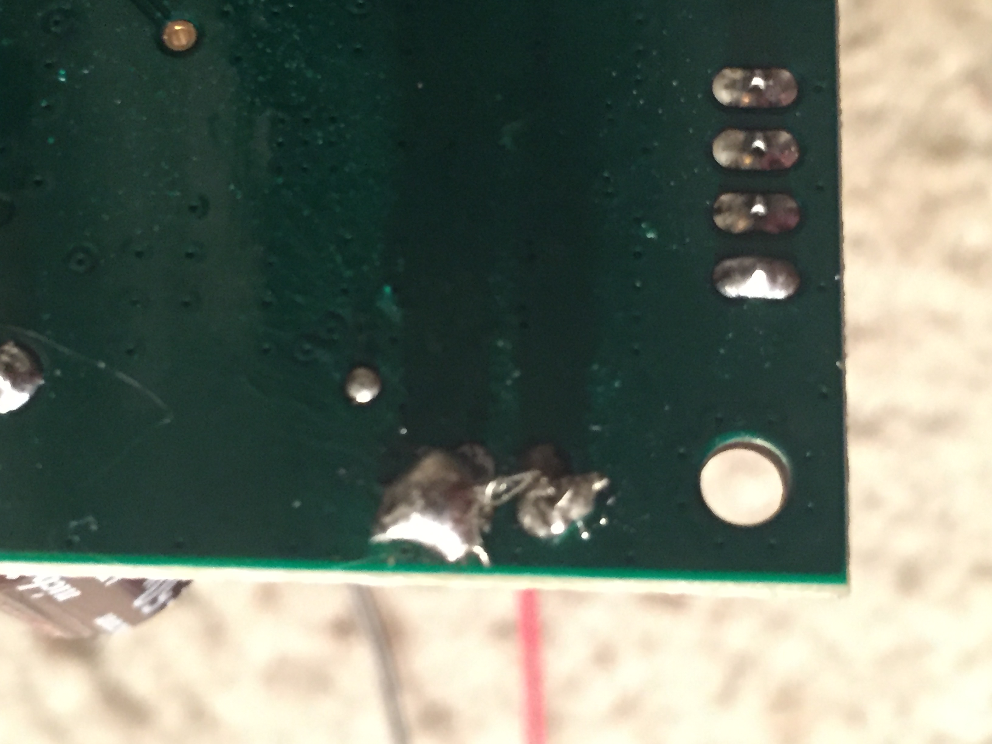

what could have blown the fuse? it looks like some solder on the rambo fan wires came loose and they were touching, could this be it? If not, i will need to find what it is so it doesnt blow more. Along with this, couldn't i simply switch the two fuses and retest it with the solder repaired?Eaglezsoar wrote:You need to have a multimeter or borrow one. Turn off the printer and unplug it.

This is the loose solder, I've got no idea how this mess passed over me but I'm suffering the consequences. Ive reheated the solder and redone it and they are now separate. Am I out of the woods, or no? Also, please dont kill me over the terrible (understatement) solder job, ive learned my lesson for lazy soldering.

If the LCD still lights, you're likely out of the woods there. Does it still show DEF for the temperatures? If so, recheck your wiring end to end, as well as the resistance of your thermistor.
You can likely swap it, but if the LCD was lighting, you haven't blown the logic fuse. I might suggest checking your connectors are facing the right way on the rambo, but I think they are biased (I haven't had the front off in a bit).

F2 protects the motor steppers, F3 protects MOSFETS for fans, hot ends and supplies logic. If the steppers are not running the most likely source is the F2 fuse. Since you changed fuses and the Logic shut down (no LCD, no RAMBO lights) the F2 fuse was bad. First step is to go over the connectors for ALL the motors (including extruder) at the RAMBO interface. Especially look for whiskers straying from the connectors. If there are any other splices of connectors downstream take a good look at those also. Looks also at connections like the fan connection to the board. THEN make sure the printer is powered down and replace the F2 fuse. Power up and if the motors now move the problem has moved another step towards the end goal. If the fuse opens there is still likely a wiring problem.kevo3 wrote:RESUTS!! just not neccesaritly the good kind... i turned on the printer and the lcd screen lit up as usual, fan in the back also on, all is dandy despite not being usuable... so i power it down/ unplug it and pull out f3 and f2 fuses and switch them out,and turn it on,the fan comes on, but as far as the lcd goes, nothing. I of courrse have a mini heart attack thinking ive killed the board, gather my self, reverse my actions and retry with the fuses back in place. Turned on the printer with fingers crossed and tadaa, lcd screen on. I believe you had mistaken which fuse did what, as i think the f2 fuse controls/regulates only the motors....The down side? after i switched fuses the first time the printer would not connect, so i could not test the motors. eh, at least its obvious f2 is dead, so now i just gotta order another... and some extras...
Good luck and keep spare fuses! Also buy a cheap VOM.

Thank you for the advice, im glad it was simply a fuse instead of a seriously important(irreplaceable) part. IM not sure if you saw but i had a bit of solder come loose on the rambo fans wires, and they were essentially hugging eatchother, could this be the source of my sorrows? or is this fan not connected to f2 at all? either way i fixed it but if thats not connected, then im in for a long night of looking at wires for cross connections.nitewatchman wrote:F2 protects the motor steppers, F3 protects MOSFETS for fans, hot ends and supplies logic. If the steppers are not running the most likely source is the F2 fuse. Since you changed fuses and the Logic shut down (no LCD, no RAMBO lights) the F2 fuse was bad. First step is to go over the connectors for ALL the motors (including extruder) at the RAMBO interface. Especially look for whiskers straying from the connectors. If there are any other splices of connectors downstream take a good look at those also. Looks also at connections like the fan connection to the board. THEN make sure the printer is powered down and replace the F2 fuse. Power up and if the motors now move the problem has moved another step towards the end goal. If the fuse opens there is still likely a wiring problem.kevo3 wrote:RESUTS!! just not neccesaritly the good kind... i turned on the printer and the lcd screen lit up as usual, fan in the back also on, all is dandy despite not being usuable... so i power it down/ unplug it and pull out f3 and f2 fuses and switch them out,and turn it on,the fan comes on, but as far as the lcd goes, nothing. I of courrse have a mini heart attack thinking ive killed the board, gather my self, reverse my actions and retry with the fuses back in place. Turned on the printer with fingers crossed and tadaa, lcd screen on. I believe you had mistaken which fuse did what, as i think the f2 fuse controls/regulates only the motors....The down side? after i switched fuses the first time the printer would not connect, so i could not test the motors. eh, at least its obvious f2 is dead, so now i just gotta order another... and some extras...

I saw that and suspect that this was likely the issue. I don't know specifically where the voltage to the fan is sourced from but it would make sense that F3 would protect it. Suggested being anal about the wiring because my recent short in the F3 kingdom took several hours and five fuses to resolve.kevo3 wrote:Thank you for the advice, im glad it was simply a fuse instead of a seriously important(irreplaceable) part. IM not sure if you saw but i had a bit of solder come loose on the rambo fans wires, and they were essentially hugging eatchother, could this be the source of my sorrows? or is this fan not connected to f2 at all? either way i fixed it but if thats not connected, then im in for a long night of looking at wires for cross connections.nitewatchman wrote:F2 protects the motor steppers, F3 protects MOSFETS for fans, hot ends and supplies logic. If the steppers are not running the most likely source is the F2 fuse. Since you changed fuses and the Logic shut down (no LCD, no RAMBO lights) the F2 fuse was bad. First step is to go over the connectors for ALL the motors (including extruder) at the RAMBO interface. Especially look for whiskers straying from the connectors. If there are any other splices of connectors downstream take a good look at those also. Looks also at connections like the fan connection to the board. THEN make sure the printer is powered down and replace the F2 fuse. Power up and if the motors now move the problem has moved another step towards the end goal. If the fuse opens there is still likely a wiring problem.kevo3 wrote:RESUTS!! just not neccesaritly the good kind... i turned on the printer and the lcd screen lit up as usual, fan in the back also on, all is dandy despite not being usuable... so i power it down/ unplug it and pull out f3 and f2 fuses and switch them out,and turn it on,the fan comes on, but as far as the lcd goes, nothing. I of courrse have a mini heart attack thinking ive killed the board, gather my self, reverse my actions and retry with the fuses back in place. Turned on the printer with fingers crossed and tadaa, lcd screen on. I believe you had mistaken which fuse did what, as i think the f2 fuse controls/regulates only the motors....The down side? after i switched fuses the first time the printer would not connect, so i could not test the motors. eh, at least its obvious f2 is dead, so now i just gotta order another... and some extras...
