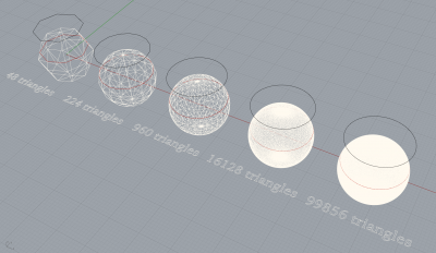

Other firmwares are interpolating movements into short line segments so, in theory, it has an affect on print quality. There are other factors at play too though - hence the reason for "in theory". By it's very nature, 3D printing starting with an STL file is going to sacrifice some resolution depending on how the CAD model was converted into an STL (most profound is the # of triangles in the final model). Here is an example of how this works...
Imagine you have a CAD drawing of a 20mm diameter sphere. The CAD tool uses sophisticated math to calculate the geometry and display it. It looks like a perfect sphere on screen. Now, let's run that perfect sphere through the meshing process to create an STL version. To demonstrate I am using 5 different resolutions that generate a low number of triangles to a high number of triangles. When you download an STL from Thingiverse, you have no control over this, the original author made the resolution choice for you. And frankly, most of the folks uploading to the shared services really don't know what they are doing. Anyway, back to the example - here I've meshed to create a "sphere" with 48, 224, 960, 16128 and 99856 triangles (from left to right). You can see that the far left sphere is course and the one on the far right is reasonably smooth.
Now to take this one step further, imagine your slicer creating gcode from these STL models. I created an imaginary slicing plane at 12mm above the base that is .02mm thick and took a cross section of the model at that plane. This is the red line you see inside each model. I projected these slices up above the models so you can see them clearer (black). The 48 triangle model has a slice with 8 sides - pretty low resolution. You can see as you move left to right, each slice has more line segments. These will result in a finer/higher resolution print all things being equal. But they are not! In addition to the slicer converting curves into short line segments, the firmware also imposes its own line segment on top of that - that is all of them EXCEPT dc42 RepRapFirmware. dc42 draws each point along the way completely tracing the original path it was given. Smoothie, Repetier, Marlin and the others actually break the path up into short line segments and draw those. This does not always match the original path exactly.
As you can see, if the STL had a low triangle count, you are going to get a course print. Increasing the triangle count will improve the print quality until you reach the segmentation threshold of the firmware, at which point, increased # of triangles won't have an effect and might actually make things worse. That is except dc42, which will faithfully trace each of the tiny line segments exactly point by point.

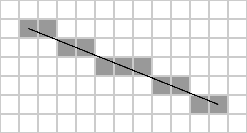

mhackney wrote:1) its delta motion control calculates EVERY point of movement, not short line segments like all the others do
I was actually thinking about porting the Duet-dc42 positioning algorithm over to Smoothie, but after I compared the two parts side by side, I didn't think it was worth the effort. This image describes Bresenham's line drawing algorithm, which is used to render diagonal lines on displays that can only perfectly produce orthogonal (perfectly right-left or up-down) lines:
3D printers have exactly the same problem. The steppers can only be at discrete positions, so any improvement in position generation beyond that point gets eaten. Similarly, the filament diameter never stays exactly the same, and there is also die swell to consider.
I've held a part printed with my Smoothieboard next to a part printed with my Duet. There is zero visible difference. Smoothie is generating segments 200x/sec. Even if I printed at 100mm/sec (and acceleration limits let it get up to that speed), it would still be generating segs once every 500 microns, and those will have only a small amount of error. Judging by the identical print quality, I would say that error is either being hidden by stepper resolution (which is 0.9 degrees on my printer), smoothed over by the molten plastic, or that it's so tiny as to be invisible to my eyes. The Duet produced no fewer Bresenham artifacts than the Smoothieboard. Top surfaces still have the same familiar "slightly bumpy" feel.
If someone can show me a side-by-side photo of something printed with Duet-dc42, and then the exact same object printed with Smoothie, and there is a genuine difference that I don't need a 400 power microscope to see, I will reconsider porting dc42's method over to Smoothie.
Also, the Smoothieboard is over 30MHz faster than the Duet. The Duet still wins on RAM (96K vs 64K). I'm currently working on my Smoothie fork, and will be reducing RAM usage if I can.
The two things I miss the most about the Duet are the web interface, and the PanelDue. Someone is working on getting Smoothie to work with the PanelDue. The web interface, however, is awfully disappointing compared to the Duet. It seems like someone hacked it together in a weekend and hasn't touched it since. That will take longer to fix, and I probably won't be the one to do it.
