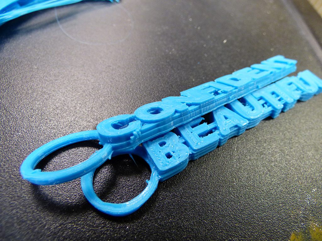

Actually, we're having a number of issues, and since they may be related, I'll try to describe them all. First, the extruder seems to shift part way through most prints. Sometimes this happens after the first couple layers, and sometimes part way through. On at least one print, there were two cases where there appears to be two slight shifts on one side of the model, but they do not appear on the other side! This can be seen in the photos of the model that is the word "CONFIDENT" (a project for some elementary school students). Some of the other photos show similar issues with other prints. This has happened a lot over the past 20 prints or so.
The second problem can be seen in the photo of the bottom of the print of the word "BEAUTIFUL." We get this a lot and have for quite some time now. There does not seem to be good bonding between rows of filament laid down on the first layer. This is exacerbated when on the inside of a large-radius curve. It seems as if the outside shell is shrinking before the next strand has a chance to bond with it, leaving a gap. There are often gaps in the filament on the first layer and these then are repeated in subsequent layers.
There seems to be an inordinate amount of excess filament strands, at least compared to other 3D printers I have used. This seems to have gotten a lot worse over the past few months.
There are two photos of a failed print, with one taken from the side with which I have attempted to show how the print both shifted and started printing with the Z axis at a slight angle, resulting in a wedge-shaped print. The photo of the objects on the printer bed is intended to show the extra shells that we are getting, often on the first layer, but sometimes continuing up quite a ways, like some type of cancerous growth or birth defect in a human. We had been having problems with the pins that connect the support arms to the extruder walking out of the universals, but this did not happen during any of these prints. I have adjusted the Z-axis and leveled the bed as best I can, to the point where on part of the bed at least, the extruder is so close that the filament doesn't come out on the first layer. It is very difficult to get the first layer completely flat with this printer. I have noticed that sometimes it seems that the filament stops feeding, part way through a print. I have tried adjusting the belts on the towers, and making sure that nothing has come loose. Quite frankly, I am skeptical of the very design of this printer, as there doesn't seem to be enough precision designed into its components to support a scheme that requires such accuracy as is required when tiny changes are amplified in the position of the extruder. This, however, does not explain the big shifts that are ruining many of our prints.
I've used enough 3D printers to have quite low expectations for these entry-level extrusion machines, but our success rate on this machine has gone from mediocre to abysmal.
