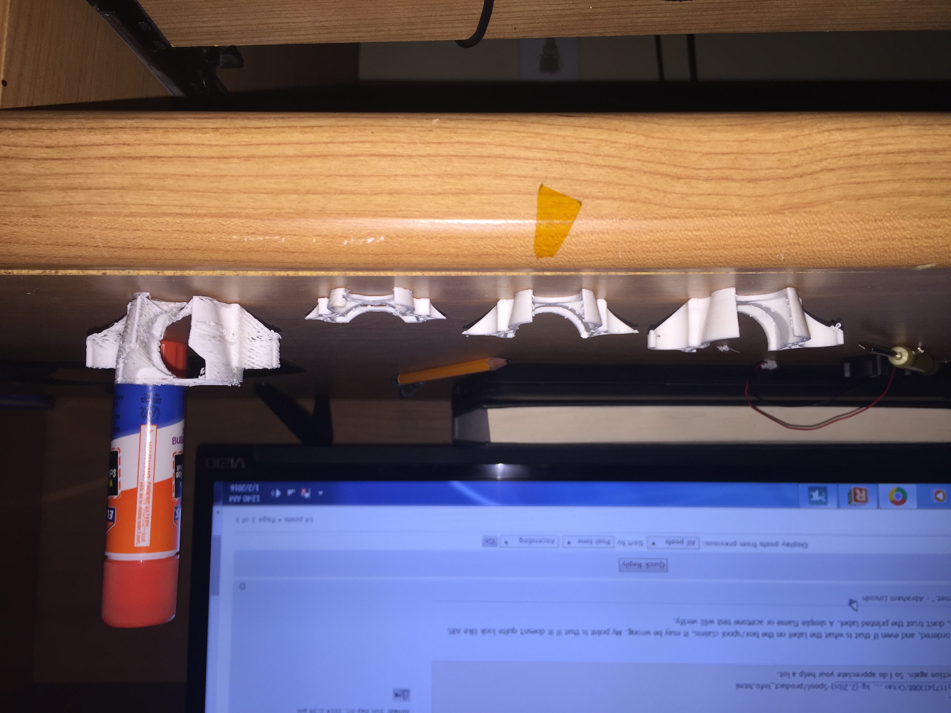

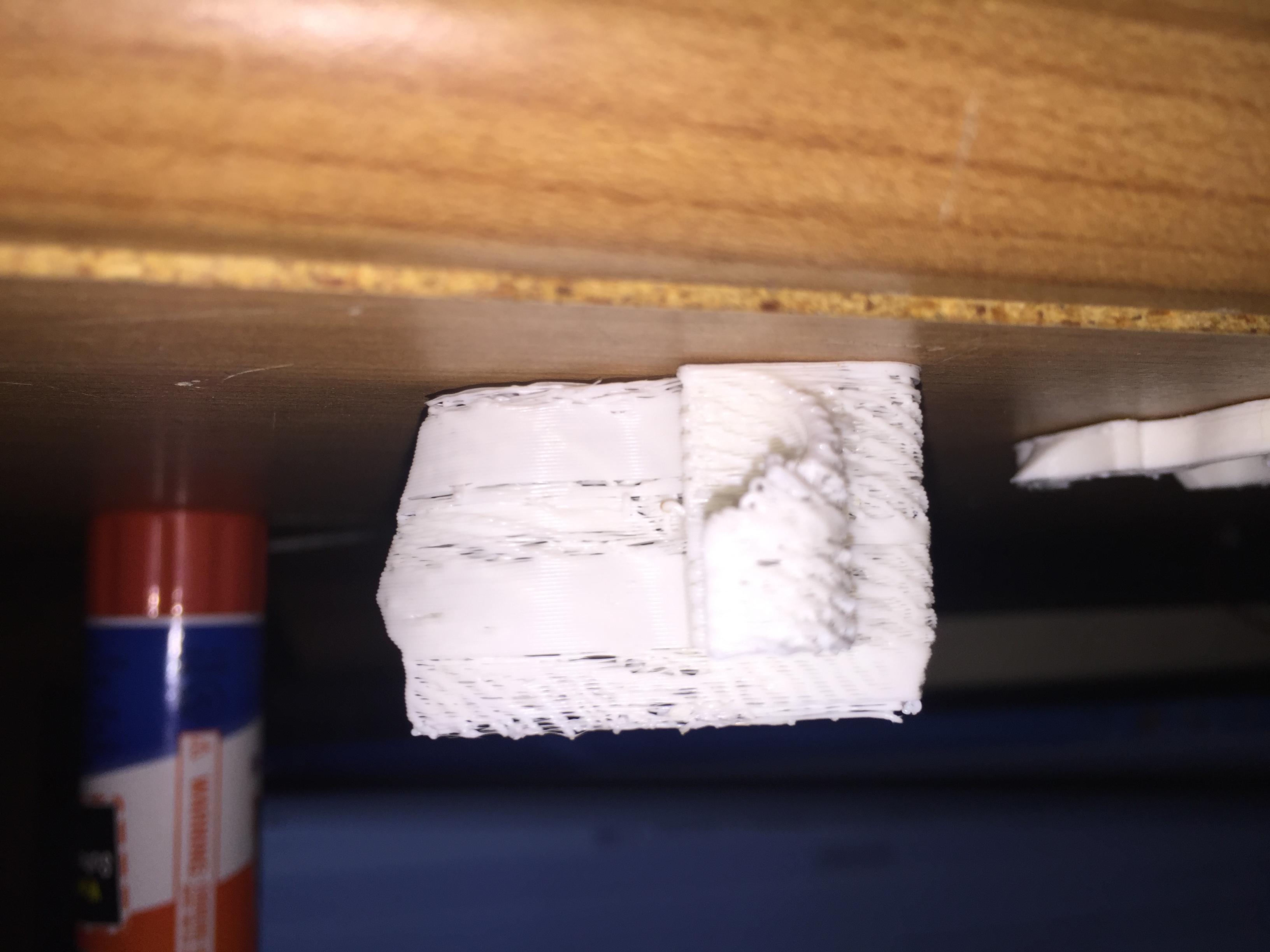

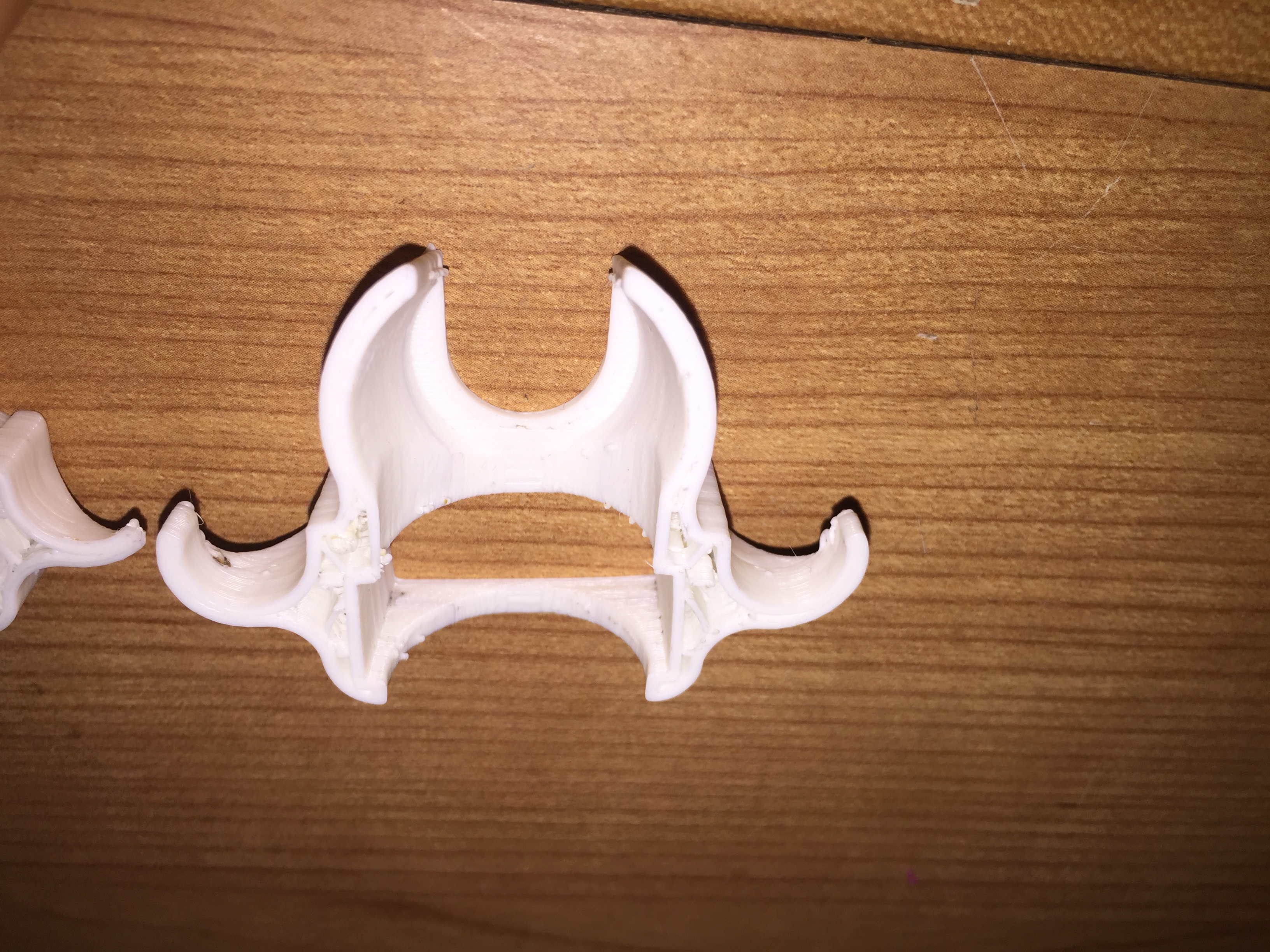

Well, we've "solved" the problem, kinda. I managed to connect them long enough to upload the gcode. And I went straight to printing, but, the quality of this one is absolutely atrocious. The first three attempts that got cut short came out amazingly smooth and strong. The last attempt came out brittle and with a weird pattern running through it where barely any filliment came out. Check pics below.

Ive found out what as causing the brittle failure. Slic3r kept thinking i was using 3mm filiment, so it sliced it that way, leading to the large gaps in the peice. Ive found a way around all the problems so far, so while not solved, the issue has been avoided. Using repetier, i just download the g code to the sd through the printer, since i dont have a SD to USB adapter, and print it from there, since the connection will eventually time out. I have enough time to download the file but not enough to print from the computer.
