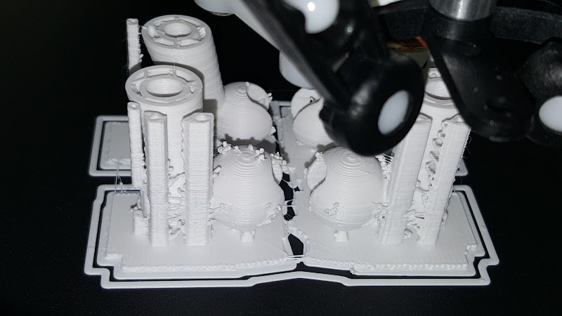

What causes the little boogers on the sides of prints? This is Microcenter Inland White ABS, extruder temp is 210C.
[img]https://lh3.googleusercontent.com/-31kt ... 121552.jpg[/img]

Boogers are formed at end point retractions. Commonly people try to manipulate the retraction and retraction rate to control, this especially if there is stringing associated with the move. But in some cases the problem has already occurred by the time the retraction has been applied.
This is results from pressure in the Bowden tube caused by "pushing the rope". Even though the extruder stops at the end of the move. the pressure in the tube keeps putting material through the nozzle. The retraction helps by pulling back the filament to lower the pressure, but I think the damage is already done.
This is where "Coast" comes into play. The coast parameter stops the filament feed at some distance, set in the slicer program, and allows the residual pressure to supply filament for the remainder of the move bleeding the pressure to a much lower value. Too much coast and there is a gap at the end of the path, too much and there is a blob or booger. FOR ME, this has the greatest effect on "boogers".
For example with an E3Dv6 Hot End, a BondTech Extruder and ABS (substitute PLA by lowering the temperature), I run the following parameters.
Temperature - 230-235C
Bed - 100C
Traverse - 250mm/sec
Print 75-125mm/sec
Outside perimeters - 60%
Retraction - 4mm
Retraction velocity - 15mm/sec
Extra Restart - 0mm
Coast - 1.25mm
Retraction Vertical Lift - 0.5mm
With the E3Dv6, I run 4mm with all filaments, PLA included. Jamming is only a problem when a rat pellet pulls off the end of the filament during filament changes. Then it is remove the nozzle, pull the PTFE Tube and push the dropping out the top of the hotend. I don't get retraction related jams.
