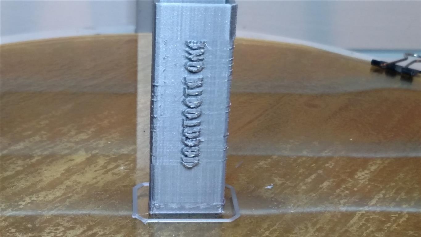

Any ideas what could be causing this one? White Inland ABS, sides are smooth enough to almost not feel the layers at the top and bottom, but in the middle where the text is, it's really rough.

It's possible that you are overextruding. Have you calibrated your EZstruder?
What slicer and what are your retract and retract speed settings. Is this the
SeeMeCNC hotend and what is the nozzle size?

Re: Kinda odd.
Yes, Steps per mm could be off. Also the extruder could be skipping when doing retracts.
What's your print speed? travel? retraction speed and amount?
Did you measure the diameter of your filament?

Re: Kinda odd.
Stock hotend. .5mm diameter. Measured the filament and it's averaging 1.72mm. Running MatterControl, with matterslice.
Retraction speed is 110mm/s,
retraction is 6.8mm,
speeds for infill is 40mm/s,
inside perimeters 40mm/s,
outside perimeters 35mm/s,
travel speed is 300mm/s,
first layer speed is 12mm/s.

Re: Kinda odd.
Try a retraction of 2 and a retraction speed of 30.
And make sure that the EZstruder has been calibrated.

Re: Kinda odd.
Okay, made the change, going to print out a pyramid to see if it helped. Pulled the bowden and flushed the filament to the end of the extruder, told it to spit out 100mm, checked with calipers, and it's 100mm, so that's good!

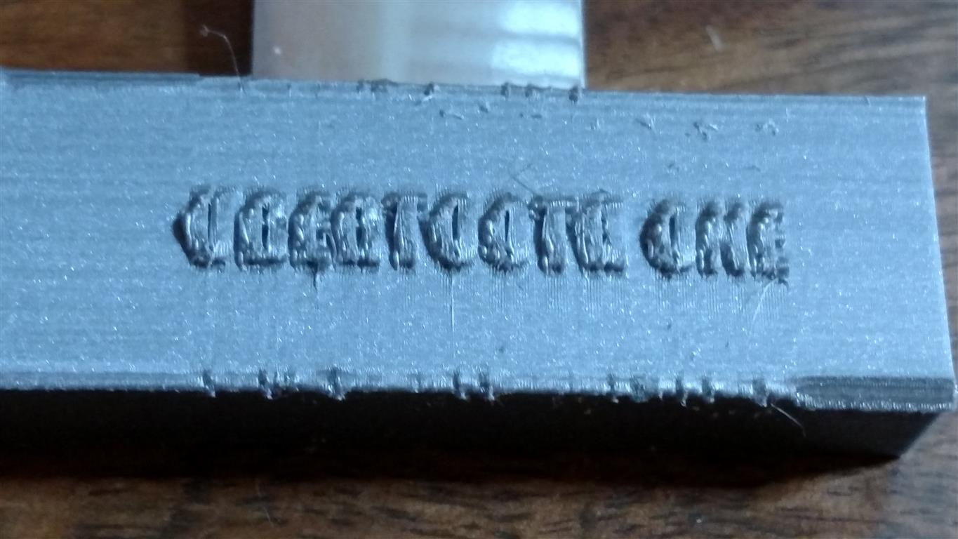

Also just printed out a different part, it gets all janky at the sameish layer height. Bed was the usb side of the ubertooth case, and flat side of the mount. Heh, so the top of the photo...

Re: Kinda odd.
Calibration pyramid is done. .2mm layer height. Same settings as above, but changed the settings Eagle mentioned. Still some barnacles on it, but it didn't go all fuzzy at the layer the other prints did. I'm reprinting the mount again, it prints faster than the usb adapter case. We'll see if it freaks out again.

Re: Kinda odd.
If you have changed your retraction to 2 with a speed of 30 and still get those artifacts, try a different slicer and try again.

Re: Kinda odd.
Have you looked at your coast values (assuming your slicer has that ability)? These could and likely are being formed before the retract ever occurs especially since diddling the retract doesn't drastically change them.

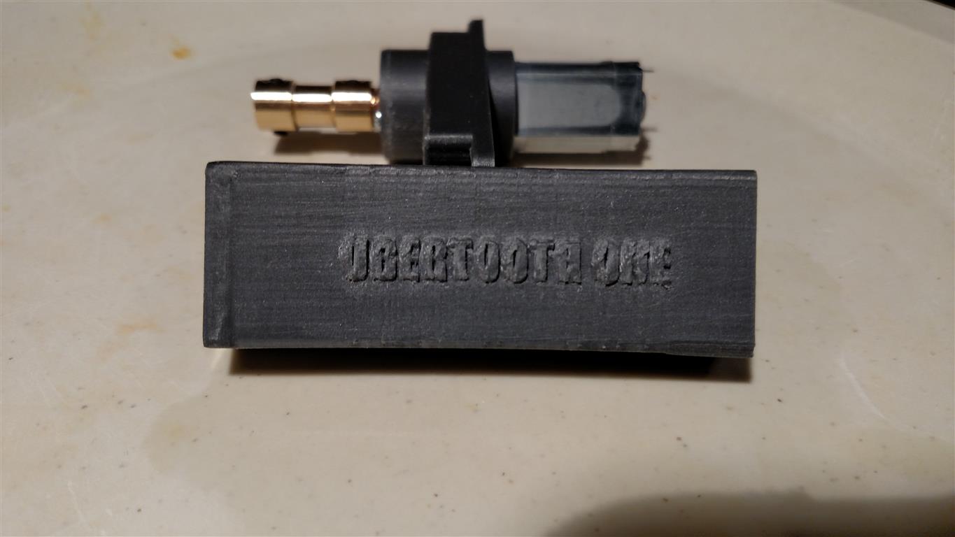

I think my printer just doesn't like the overhangs. Here's another large print in progress, and it's printing great.

Re: Kinda odd.
Printed the "thang" using HatchBox Silver ABS. Sliced with S3D, bed 100C, nozzle 220C, layer fans 65%, retract 3mm, retract speed 15mm/sec, coast 1.25mm, rapid 250mm/sec, print 80mm/sec. Initially have some "lice" on the print in the text area are but this rubbed off with a finger and a wire brush.
Text is a little funky but it appear that the sides are 90 degrees to the surface, could be helped significantly if there were a slight angle. Also would have done better with text definition using a narrower layer width (printed at 0.1mm high 0.4mm wide).

Re: Kinda odd.
The S3D code is there when you look at the line by line code. The problem is that the first edge of the letter is at a 90 degree overhang and is just thrown out there like a bridged layer.
